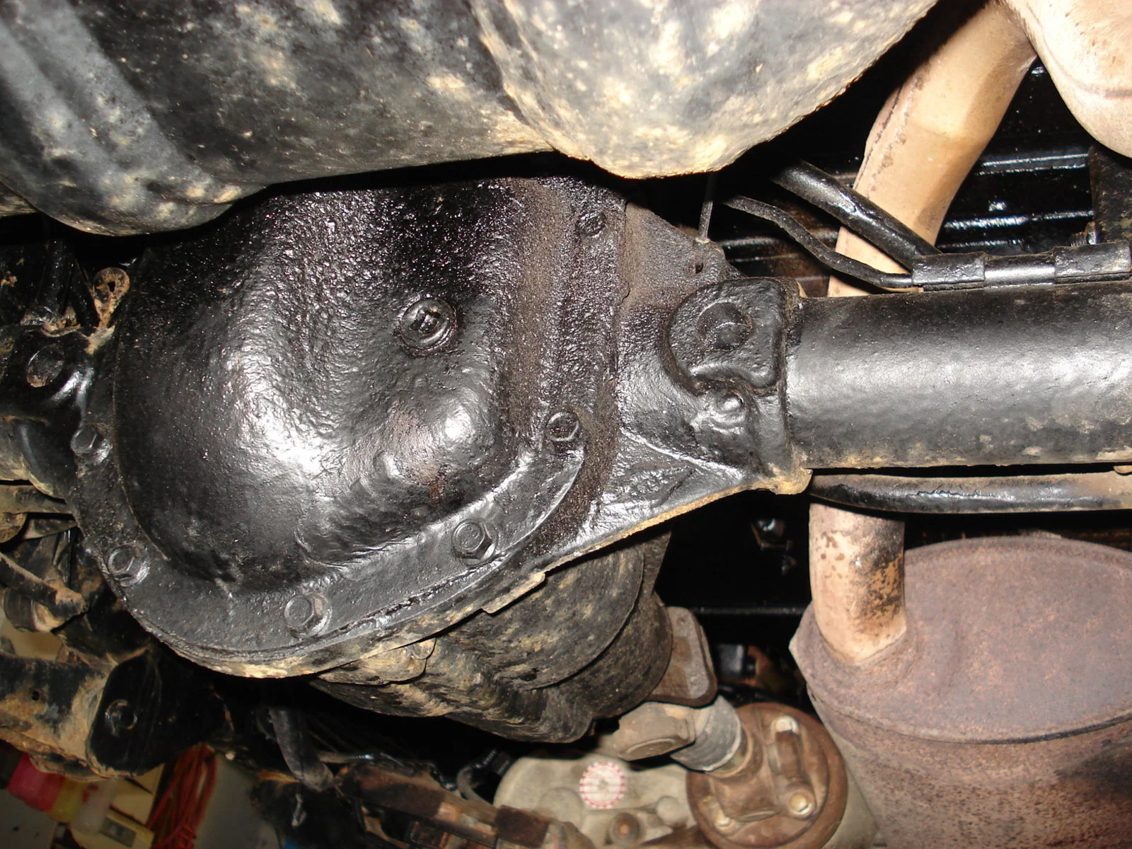

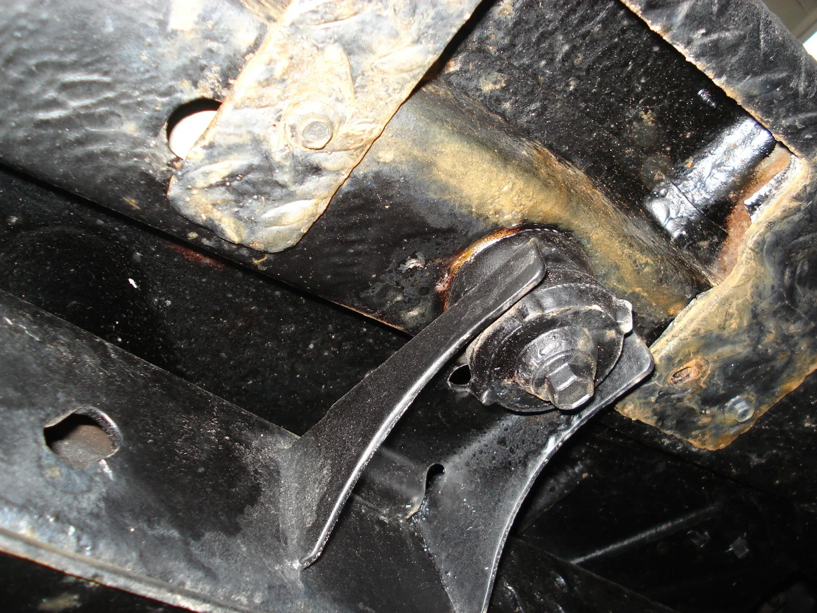

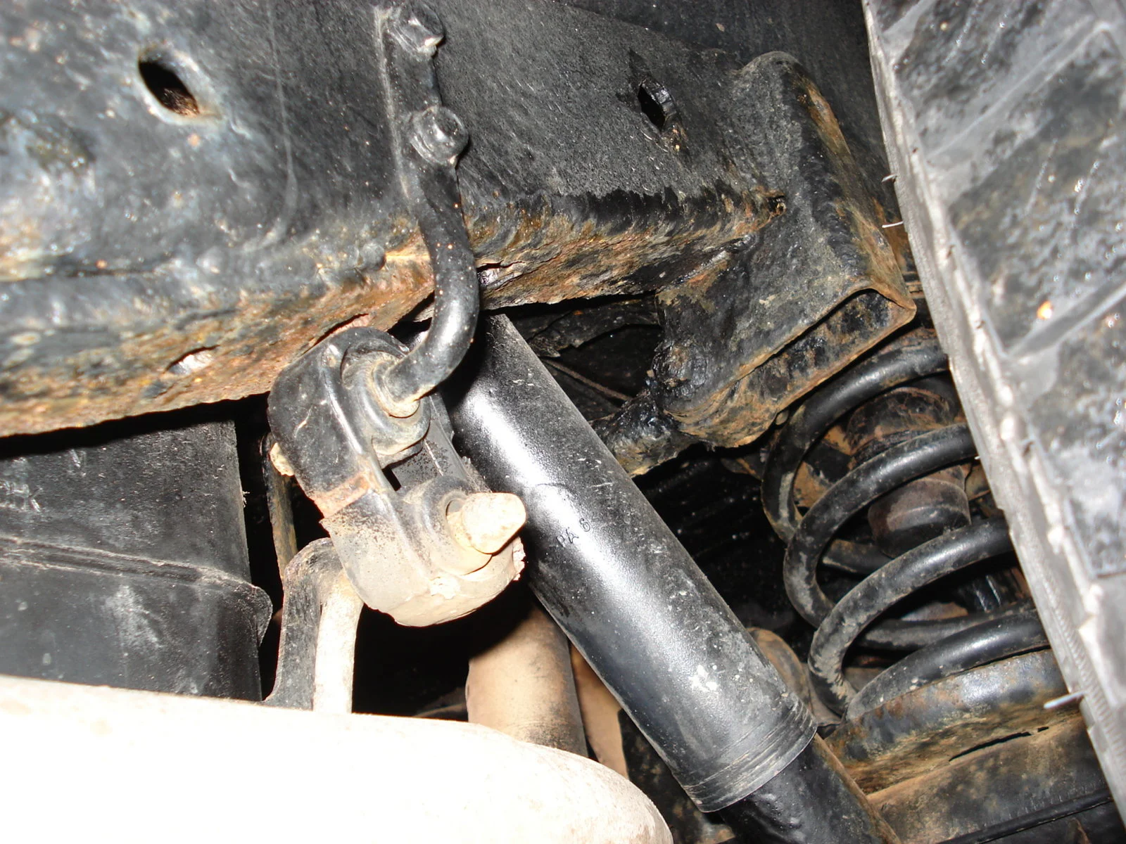

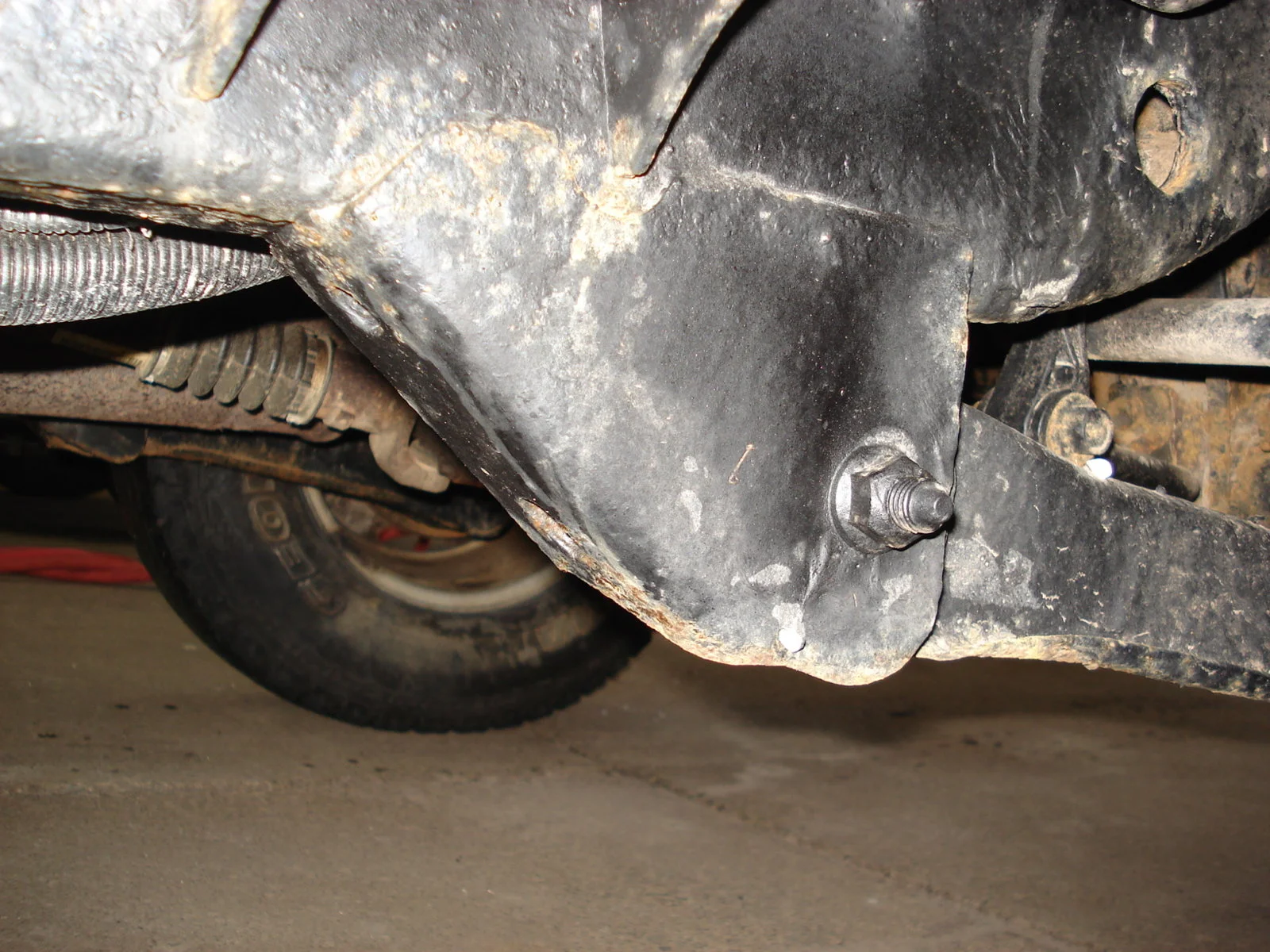

So, I finally got a few frame pics of the Rubi and she is def not rustfree...thoughts are much appreciated!

Looks not good. Looks like someone tried to paint over rust with rocker guard. Inside the frame is still the most telling but from those pictures I'd be debating with myself if it's worth even a couple hour drive to check out. The price would have to be REALLY good.

Here is what I see and know based on my current experience fixing a rusty jeep. The first pic of the torque box / body mount is a potential landmine. These also rust from the inside out and the slight bulge evident in the pic is a tell-tale sign. They may be solid today but guaranteed they will need attention if you plan on keeping it for any length of time. I would ask for pics of middle and rear mounts for both sides of the vehicle AND pics of the frame-side of these mounts. Two repair options- replace the full torque box or have rust cut out and shorter c-channel patches welded in. Obviously the first is the preferred method. Both are labor intensive but not necessarily hard for a typical shop. This would easily drop the price a couple grand for me. The pic with the muffler hanger is also a potential issue. I am at work and going from memory, but I do not recall a welded plate under my frame in that area and it looks like there is one in that pic. Sure sign of a crappy frame repair if someone randomly welded steel under that portion of the frame. It likely means that portion rusted through and that is how they 'fixed' it. If that is the case, that would also be another couple grand. There are also aftermarket frame caps that can be professionally welded in but remember that this type of repair, even if done properly, will reduce the value of the Jeep, particularly a Rubicon. Again, just my opinion, but unless I was getting it for under $10k, I would walk. If you can afford $15K, it sounds like from others more knowledgeable that there are much better ones to be found.
Stay far away from that. There’s so much rust lurking under the surface there, it simply isn’t worth it.
Agreed. Frames are definitely tough to deal with. I paid considerably less for mine, but the frame is solid and new floor pans are cheap. I would have to get a really sweet deal on that one because it could easily need $5k in repairs unless he can do it himself.
No way is that bit of plate on my LJ, nor do I recall seeing it on any friend's tj unless it's part of a bumper bracket, but then why is it welded.
