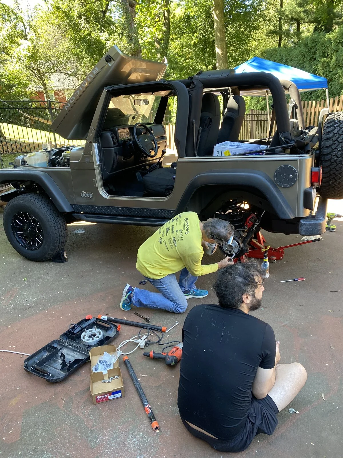

That was 6 weeks ago. Since then, the Jeep has become a gathering point for my dad, my brother, and me on a weekly basis, spending every Saturday figuring out what needs to be fixed and how to fix it, breaking things just so we can fix them, and watching youtube videos about how to fix things. Our collective toolbox has expanded as we take on new and different projects on the Jeep and plan for future aspirational projects. So far, we've worked on:
  • new rotors, pads, and calipers at all four corners. Turns out you can put calipers on upside-down 😒

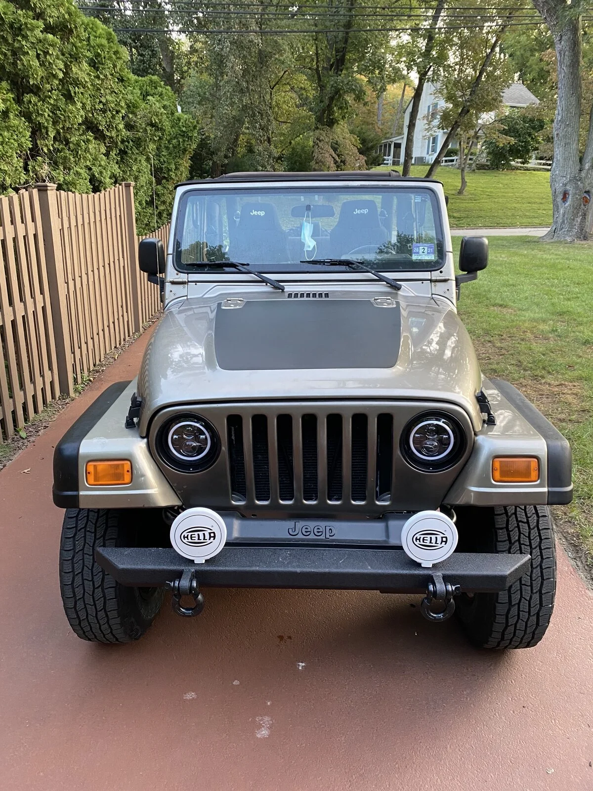

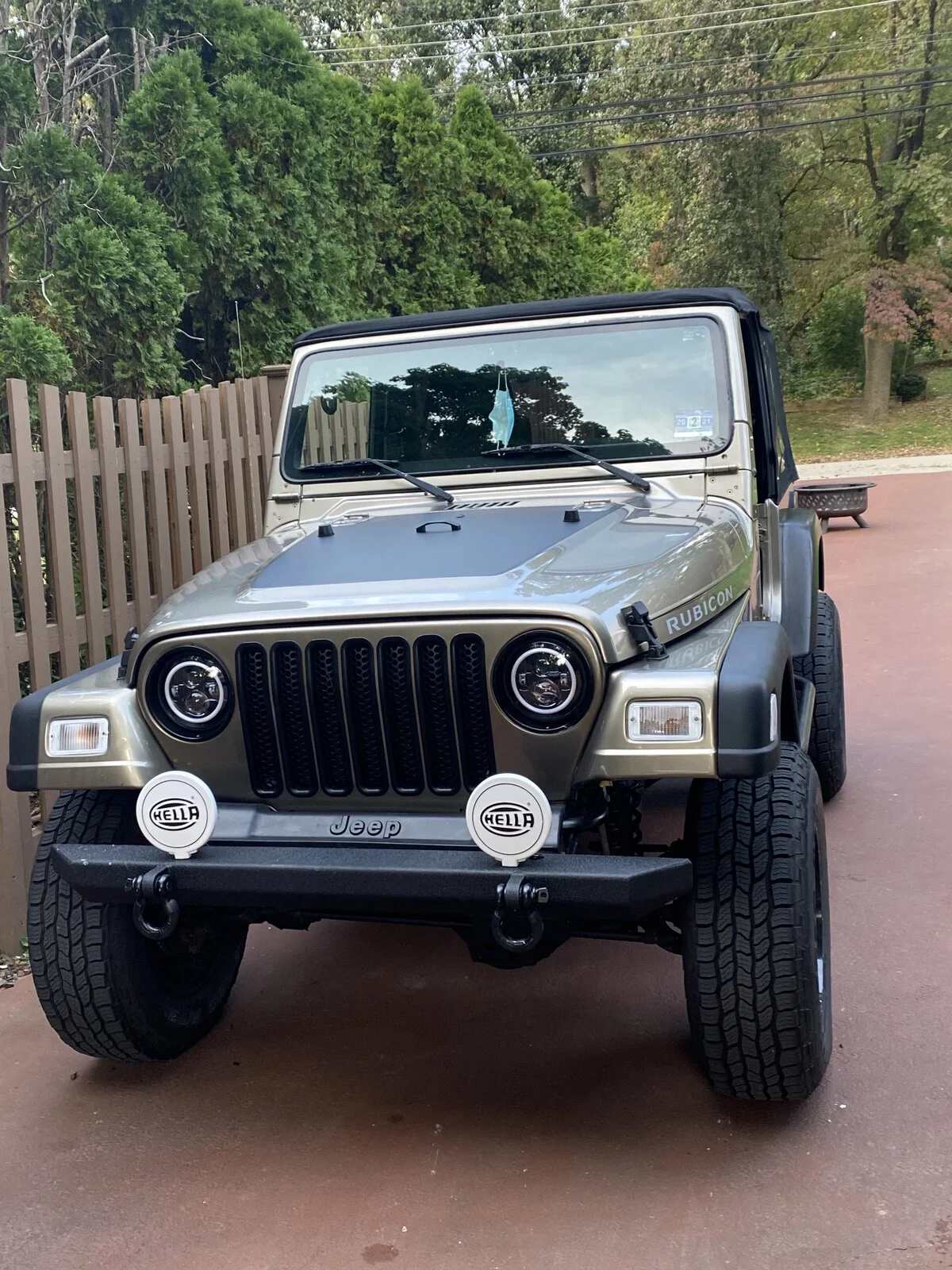

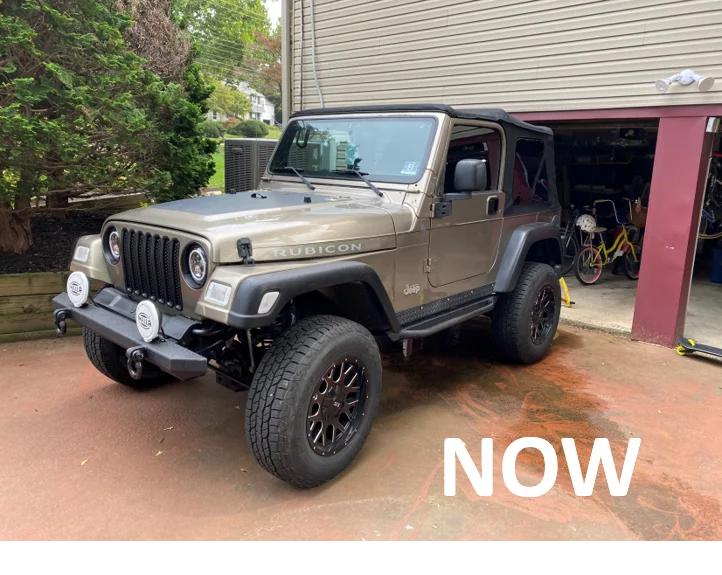

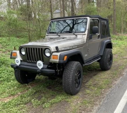

  • Full wash, polish, and wax. Makes a huge difference, she looks awesome (see pics) and I didn't realize how "sparkly" the Metallic Khaki color is :)
  • Plastidip! I'm going nuts with this stuff: I've already done the front fenders and the side view mirrors, this weekend's going to be the rear fenders and maybe the rear bumper. $5 a spray can makes a huge difference aesthetically

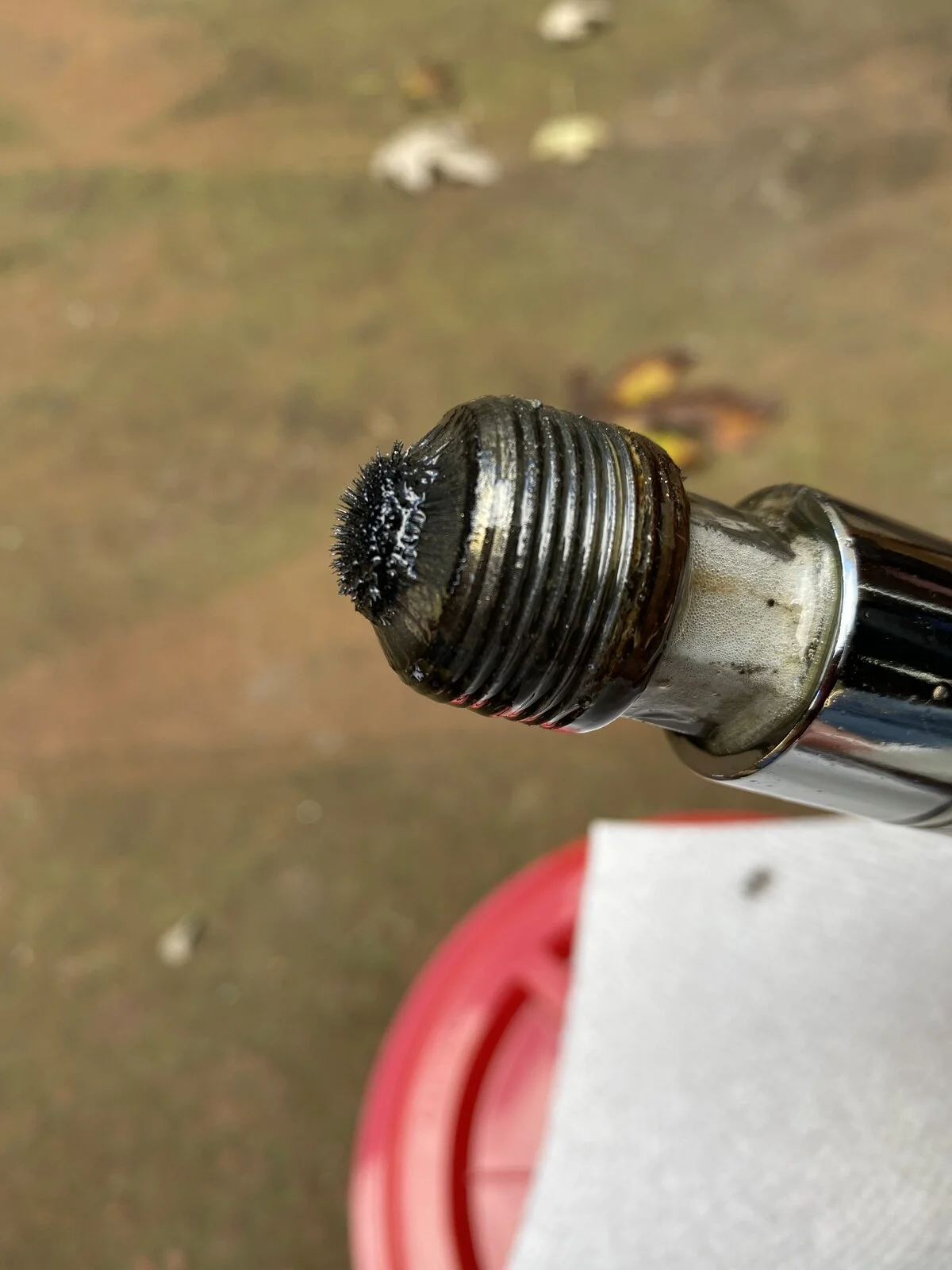

Transmission Fluid: The Jeep's been grinding on the 1-2 shift once warm, and increasingly doing so during other upshifts. After some research, I learned two things that might help the tranny (5 spd manual on a 4.0): I could replace the synchros or replace the transmission fluid. Naturally, I opted for the latter. I read through this site and identified the most recommended fluid for the NV3550 (Redline MTL), got myself a 17mm hex bit (had to order online, no local hardware stores had one), and went to town. Start to finish, the whole thing probably took less than an hour (if you don't count my paranoid ass spraying the drain and fill plugs with 19 cans of PB Blaster just in case). Per online instructions, i removed the fill plug first to ensure that I could put more in before I drained it all, but from there, it was effortless. Based on the nearly black color of the old gear oil, i suspect this has not been done in some time, if ever, with 160,000 miles on the engine. the magnet on the plug has the little shavings that are to be expected, and other than 1 larger piece, nothing else noteworthy
It's noticeably smoother to shift now, it's incredible the difference. I may drive for a few hundred miles then change it again, just to get anything that's shaken loose out. I'm going to continue to research what I can do to enhance the driving/shifting experience (e.g., flush the clutch, adjust the shift linkage, etc.). I'm open to suggestions!

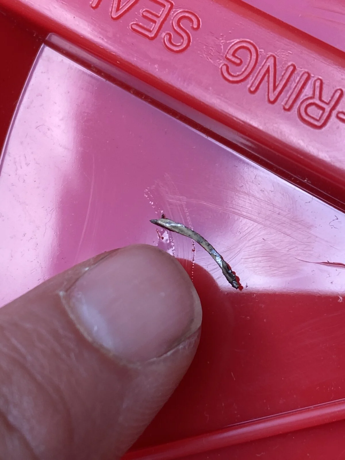

Windshield Chip
. When I bought the jeep, there was a chip in the windshield right at eye level that looked like it was just itching to spiderweb across the entire glass. So I got one of those repair kits from RainX. Long story short, I've seen great results online, but for me, it doesn't seem to have worked. Not sure why. Plus, the closer I put my nose to the windshield to inspect my repair, the more chips I found elsewhere - might just be time for a new windshield before I have to get her inspected.

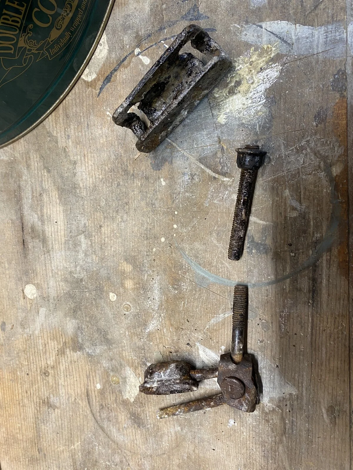

Parking Brake Adjustment. About a month ago I replaced rotors, calipers, and pads, including parking brake assemble. Now that the parking brake was broken in a bit, I wanted to adjust the cable since I still had to pull all the way up on the brake handle. It was pretty cruddy under there, so I hit with some PB and some rust dissolver. When I went to adjust it, this happened:IMG-0988.webp
Oops. Ordered a new one for $20 off amazon, should come today.

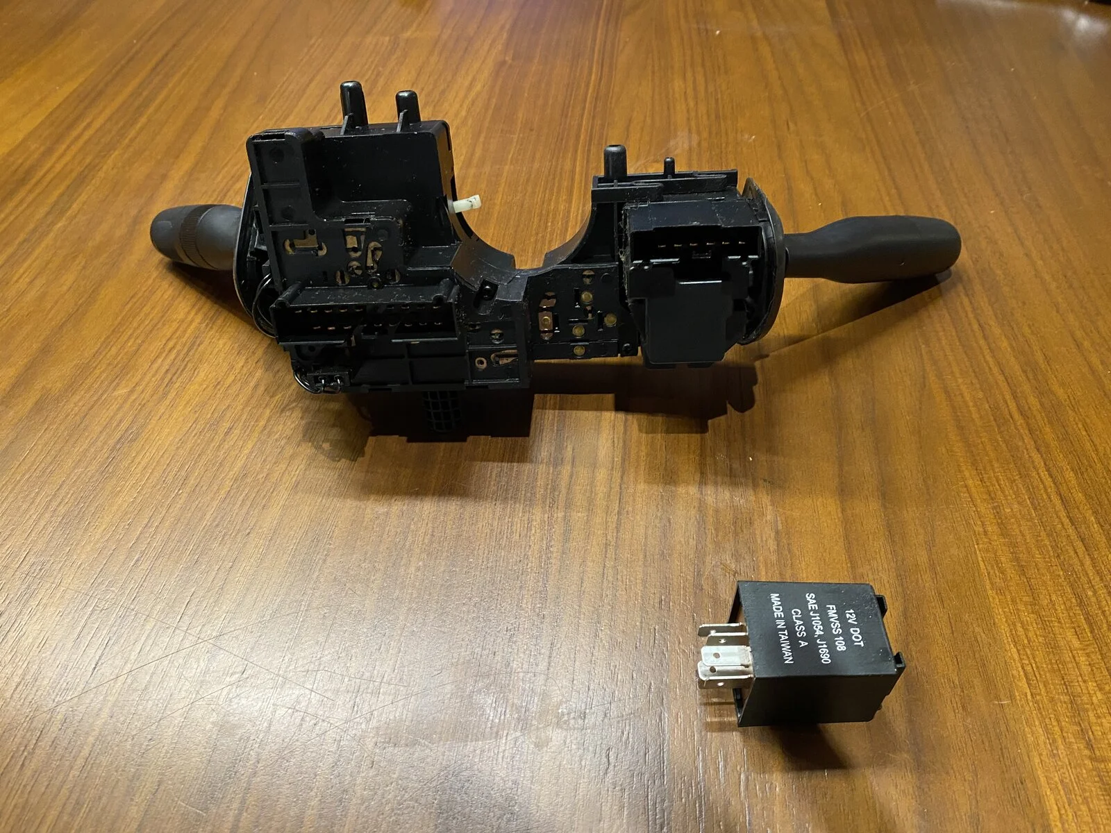

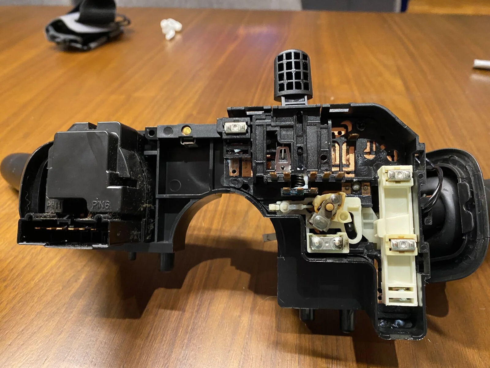

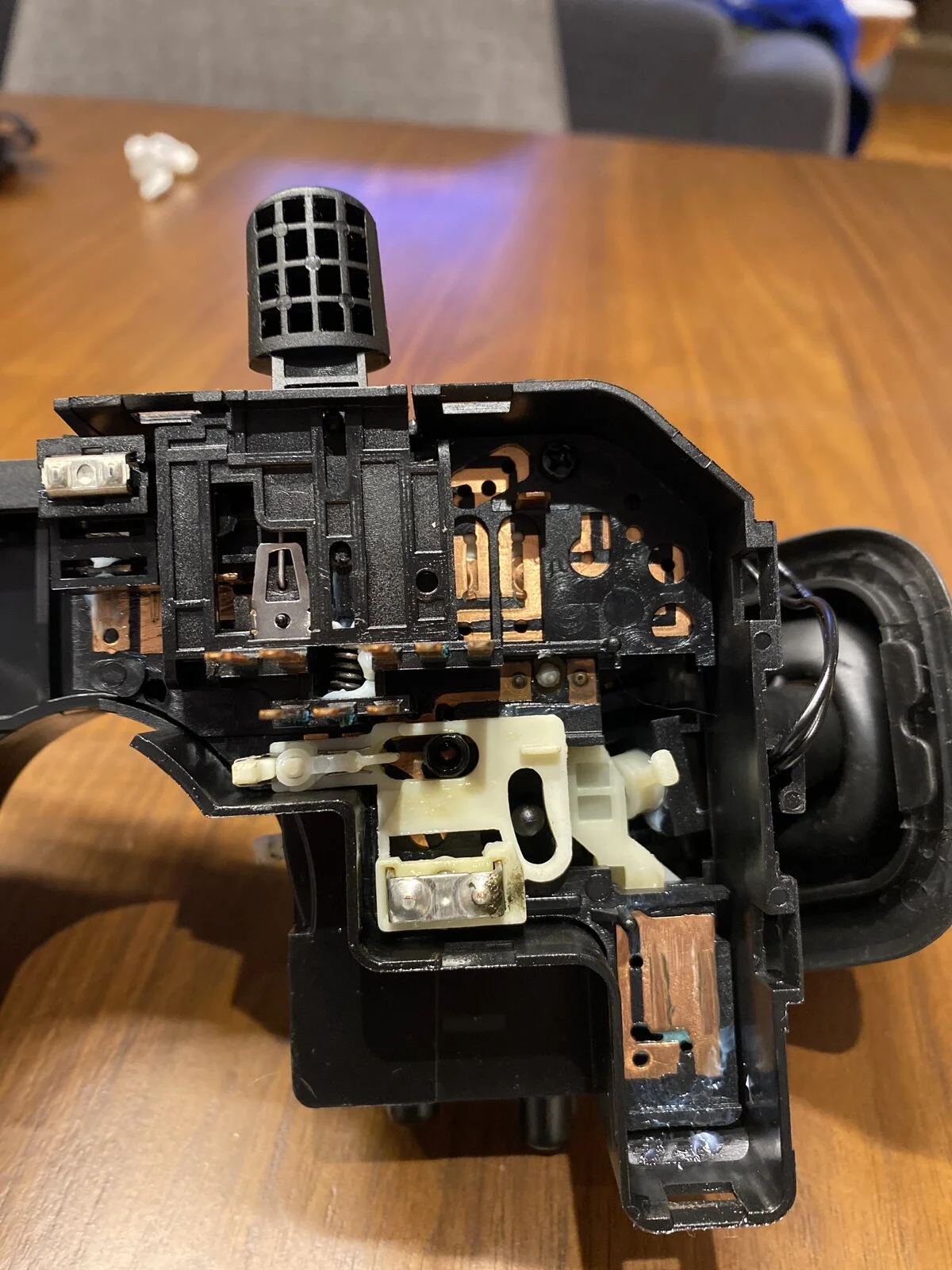

Had a fun little night last night! Turns out my battery was dead and it didn't take long to figure out that it was b/c my fog lights won't turn off unless i turn on the left turn signal (thanks @VirtualRussel from this great thread by @Chris, so thanks for that!)
anywho, took the whole thing apart, found the piece in question causing the problem - it was worn down pretty severally, did what I needed to so that the contact spot was built up, and I'm just waiting for it to cure! Better than spending $80 for a new multiswitch, that's for sure
