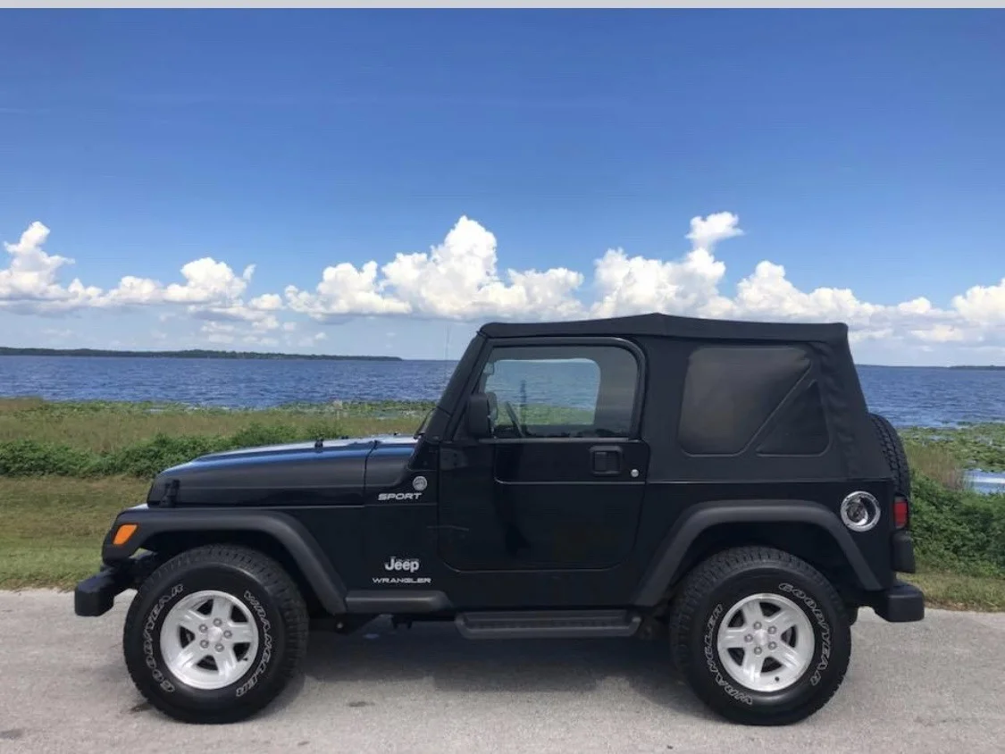

Alright I’ve had my tj for a month now and have put a few things in like leds and new head system. I do plan on lifting and linexing it early next year. But now what? What do I need to do to make sure its running at its best? I’m new to Jeep’s and working on vehicles in general so please keep that in mind when pointing me in the right direction. It’s a stock 05 sport in fantastic shape and is my DD and dog/beach mobile.
Welcome to the forum first off. It's nice to see a female TJ owner (especially since all the female's I see are driving JKs)!
It looks like your TJ is in excellent shape. However, given how old our TJs are, even if the mileage isn't high I always recommend a cooling system overhaul (see here: Jeep Wrangler TJ Cooling System Overhaul FAQ), because cooling systems are probably one of the most common things to fail on older vehicles.
But other than that, I'm not sure there's much you need to worry about. As preventative maintenance you could replace the spark plugs (see here: What are the best spark plugs for my Jeep Wrangler TJ 4.0?) and replace the O2 sensors as well (see here: The Official Jeep Wrangler TJ Oxygen (O2) Sensor Thread) as those are all items that should be replaced as part of routine maintenance anyhow.

Why thank you. I think most of the girls like the JKs for all the pink accessories you can add to it . Trust me no pink camo bezels or salt life decals for me. I did read the spark plug thread last night and got those ordered. I’ll tske a look at the O2 as well. Thanks!
