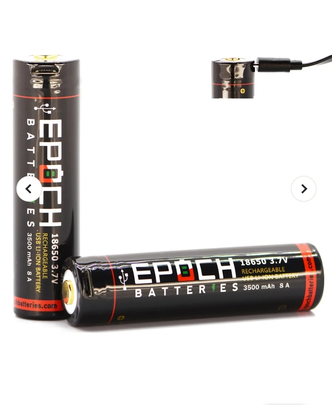

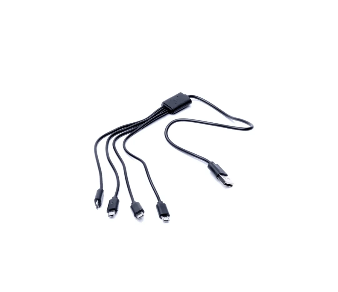

To power 4 of these:
I know that cable is only usb 2.0. Which I think slows my charge time.
Will these batteries charge any slower when charging four of them vs charging one at a time? What about if I only charged two at a time? I can of course find a single cable that is 3.0. Would charging them one at a time with a usb 3.0 cable be fastest?

But nowadays most weapon lights and flashlights run off of these larger 18650 batteries. So i was forced into carrying two chargers. One for my AAs and one for my 18650s. But then i discovered these usb port 18650s. That dont need a charger. Just a usb cable.
What are the drawbacks to these usb port rechargeable batteries if any? Is my thinking sound here about chargers?

With respect to your specific question each usb port on the booster pack is probably limited to 2.1A or around that, no matter how many times you split it up the total will still just be the rated output of one port. Those little usb things draw about 0.5A so you can charge four on a 2.1A usb port and not catch anything on fire.

I think 18650 raw cells are better, more raw current capacity and generally more robust without the extra circuit board. Opps I dropped it in the water and it's still fine, I need to short it out and start a fire and still use it in my scope, done. That kind of thing. The usb ones are fine for simple plug and play but as far as utility and serviceability there's allot of little circuits in there for just a simple battery.
The cell holders are like the ones at All Electronics. The way I'd do it you have a DC source, at home a 12V supply, with a vehicle the accessory port, with a solar cell the power output. Then you connect that to the charger, a hobby grade device, there are a ton out there. The one I linked to is an inexpensive one that works. Then you connect that to a battery or series of batteries. If you do multiple you probably need balance plugs. There's soldering involved if you want to do multiples. It's not over the top but if you learn it you will be miles ahead.
One upside to my suggestion, say you have that usb 3500mAh 18650, it take 7 hours to charge at 500mAh usb. Charge it with a hobby grade charger and you can do up to 3-4 amps and be done in an hour depending on the cells specs, less if you are in a hurry. It gives you the option to really use your batteries and understand how they work.
