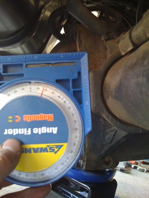

This is my preferred point from which to measure the pinion angle. By rotating the angle finder 90 degrees from the vertical surface you're measuring from it will directly indicate the pinion angle.
This is how/where I measure my pinion angles from...

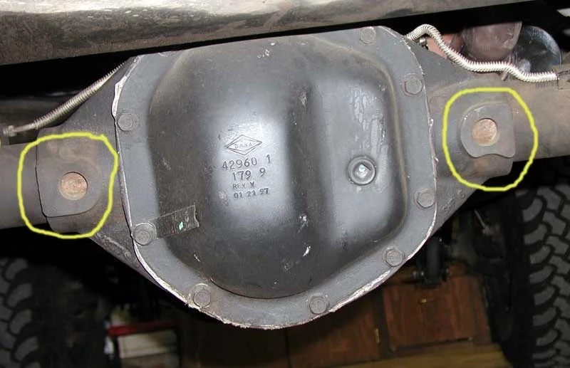

Place the angle finder on either of those two flat surfaces circled in yellow. They are exactly 90 degrees from the pinion angle.

Rotating the angle finder as shown below will cause it to directly indicate the pinion angle.
