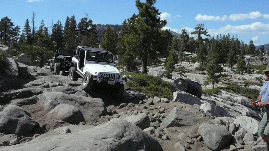

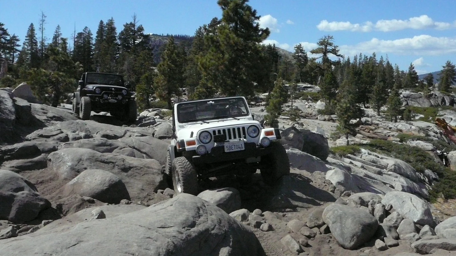

Thanks. Here's some motivation for you. Me on the Rubicon Trail with 2.5" lift, no TT, and worn out 32's. It can be done. Just pick your lines, maybe stack a few rocks, and have a trustworthy spotter in the really tough spots.
