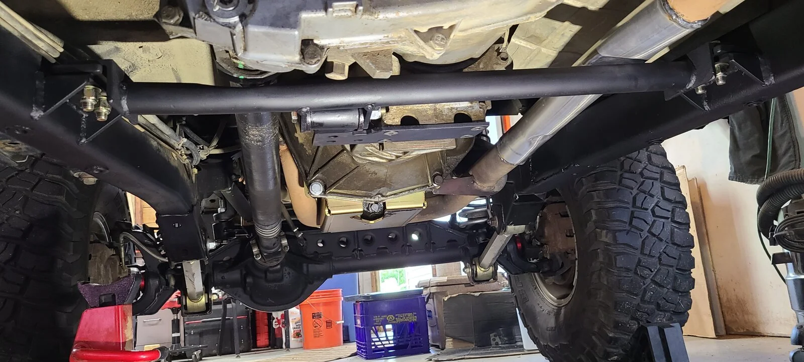

This is the crossmember.

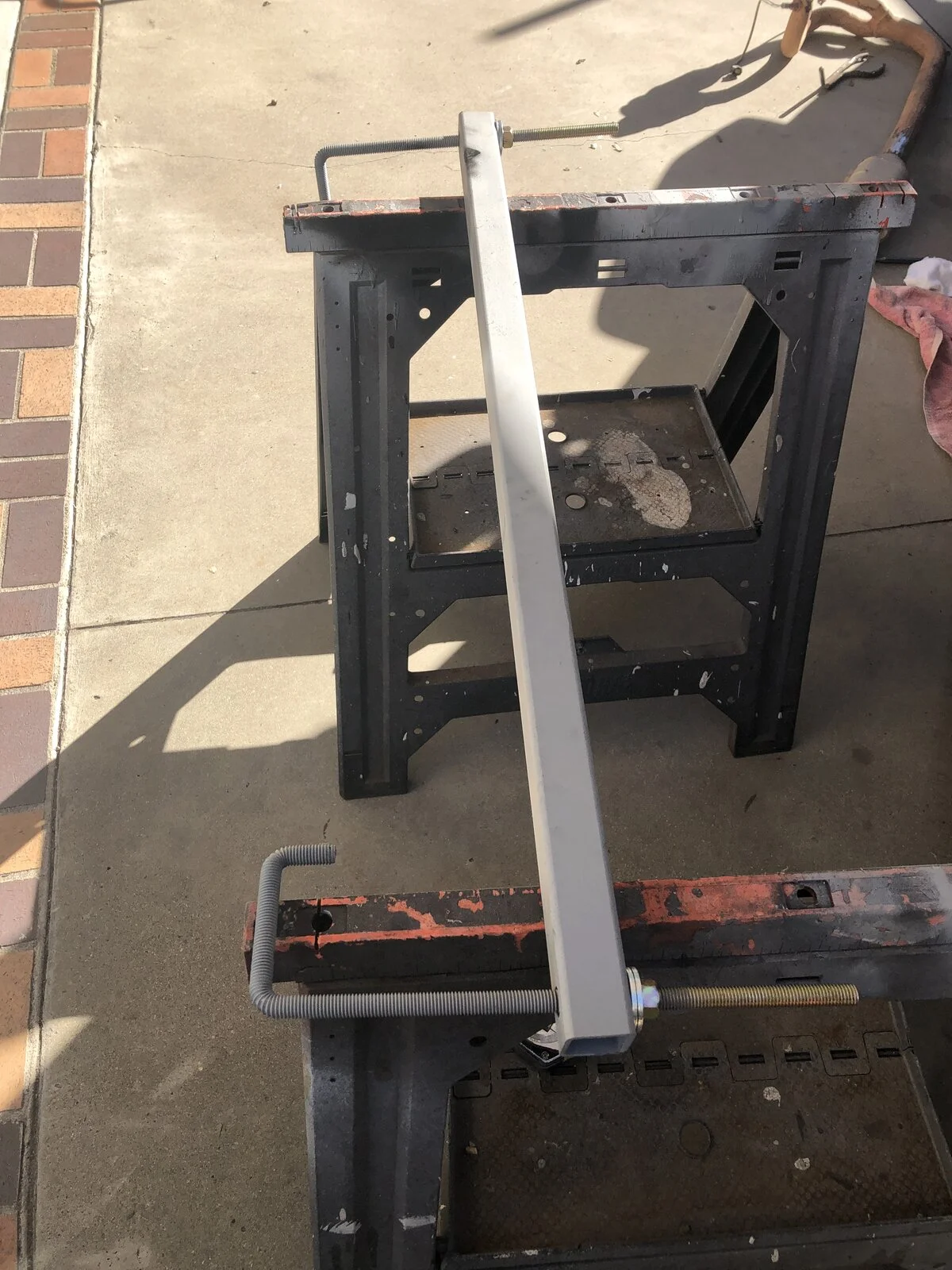

Here is a support I built to support the trans when I would remove my skid ( nth degree) I have since built a separate crossmember. The hooks go on top of the frame and I would put a 1x4 between the tool and the trans pan. I suggest building this if you decide to build a crossmember. It make nothing in the way while working.

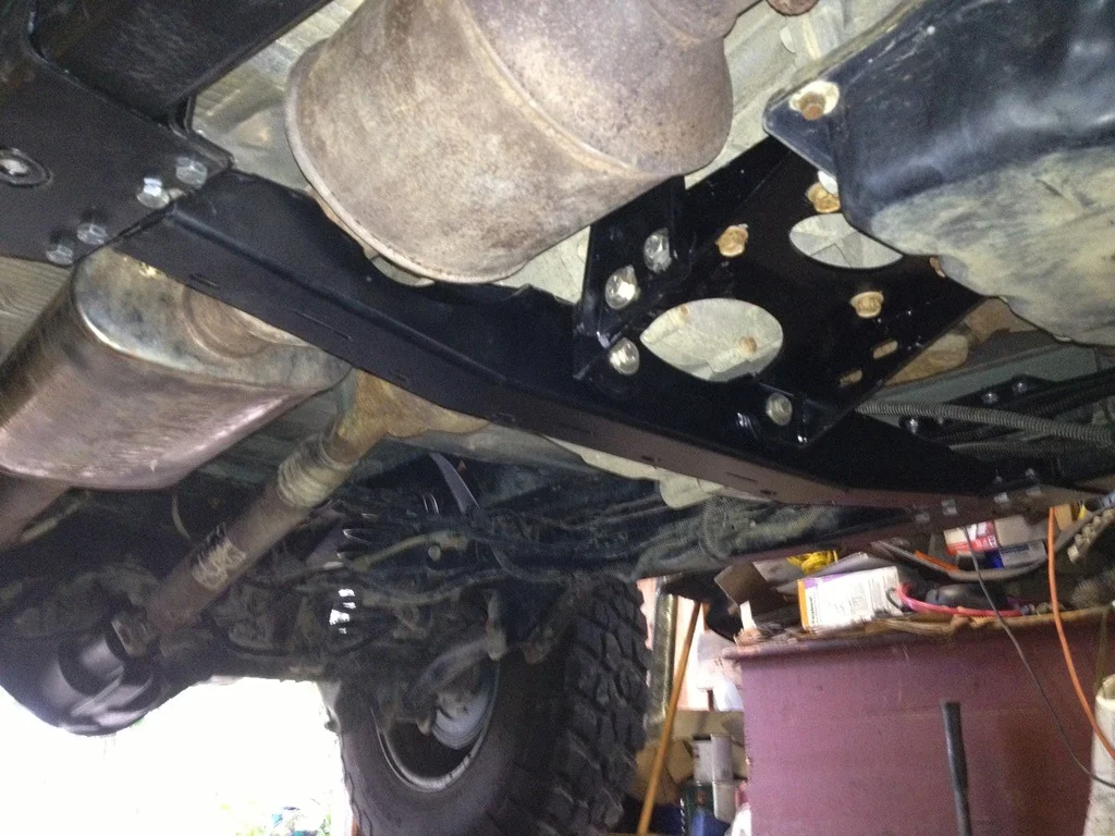

My Savvy crossmember bolts directly to the inboard sides of the frame. A handful of others here did the same.😉

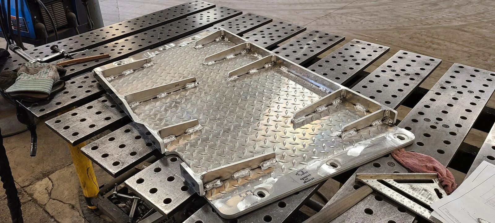

I designed mine to mount the way you're describing.
