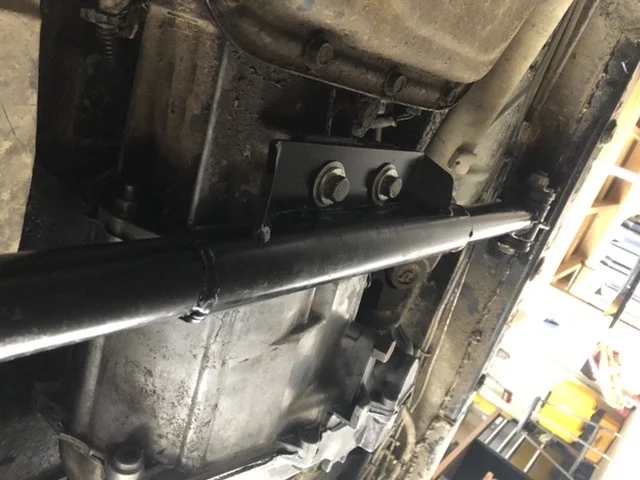

For those that requested pics of the TMR crossmember.
The plate is 1/4”.
I had made repairs to the bottom of the frame and used weld nuts, they protrude 1/4”.
So I have 1/2” drop from the frame.

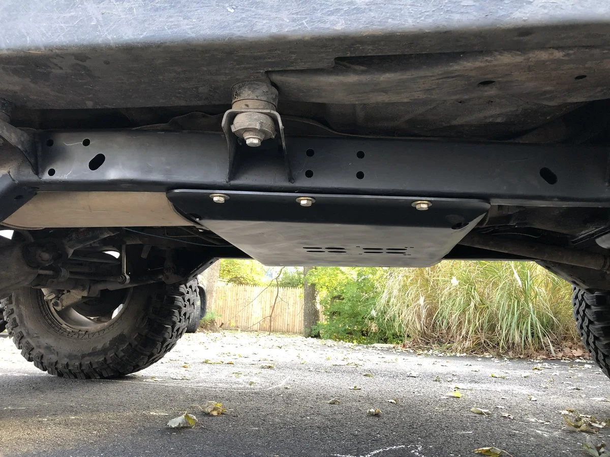

I have the ultra high clearance UCF skid and I used the stock transmission mount. No additional vibes at idle:

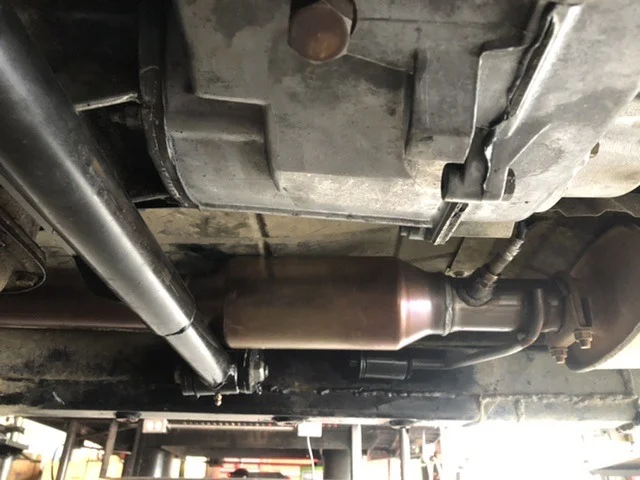

The drop is about 1.25” from the frame rails. Only modification I needed to do was the exhaust system. I love mine and Savvy wasn’t an option since I have a 2.5L.

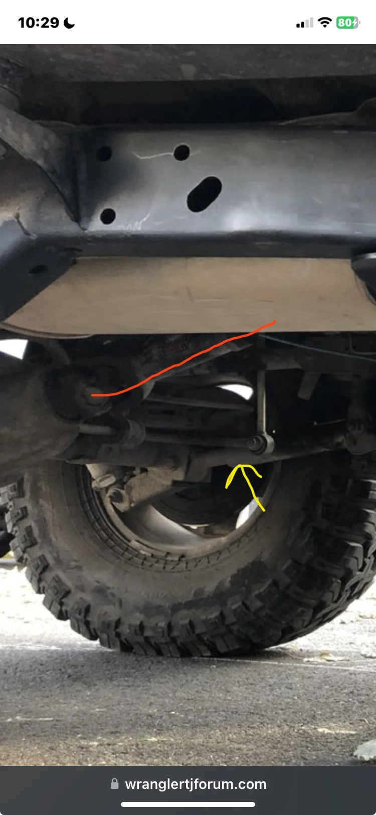

Also, take a close look at the pics in post #39. He’s got adjustable rear control arms and a DC shaft. You can see the pinion rotated up substantially too.

@Musician235
The yellow arrow is pointing at the lower control arm. You can tell it narrows. That’s where the threads are that thread into the arm TJ make adjustments.
The red line is following the angle of the rear driveshaft, which has to be a DC to function properly at that angle.
