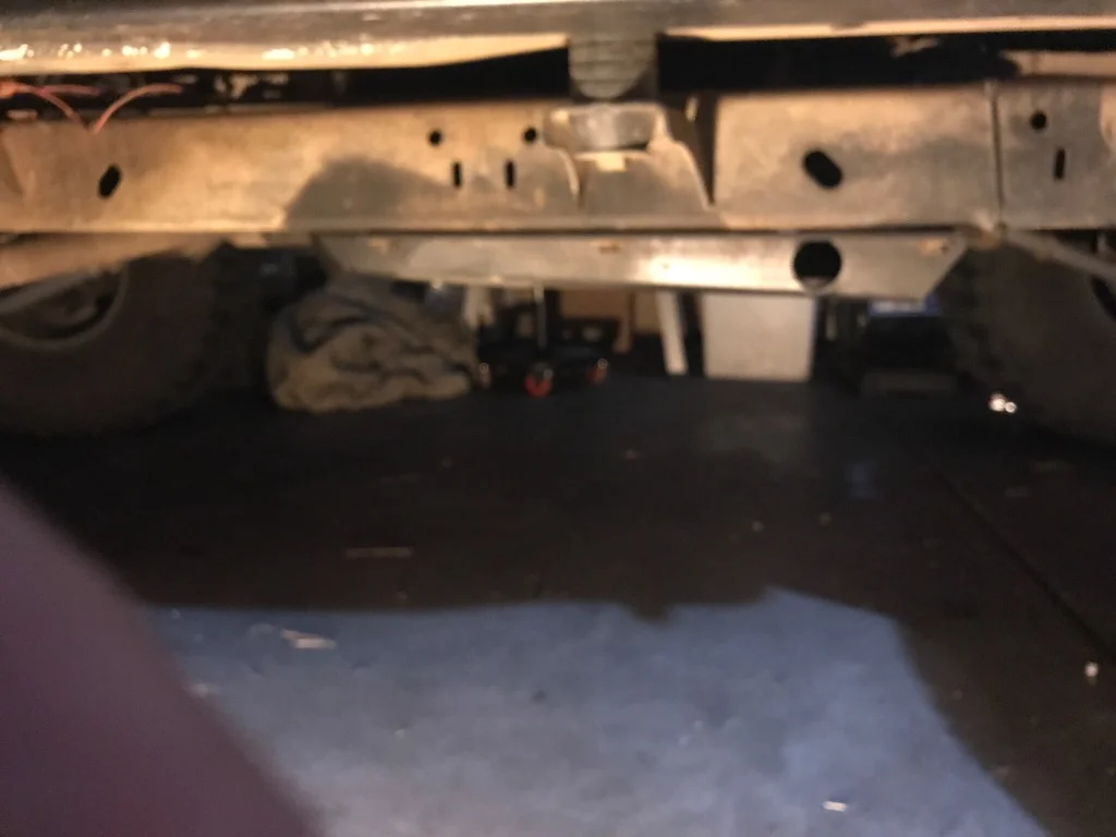

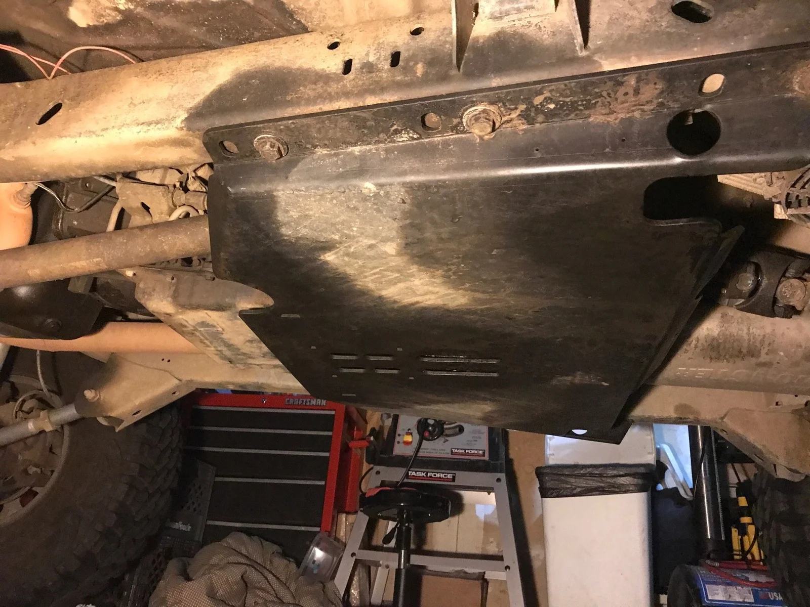

I have a Terraflex TT on my TJ now. The skid is. It flush with the frame. It has about a 1 1/2 drop. I'll take pictures when I get home if you need. I did the 1" motor mount lift, SYE and CV driveshaft. I have adjustable control arms and was able to rotate the rear axel enough to not have any driveline vibrations.
Reactions: KCsTJ and JMT
I'd like to see a pic. Thanks!
Sorry for the crappy lighting. It's pouring outside here.
I also know my heater hose just blew and I have not cleaned everything underneath yet.

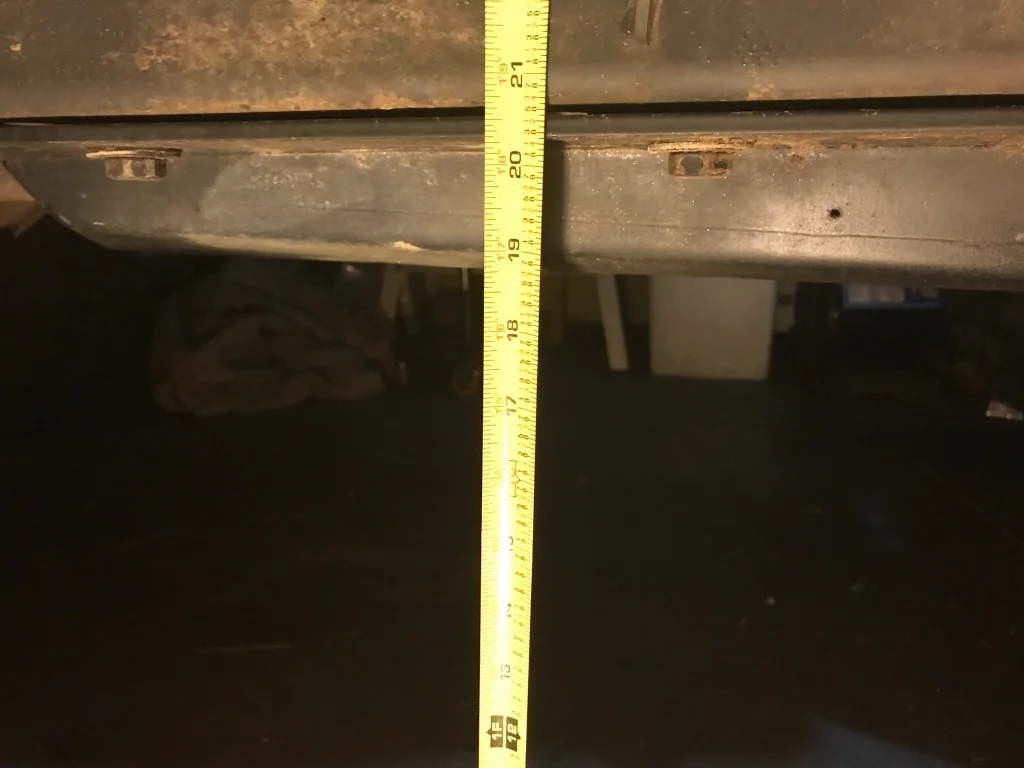

Oooooh, I like, your getting 18 3/4" clearance at the skid! Right now I'm at 12 1/2 with the stock skid and a 3/4" TC drop. What suspension lift do you have and what size tires are you running.
Edit: how is your TC mounted to the skid? I see the slots but I don't see any nuts and bolts.
The tc is bolted, they are sunk in just enough to be clear of damage. Maybe an inch or less.
I am running 35s in a rubicon express super flex 4" kit. With my added weight, it really lifted 3 and 1/4 when measured. I have a lot of add on steel with corner guards, bumpers, racks, winch, and sliders.
