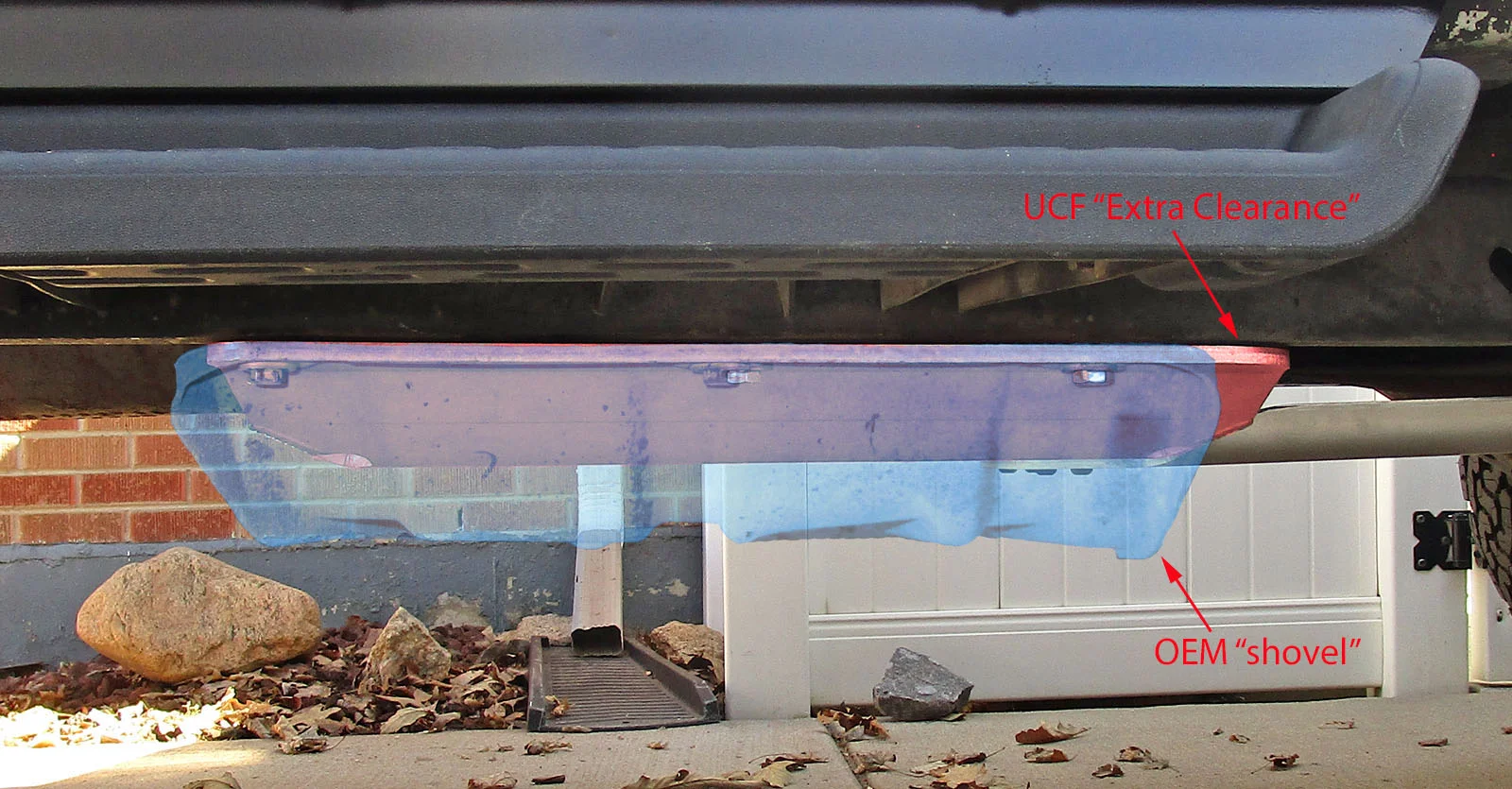

Has anyone ran this set up
Undercover fab aluminum nobody lift skid, plus there trans mount.
Trans mount is 1” less then stock, so hoping with this set up i dont actually raise the drivetrain (also no body lift)
2003 rubicon
Yes, lots of people here have. Something to be aware of: the Lo-pro mount causes vibes in the idle range of 500-900rpm.
Likely at all rpms when the half attached to the transmission often ends up sitting on the skid. Higher rpms just get perceived as general noise rather than a distinct vibration.

The Lopro mount is a terrible design.
Don't be afraid of the body lift. Best bang for the buck mod on TJs. Any "tuck" without a body lift is mostly a compromise.

Thats good to hear haha, unfortunate.
I agree, just opens a can of worms I don’t care to do right now. Body lift, re set arms for pinion, lower lift springs(im sitting at just over 5” from my currie springs) weld on the body mounts i have that eliminate spacer on the 3 frame spots
Just wanted something a little better then the stock skid and its so bent up its a pain to install. The jeep works as is and I don’t really wish to change much as the future is looking like a 4dr minivan for myself
