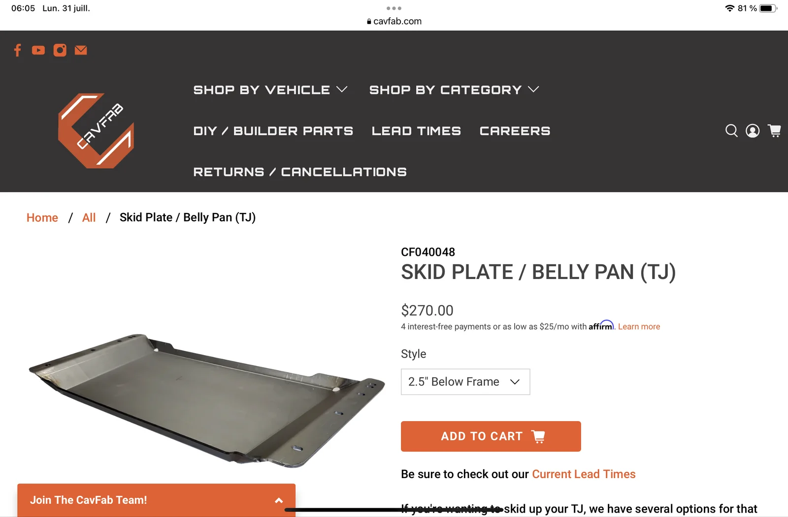

What do you think of this one ?
The original seems to be around 4 inches drop
