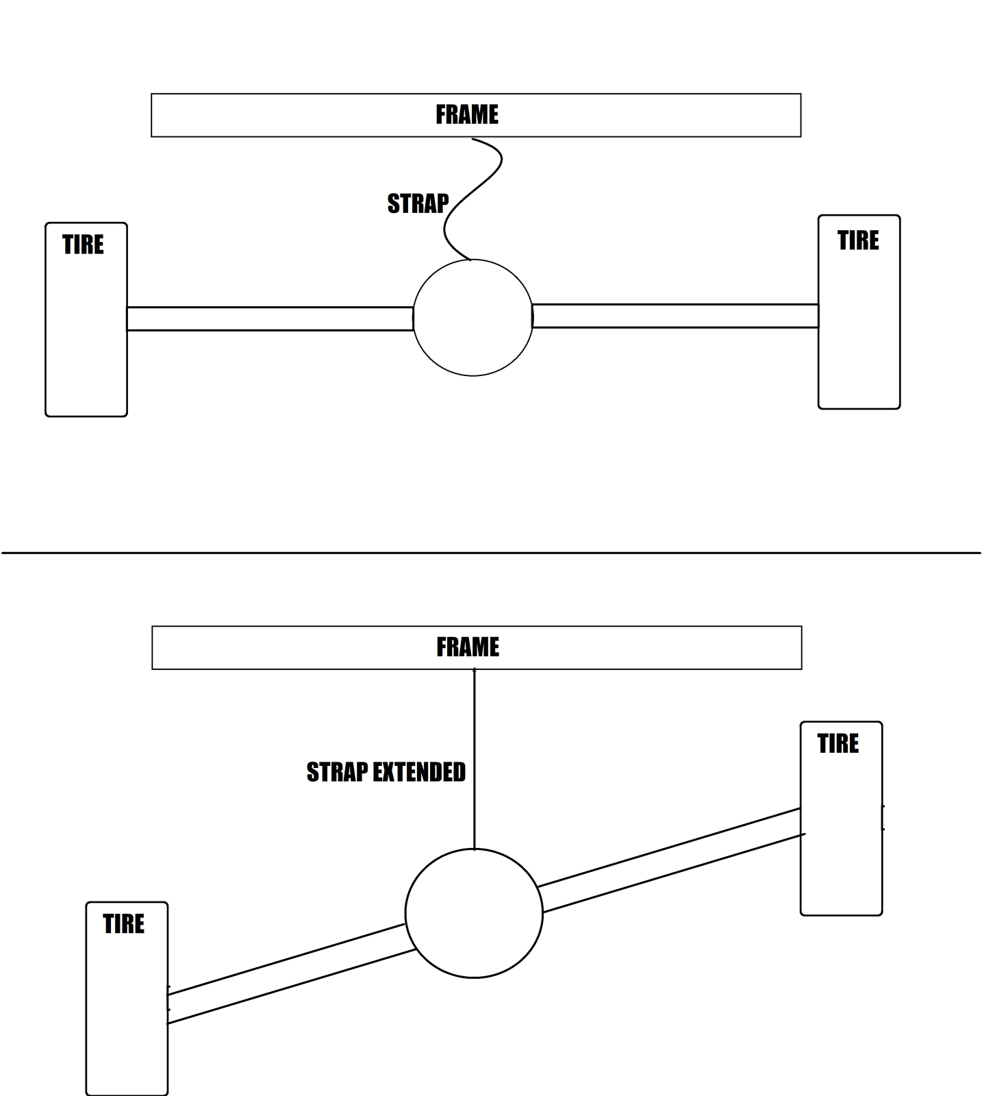

Mine starts to bind at about 5.5" of droop from ride height. That seems to be where it happens. My answer was to add a center limit strap between the diff and shock mount crossmember.
I just created a quick drawing, explaining something regarding limit straps for a guy so I decided it might be a good idea to use that drawing to add to any other conversations about limit straps. In case someone looking for answers stumbles upon this thread in the future.
Here's the deal with limit straps, they don't need to limit your wheel travel. If you put just a single limit strap over the differential as mentioned by jjvw above, that will prevent the drive shaft from binding but still allow the axle to see-saw and give you full independent wheel articulation. The attached drawing illustrates this.

What if the limit straps keep the springs in? What if the limit straps prevent the shock from breaking off the mount? I don't know, I don't run them but I didn't think their only purpose was protecting the driveshaft from over extension.
I think he’s pointing out a limit strap doesn’t have to limit flex.
If you run straps for another reason, that’s a different story.
Good point/question. I have a habit of looking at things through the lens of the drive shaft so when I tell someone they need a limit strap it's to prevent binding on the drive shaft. Usually I'll bring up this center strap axle see-saw thing because people get cagey when they think I'm telling them they need to limit the down-travel on the big expensive coil-overs they just installed. There are other reasons to run limit straps though and some of those reasons would necessitate putting two straps out closer to the wheels.
It is in my case. My shocks are the limit to droop, but that puts the rear driveshaft into bind. So I added a center strap as pictured.
But no one is saying a limit strap can't be used for other purposes. Nothing is stopping me from adding an additional straps to limit the shocks, except that I believe it to be unnecessary.
Reactions: pagrey
I'm sure you're right about what you posted but I don't think you chose the best wording that I changed to red. If full independent, one side going down wouldn't force the other side up, down or anywhere. I'm just saying that for anyone seeing this that might not know enough about suspensions to realize what exactly is what.
Now after looking at your 2nd picture while typing that, I'm wondering if anyone has ever rotated the big Cs and steering knuckles on each end of a front axle a good 90 degrees or so, installed it in the rear and used some heavy ass tie rods to connect each knuckle to the frame to keep those tires perpendicular to the world below them and away from the stuff beside them (frame, springs, whatevers). Oh, and ditch the ball joints (now on their sides) for king pins and.... Oops, sorry I'm already just wondering too deep into a rabbit hole of craziness that isn't needed but at least I'm glad I didn't wander into.
You are absolutely right, by definition the wheel travel on one side is actually dependent on the other side. For one side to go down to max droop the other side will have to go up some. It's not independent suspension. Of course what I mean and what I hope most people understand is that limit straps don't have to limit suspension travel as much as most people would imagine. In most real world scenarios for one tire to droop out full the other one gets stuffed anyway so the center strap doesn't limit suspension travel in the most slow speed scenarios. Jumps or whoops are a different story though.
In my second picture, the only reason the tires are perpendicular to the ground simply because it was a 5 minute Microsoft paint drawing, I didn't have the tools nor the time to change the angle of the tires. In real life of course the tires would stay perpendicular to the axles and would tip to the side, on a rear axle at least. I also wonder if anyone has figured out a way to keep the front tires perpendicular.
