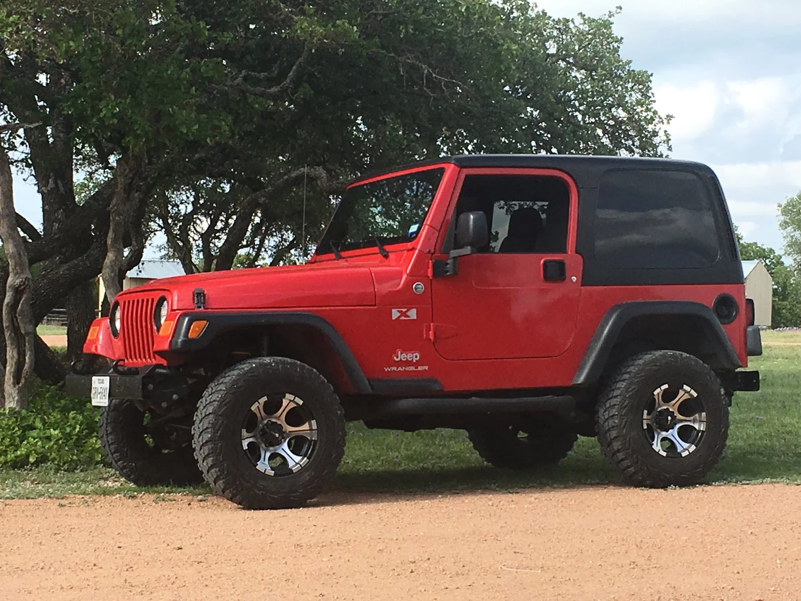

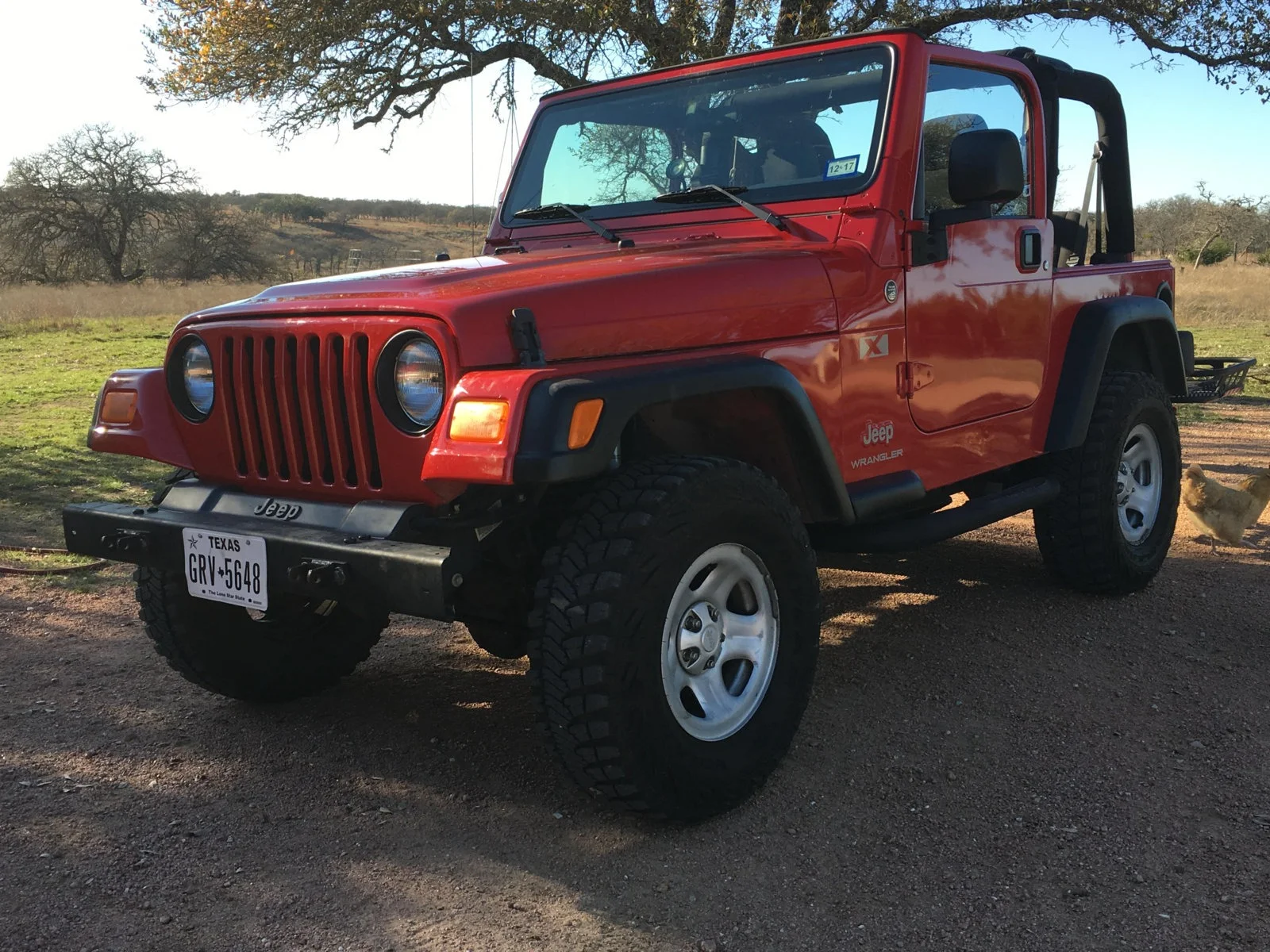

That pic was a little dated, and still had stock springs and BB. Here's the current rig...thanks, good food for thought...
Reactions: KCsTJ

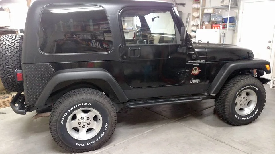

Here was mine with a 2" spring lift, 1.25" BL and 32" tires. Doesn't look "stupid". I was going to add a .75" spacer to the front, but sold it first.
Reactions: Leftlegless and JMT

Well you definitely have room for 32" tires as you sit. There also are aftermarket skid plates that claim you don't need a body lift, the name eludes me at the moment, but I have looked into one of those also. Not as much clearance as some of the more popular TTs, but better than the stock shovel. I am curious, what was the net difference between the BB and stock springs, and the OME lift?
