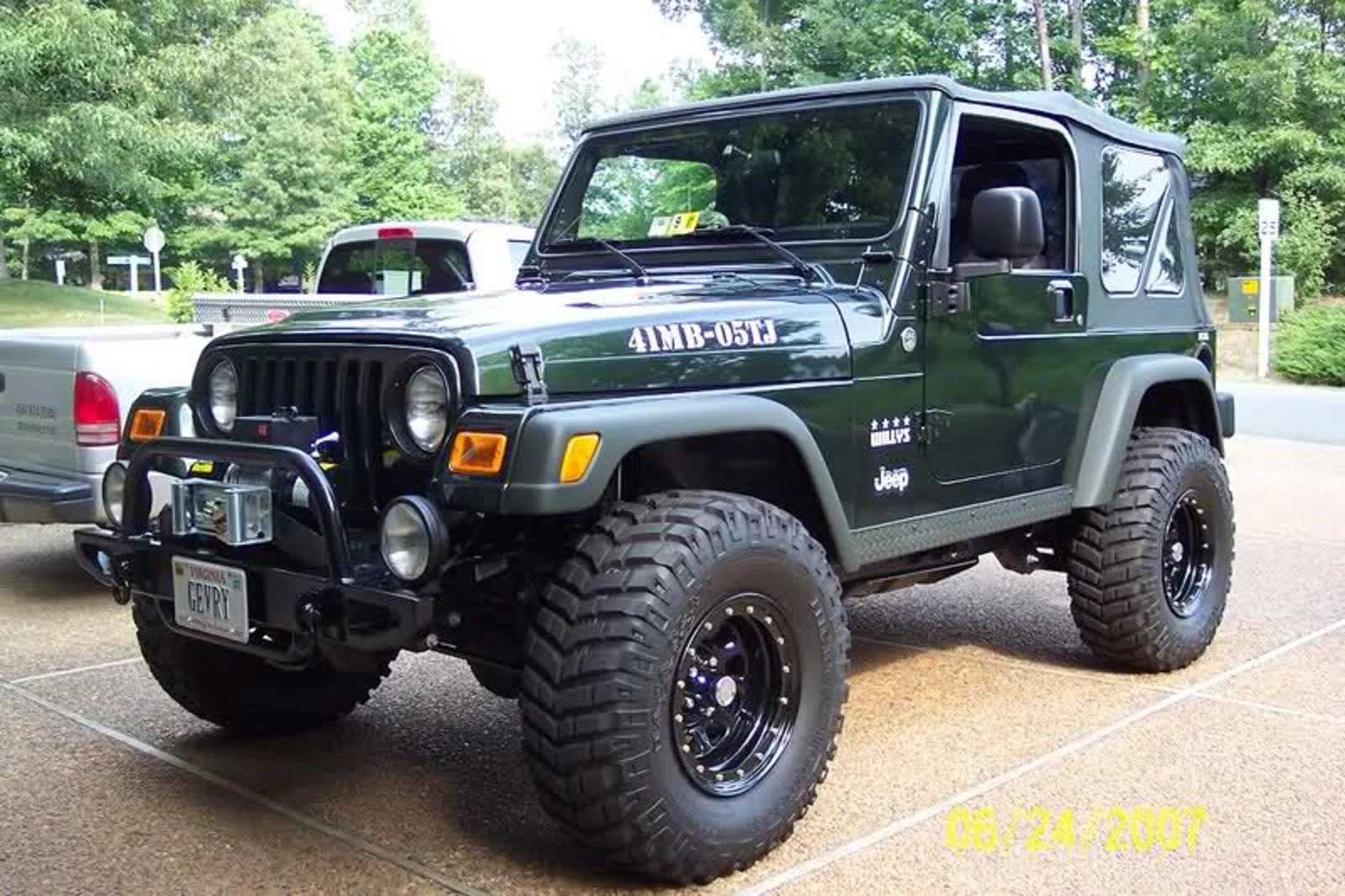

2.25" BB lift with 33s. Worked fine for street use and got 18 mpg highway with stock 3.73 gears. Even with the heavy bumpers and winch.
