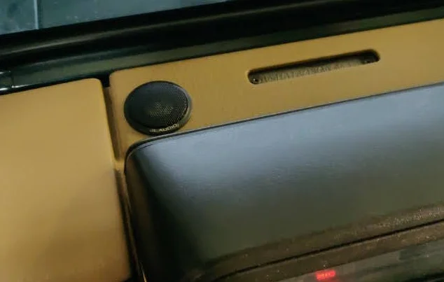

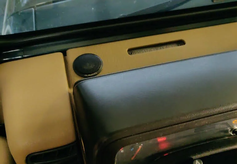

That same speaker and enclosure with a 1" tweeter in the top of the dash really improved the sound. I am just running it of a cheap aftermarket head unit too. With an amp it will be even better.
Can you give me some more info on the 1” tweeter
I used these.
https://www.crutchfield.com/p_13699048/JL-Audio-C1-075ct.html?tp=107

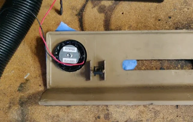

They come with an in-line cross-over and surface mount so you could put them in without cutting the dash. I used a hole saw to put them in the vent cover and hot glued them in. They sound really nice with the dash pods and 5.25" front speakers just running off a cheap head unit. I mean, not really nice like a $5000 kit in an car, but really nice like $600 total cost in a soft top Jeep.
So for something like this you just splice these into the front speaker wires? I’ve been wanting to get a pillar tweeters but wasn’t sure how to go about it, didn’t know if I had to replace my front speakers. I have a 75x4w amp and those say 50w rms max so they might not work for me
Yes, I just ran the wires down to the lower speakers and spliced them in. It increases the ohms a bit, but with a small tweeter it should be fine. With the speaker pods and the tweeter on the dash it really helped the sound.

I have been really pleased with how it sounds for how little it cost. They could use a small amp as right now just the head-unit is driving everything. I would go with a soft dome tweeter if you can to keep it from being too bright, but overall I am really please with it and I really like the way those tweeters I lnked to sound. Crisp but not harsh.
You have to remember too, I don't have a hard top, so with a soft top or no top you really can't tell the diffrence between a high end system and an OK system. It is all just kind of background noise to the music of the 31's.
