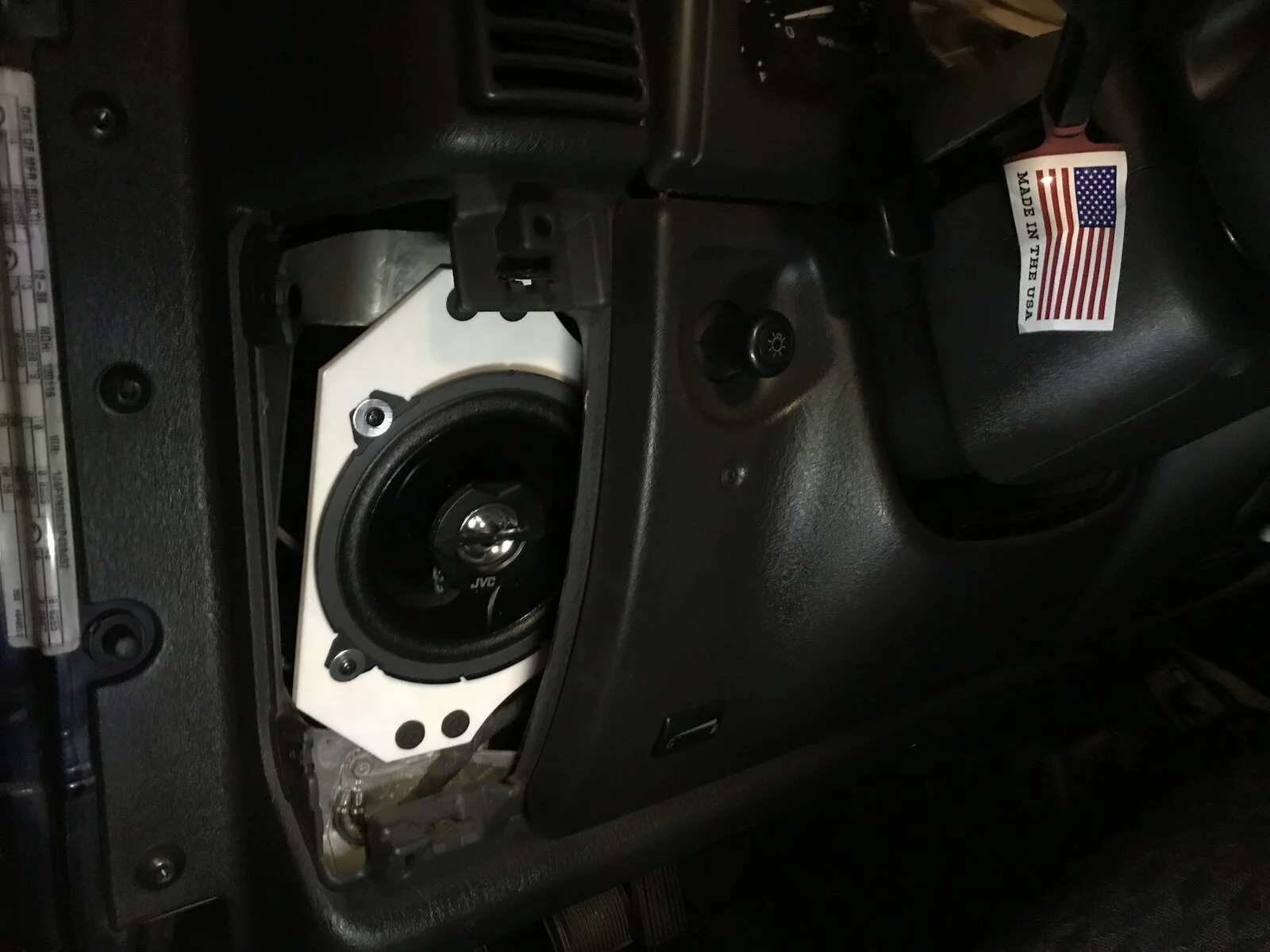

They mount where the 4x6 factory speakers are in the ends of the dashboard. Remove the 4x6, install pods, install speakers in pods. The above set up is exactly what we have in ours. The pods are stupid expensive for what they are but worth it imo

If you skip the pods, please make sure you get boom mats behind the speakers. The pods will allow for better sound, only if you use polyfill inside to tune them with a decent speaker. Speaker sensitivity match is more important than anything else.
I chose speakers with a lower sensitivity and opted for no pods, but have boom mats behind the speakers do that the sound is not "lost" behind the dash. Sort of speak. I can tell the difference with some music types with or without the boom mat, which is why i chose to keep it. In my JKU I polyfilled the speaker pods and upgraded the factory speakers to better more sensitive ones and that made a night and day difference, even with the stock unit. I didn't even touch the tweeters.

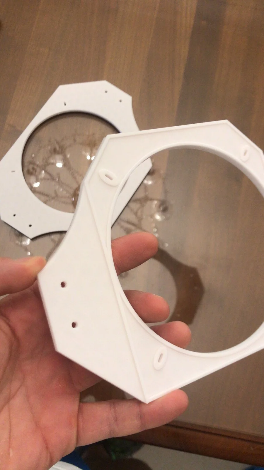

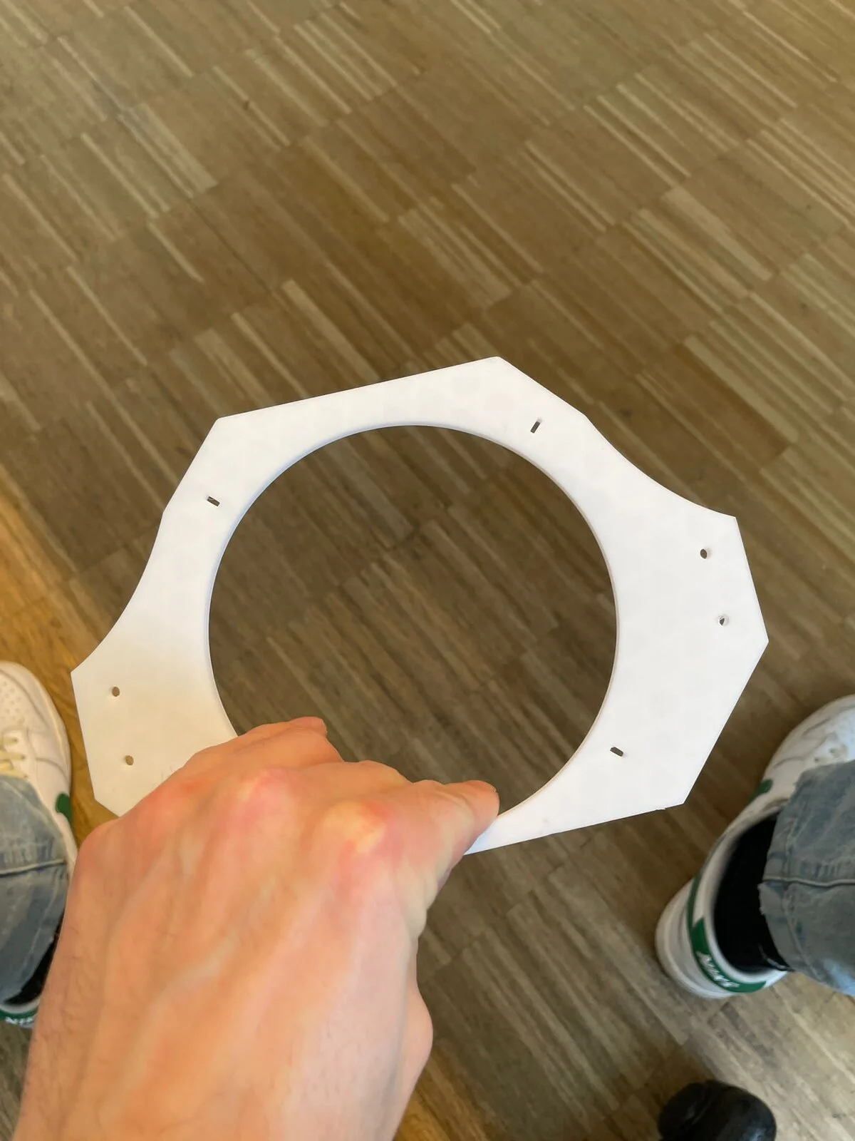

It’s easy to design them on the cad and then 3d print 👍🏼
I used some metal ones that were pretty cheap on Amazon. Exact same concept, but I appreciate that! I wish I had a 3D printer! That would’ve been much cheaper, maybe?
If it works with no annoying buzzing (since all it's metal.. pods, screws, supports ecc..) it's ok!
Anyway, couple of euros for both included energy ! But you have to design them.. and have a 3d printer, which costs a lot.
I usually design and then "rent" my friend's printer, who also has a TJ so both happy with every projects :ROFLMAO::ROFLMAO:
