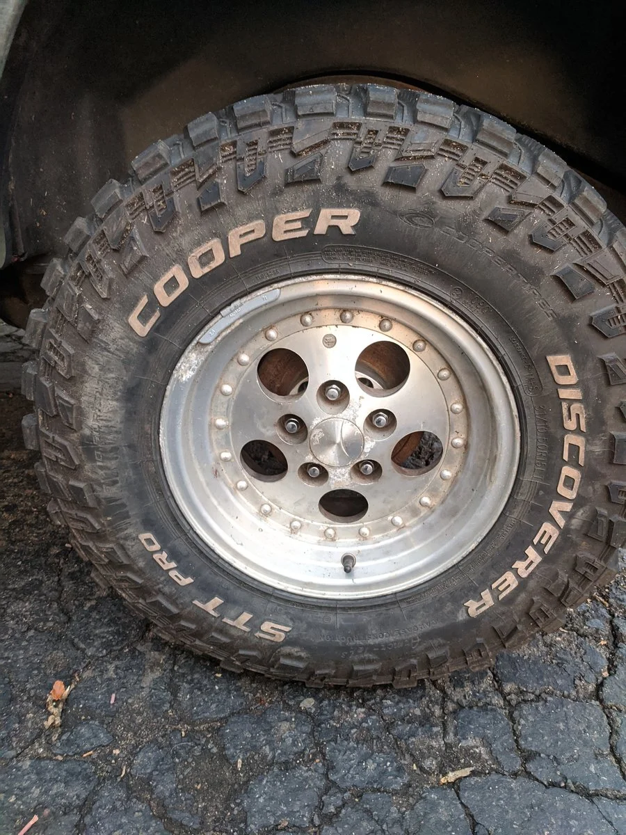

The third question is about tires, I currently have 31x10.50r15 Cooper stt pros on my Jeep with spacers. My Jeep cans with the spacers installed when I purchased my Jeep. I actually didn't know this until a user on this form mentioned it when I posted a picture of my Jeep. When I found out that I had spacers my Jeep was at the mechanic getting looked at, so I called my mechanic to see if my wheels would fit on the Jeep with out the spacers. My mechanic told me that the studs in the hub assembly were too short to mount the wheels back on. I was told that I would need to purchase new studs around the whole Jeep to fit them.
Ideally I want to keep my rims and get new tires. So my question about tires will be here. I am looking for an all terrain tire that is good for snow. In the past when I had my WJ the gyw duratrac tires just released and had reviews of having weak sidewalls. I am thinking that I still want to go with the duratrac but I would like to hear the Jeep community experiences with other all terrain tires. I'm looking for an all terrain that's quieter than my current stt pros, yet also a tire that is good in the off-road scene with good snow performance, yet not a dedicated winter tire. I guess a snowflakes tire would be what I am looking for. Does anyone currently know of a new all terrain in the works? I.e the testing stage.

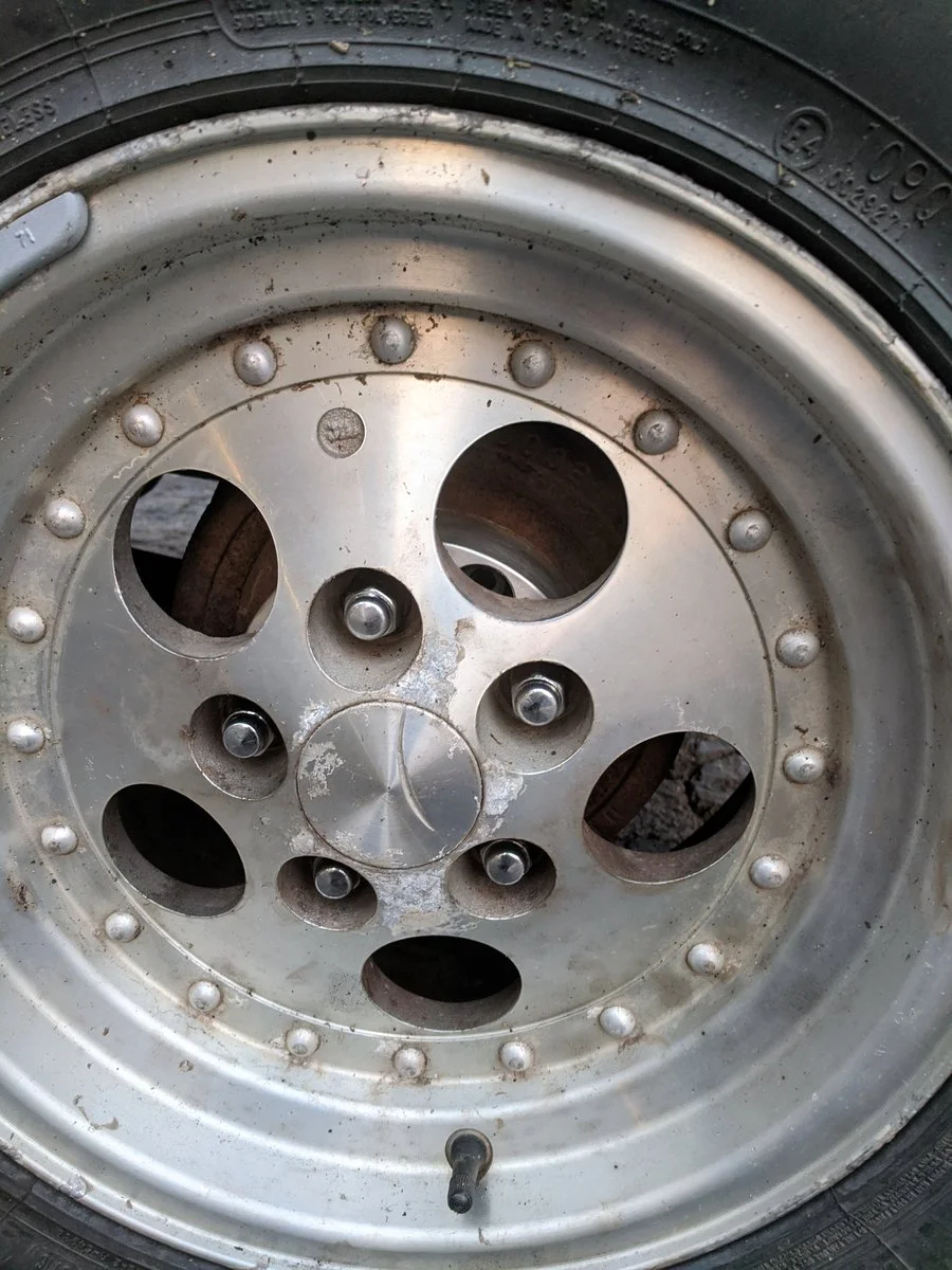

3. Spacers-Generally, spacers require shorter studs for mounting-the OEM studs are too long and would interfere with the mounting of your wheels. You will need to have stock length studs re-installed in order to do away with the spacers and mount your wheels directly to the hubs. I also have the Gambler wheels, which I believe were originally supplied by American Racing.
4. Tires: I use BF Goodrich AT tires, in the same size as yours. These work well in all seasons, and here in VA we have snow occasionally, l and I have had good success on and off road (I do a lot of kayaking and camping, not much hardcore offroading-my Sahara is almost entirely stock and these tires get me where I want to go). I can wholly endorse these tires for your needs. They last long and perform well. I am on my 4th set and generally get a little more than 50k per set, and I always include the spare in the tire rotations.

For the wheels, what was the OEM size for the wheel hubs? Also, about my wheels, I thought I saw someone saying in a previous thread that I posted that my wheels are stock. Can someone confirm this?

The stock bolt pattern is a 5 on 4.5" and yes you want all your tires to match. Even though you can buy many tires in say 31x10.5x15 each brand can be a little different in actual size. If your current spare is dry rotted on the inside while it might hold air it could be unsafe to drive on the road.

Yes, your wheels are stock-they are called Gambler, and I believe they were manufactured by American Racing.
For your tires, I suggest you validate the year. You can do this by finding the DOT numbers on the sidewall of the tires. The very last four digits are the date. Generally, around 10 years is when you should think about replacing tires, especially the spare. I recommend including your spare in your tire rotation-this will make all tires wear evenly and last a bit longer. Here is a pic to help you identify the date. I strongly recommend spending money where it counts: tires, brakes, steering. Cheap out everywhere else if you like, but for these components you should get the highest quality.
