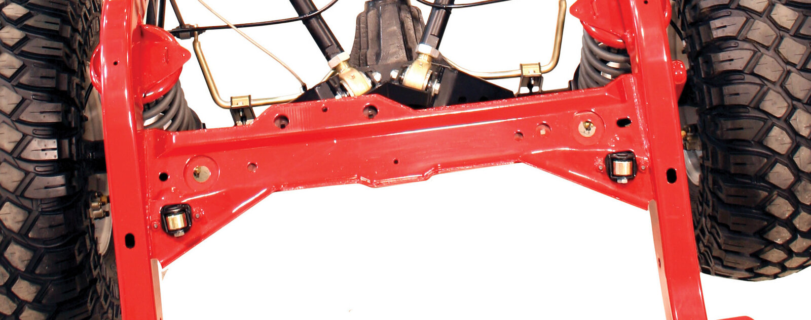

My current shocks are in need of rebuilding or replacing. So I am looking into the Savvy Tuned Fox. My problem is that I currently need a 13.5" rear shock and the Savvy Fox are 14.5". So I am trying to figure out how to make them fit. Do they come with the bar pin in them? If so how hard is it to press it out if I want to use something like this Teraflex shock Adapter.
https://www.quadratec.com/products/16191_504.htm

No, that's the beauty of this adaptor. Its designed to push up above the frame to give an extra inch of room for a longer shock. From the description:
The TJ rear upper shock adapter and relocator eliminates the bar pin, and relocates the mounting position up one inch to allow long travel shocks to be used. Because the mounting point is raised, a one inch body lift is required.
I just didn't know if this would work or create extra bind or clearance issues.

Those can work if the shock body fits into the crossmember. Bind has been thoroughly discussed already. 😉
Any ideas if the Fox body fits into the crossmember?

No idea about the body. Bind is a non issue.
I didn't see that thread either, was it related to the axis of the upper bushing being turned 90° from the stock position?
Seems like if anything, it could be better that way in articulation.

I missed that.
I'm not sure if it'll fit or not.
That is dissappointing to hear. But thanks for letting me know before I go down that road. Was this personal experience?
I bought them about 10 years ago. The ends on the Fox are too large. They're made for something with a standard size shock bushing like a Rancho.
