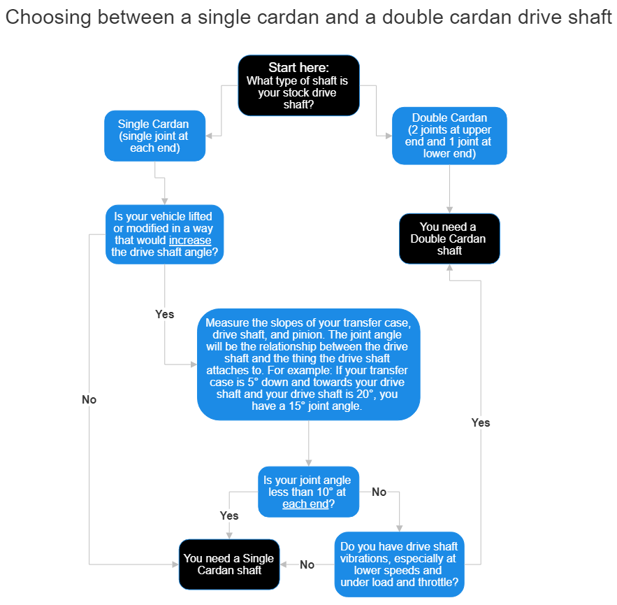

5. What is your favorite driveline set up? CV or regular u joint at each end?
My favorite type of shaft is whichever type of shaft required by the specific application. From an Occam’s Razor approach to design, I prefer the simplest solution/design whenever possible. A single u-joint at each end has fewer moving parts, less things to grease (no centering ball), and less things to potentially wear out. But when a Jeep is lifted, and the angles are increased, a double cardan (CV) shaft is almost always required for smooth power flow. I recently created a flow chart to help people decide between a double cardan and a single cardan shaft. I’ll past that below.
