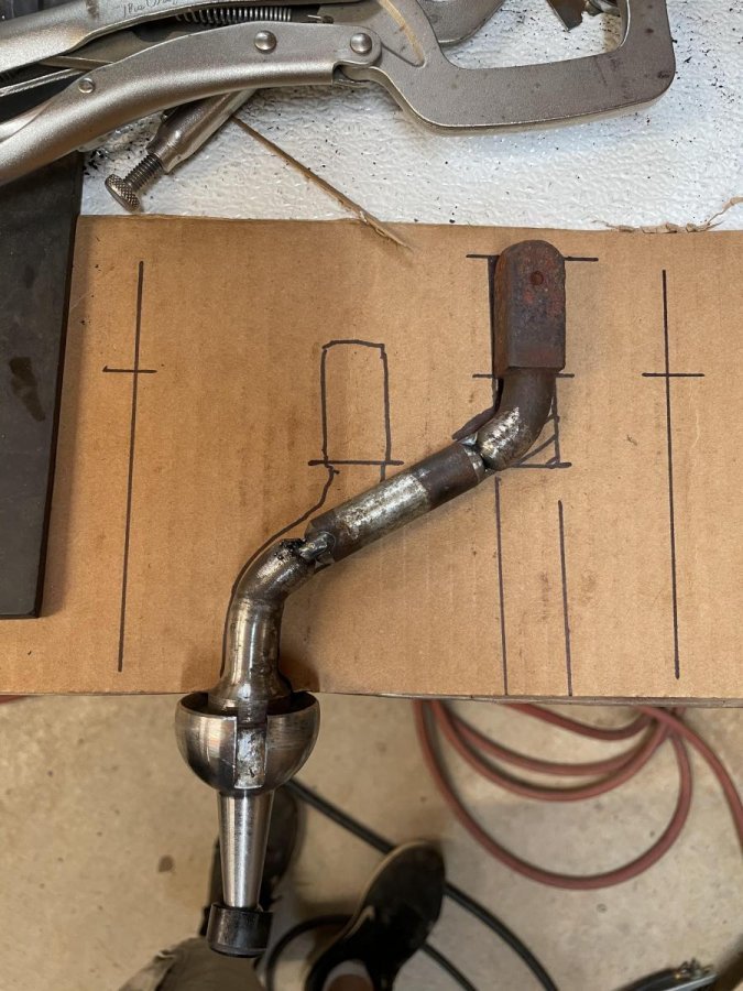

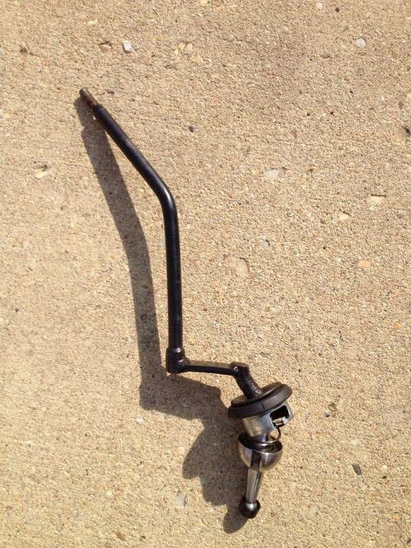

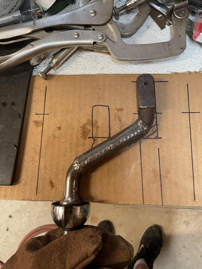

Here is how some have modified their shifters to have the shift handle fit thru the stock hole in the tub.
This first one is a little more elegant.
2nd one gets the job done just isn't a pretty.
