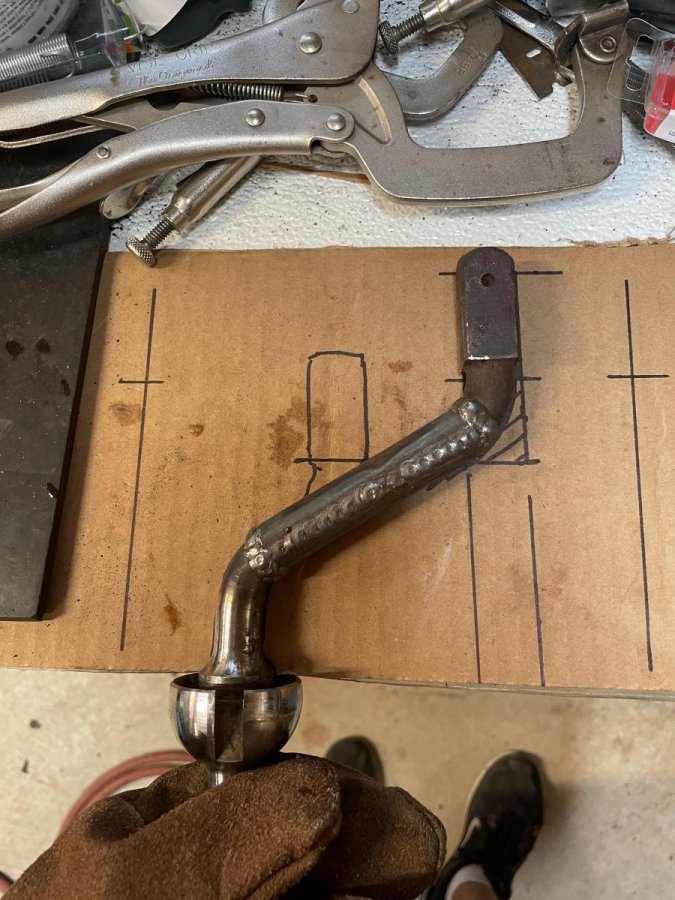

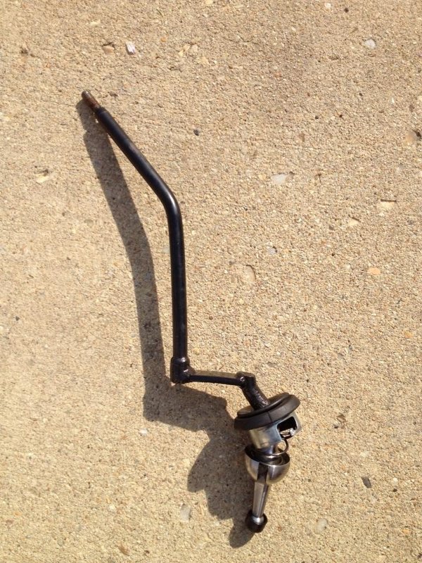

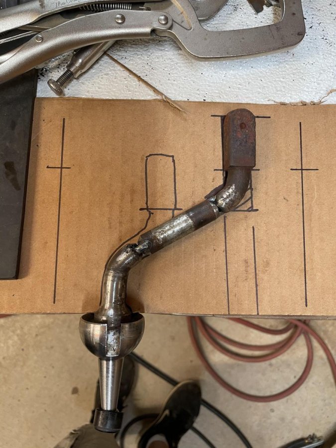

I want to keep my AX15. I have read that with the Dakota bellhousing it will bolt to my trans and I don’t have to move the trans… but what about the other end? I know the ZJs came with a 4.0 and a magnum in some years. Am I hoping for too much when I hope I can bolt to the stock motor mount locations? I don’t weld so if I have to have new mounting locations I will have to have that done by a professional.
Yes the AX15 will bolt up to a magnum engine if you use a 92-98 Dakota bellhousing. But this isn't just bolt it up & you're done. If you put the new motor mounts in the prescribed location your transmission is moved forward about 2" so you have to modify your shifter. You'll also need to shorten your front driveshaft & lengthen your rear driveshaft.
