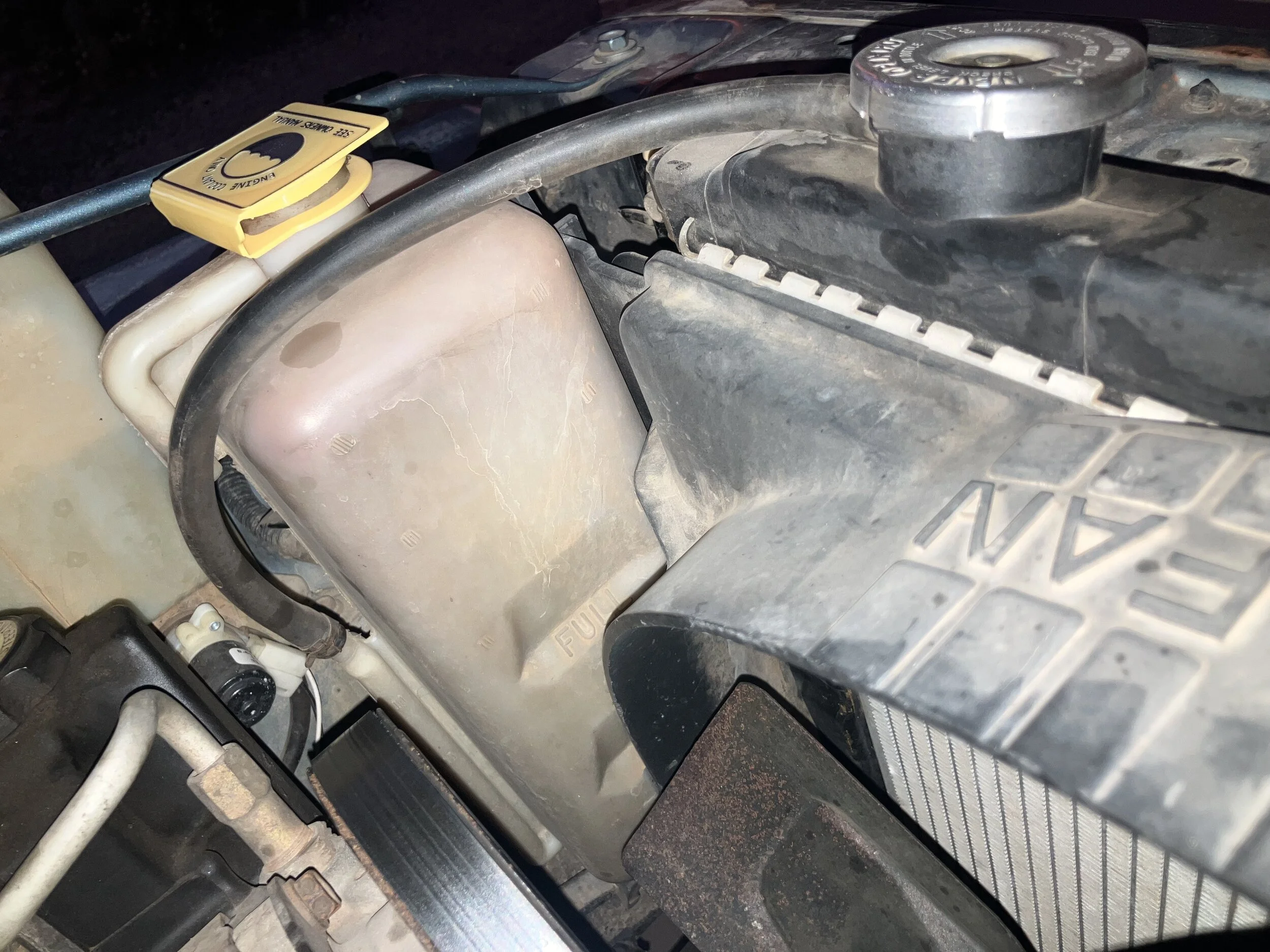

I recently bought a 2006 LJ. It does not run hot but when I shut it off it starts gurgling into the overflow tank. I have done the following, I pressure tested the radiator cap to 18 pounds and it is good (new cap). Tested the coolant for exhaust gas and it stayed blue. Pressure tested the radiator and no leaks. Used the radiator burp funnel kit with the jeep front elevated, I did this more than a half dozen times. No oil in coolant or coolant in oil. I pulled the spark plugs and they all look good and the same. Put in a new thermostat. That fan seems to engage well when hot. The jeep does not overheat while running, the temperature gauge is straight up. Is there something that I have not done yet. I have searched many forums and cannot find anything new. I appreciate your help.
