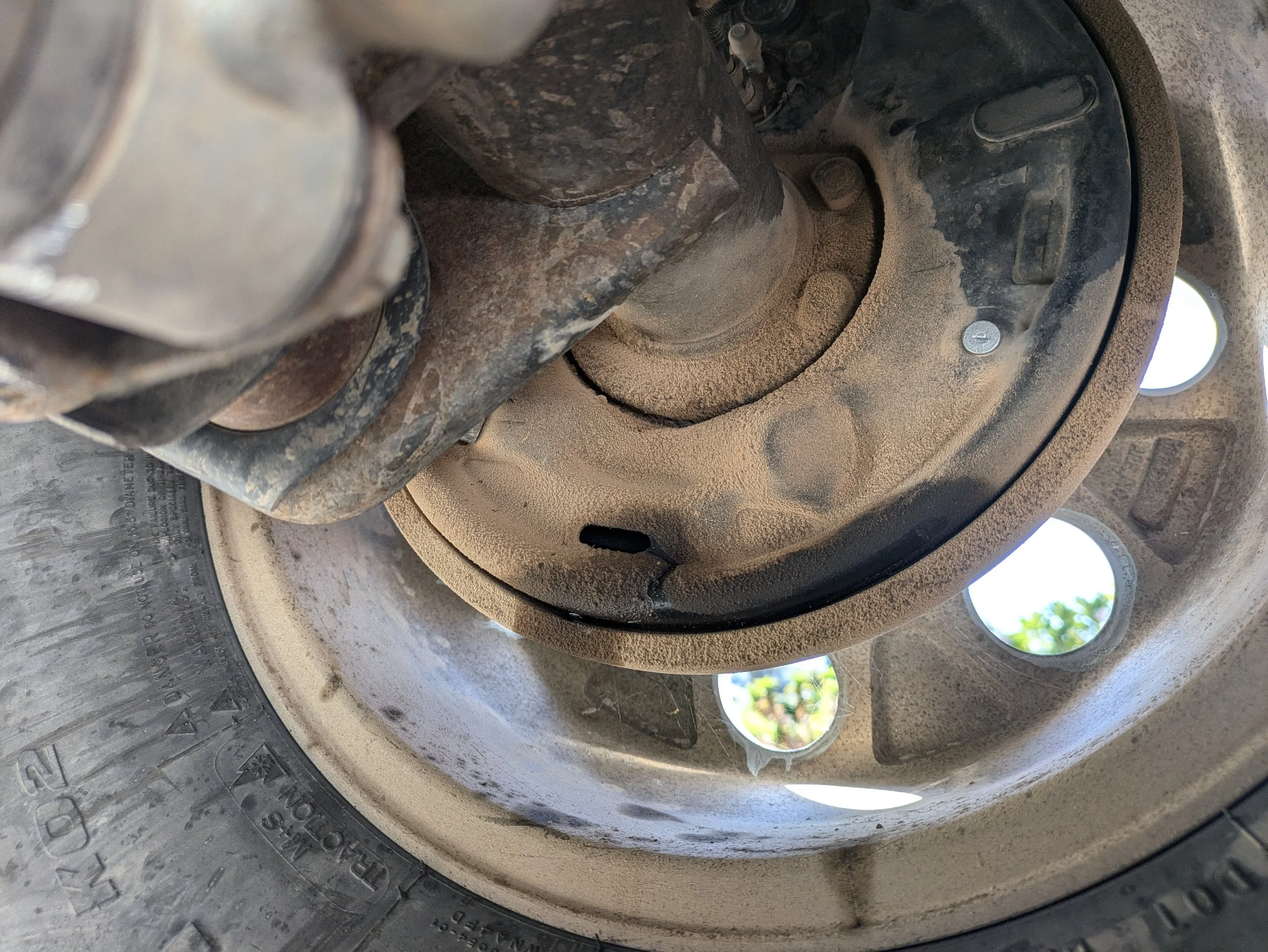

Today I got underneath to inspect for any damage and noticed this leak from my passenger side of the rear axle.
Upon pulling the brake cover, it was coming from the axle seal it appears.
Appreciate any advice on where to go from here everyone, this is a new one for me.
In your photo. You're going to have to pull your axle and the bearing off to replace it. So, you'll need a new bearing kit.

The seal comes off with the bearing when you pull the axle. They are stacked. Yeah, you can drive it if you don't let the gear oil run low. Check the fill hole level on the diff cover occasionally.
It is an easy cheap thing to change Greg. Diff cover comes off,cross pin comes out,c-clips,then axles.
Typically a slide hammer is used to pull the seal and you do the bearing at the same time since play it it can ruin the seal.
Might be able to sneak a cats paw nail puller or lady's foot prybar in to remove just the seal.Or put a long enough screw in the seal to grab it with vise grips and use a flat head screwdriver behind it.
The thing to look out for with a gear oil leak is once it gets on your brake shoes it will make them grab violently and lock up on you. I would fix it for safety and for resale value. Seal only at first if you are feeling lucky? Lubelocker gasket will make the drain and refill much easier
Thanks, that's good to know. I cleaned it up and put everything back together, but sounds like I'll need to make this a sooner rather than later project.
Might need new brake shoes. Once soaked in oil they're usually shot.
If you're doing one side do the other or it'll leak next week.
