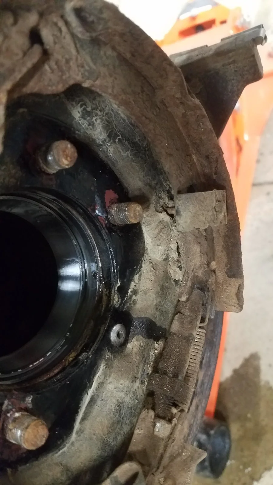

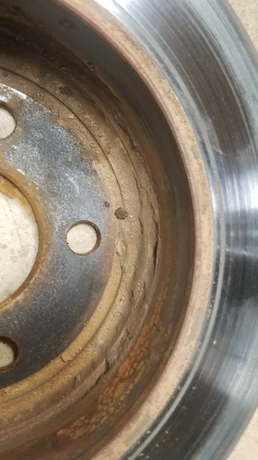

Pretty sure I fried my brakes on the way home from work tonight. I think my parking brake hung up on the drivers side. Got hot enough that it was smoking pretty badly and I thought it prudent to spray water to cool it down.
Anyway, am I doing brakes, rotors, calipers, pads and rebuilding the parking brake, or can I just replace the stuff that is obviously wrong?
04 Rubicon, so discs in the rear.
@mrblaine does black magic have a rear brake "kit?"
Spraying the cold water probably warped the rotor. So I would replace that for sure. Pads are probably fine since they weren't the friction surface engaged. Shoes on the parking brake are probably trashed, I'd do hardware set on that as well.
Most importantly, I'd look into what caused the parking brake to hang up to make sure it doesn't happen again.
Looks like I'll need both pads and shoes. They both look burned. Gonna replace the rotor too... It's a bit discolored on the parking brake surface. I don't know how old it is either... It's been on longer than I've had the Jeep. I'll be calling @mrblaine tomorrow to order some parts.
Why did it hang up? Mud...its the devil! I got stuck a couple weeks ago and buried the driver's side. Thought I got it cleaned out, but apparently not.

Yes, just replace what is needed. If there is nothing wrong with the calipers, keep them.

yeah that's a lot of dust from those shoes wearing down.
If it got as hot as you say, I'd also replace the axle seal as a precaution.
That wasn't pad dust... It's was clay and sand left over from me burying the Jeep a couple weeks ago. I'm assuming that it jammed up the mechanism and didn't allow the parking shoes to release like they are supposed to.
The axle seal is fine.

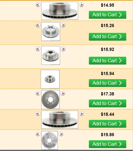

You'd really spend 15 bucks to turn a 20 dollar rotor?
I would, and I still do, until the originals are no longer usable. I also rebuild my wheel cylinders. I've been known to rebuild my master cylinders and calipers, as well, though I will admit that doing the calipers has always been a pain in the ass, and I rarely do so anymore.
Not all will agree, but my reasoning is that the OE parts had already proven themselves, and stood the test of time (and miles). To my way of thinking, their quality has already been established, and it's a good base on which to rebuild. Once upon a time, the cost of rebuilding vs replacing was also a factor, but not so much anymore. The cost of imported parts has forever changed that as a consideration.
Reactions: Steven_Olson
You're not answering the question I asked. I fully understand turning a high dollar OE rotor and if I had anyone close that could, I would have them do it. I would not turn a 20 dollar rotor and anyone that does is silly.
Okay. Generally speaking, no, I would not turn a $20 aftermarket rotor or drum.
