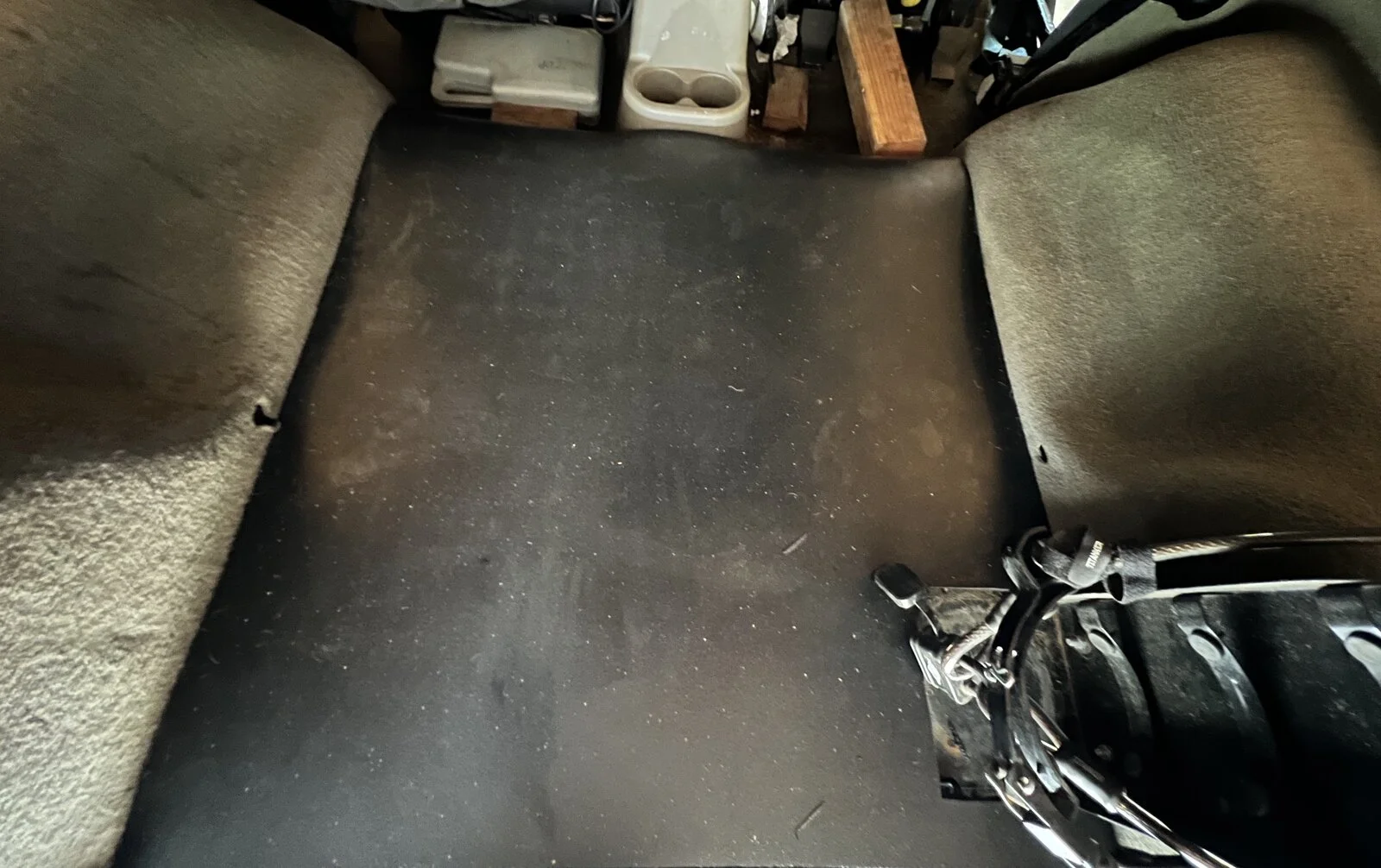

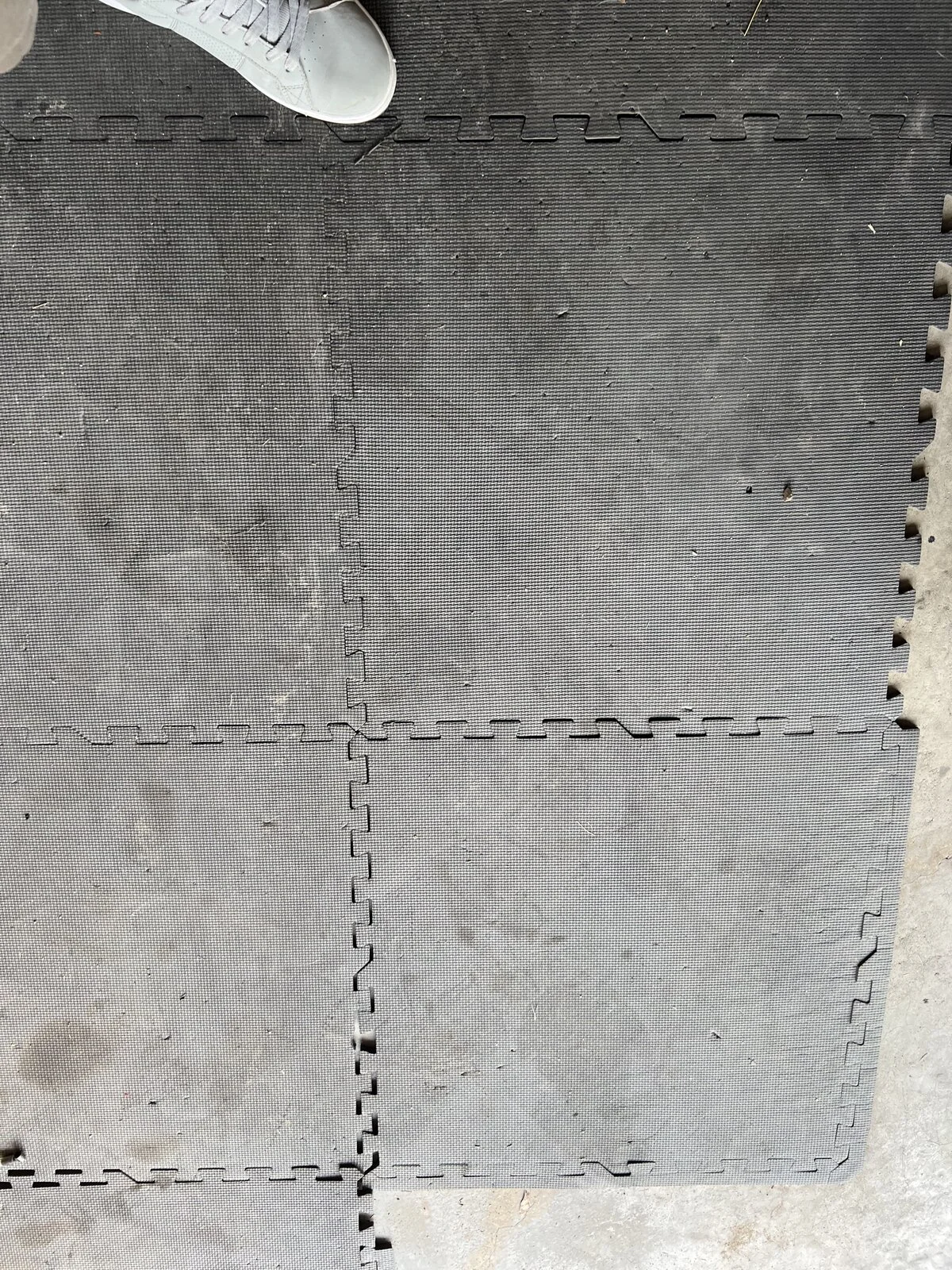

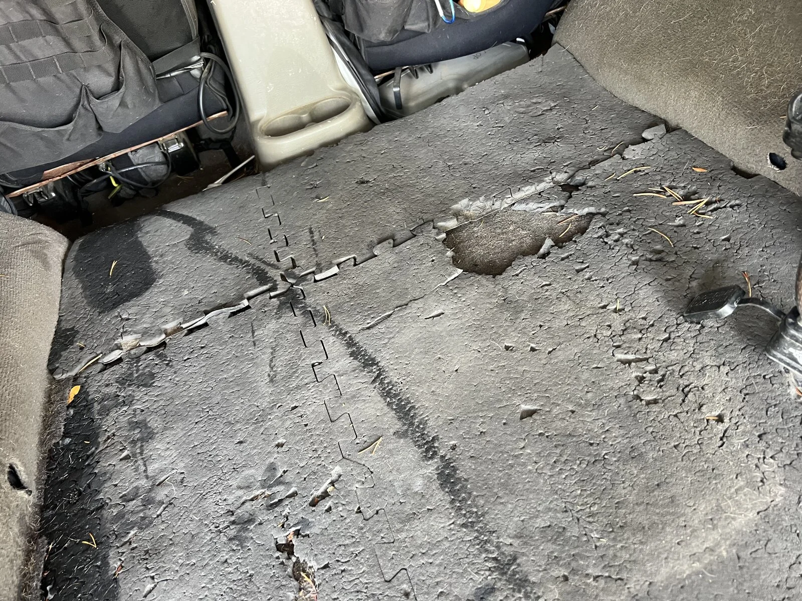

I have 150 pound of dogs that go everywhere with me. Been searching for a rear cargo pad that was easy to clean, waterproof and durable. Also wanted something a little thicker to protect dogs from getting slammed around while off road. Looked at Bedrug but didn't seem worth the price or sturdy enough to handle the dogs. Weather Tech made a good rubber mat but it didn't cover the full back. Couldn't find anything that covered full cargo area. I ended up buying some cheap Harbor freight flooring and cut it to fit. Cut out all hinges and everything to still accommodate rear seat. It worked pretty well for over a year but dogs eventually destroyed it.

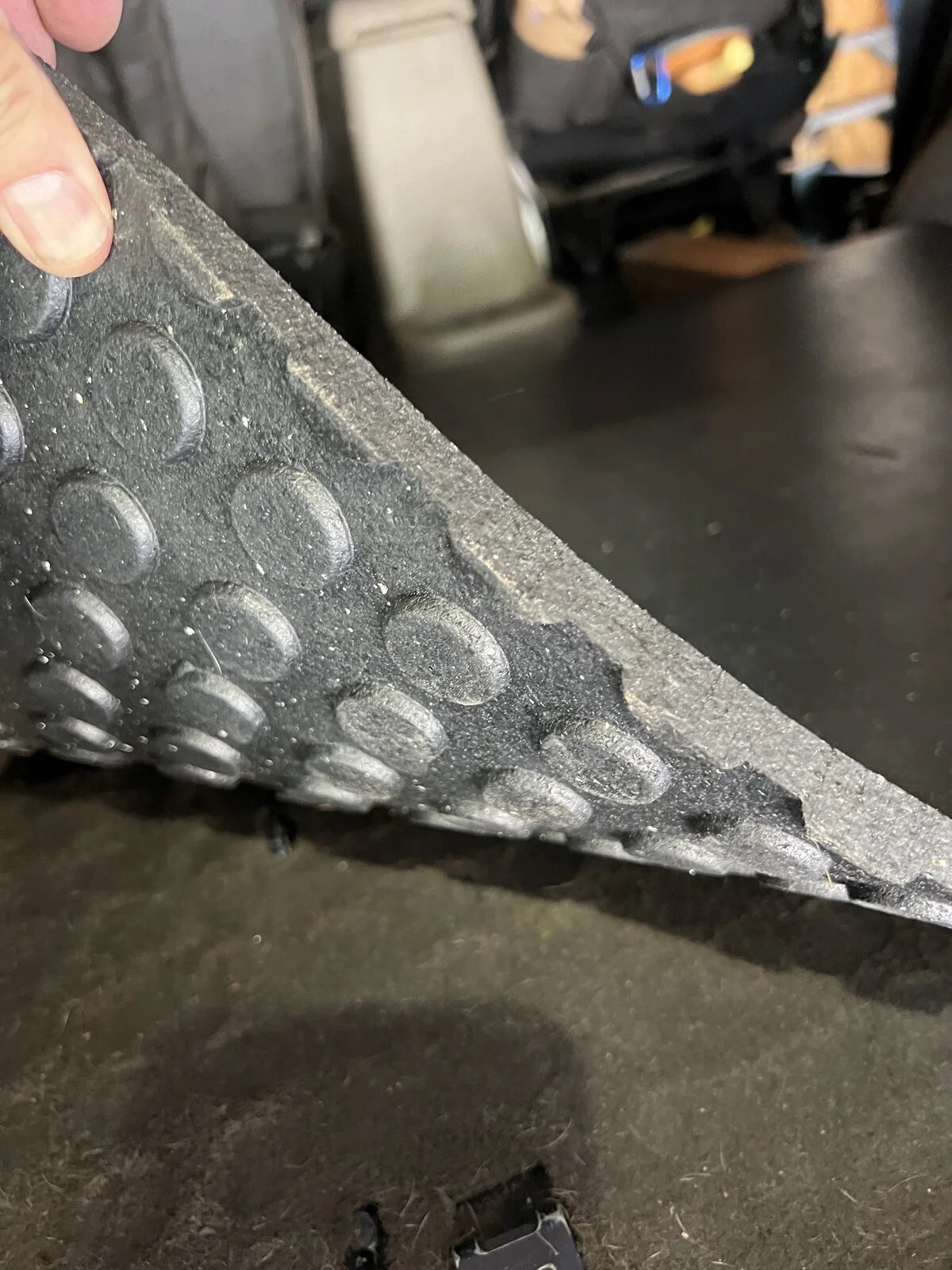

Been searching for large rubber mats and stumbled across 3/4" "horse stall mats" at Tractor Supply for $39. A razor blade and torch got me exactly what I've been looking for.
Cut it to fit. Wanted a little overhang to get water to run down to front seats, my front drain plugs are out. Took a torch and heated the ledge area to roll/mold the mat. Put some wood it to help brace it as it cooled. I never run a back seat so didn't bother notching out those areas this time. For $39 can't beat it. Was searching ideas on here before finding these. Hope it helps someone else out
