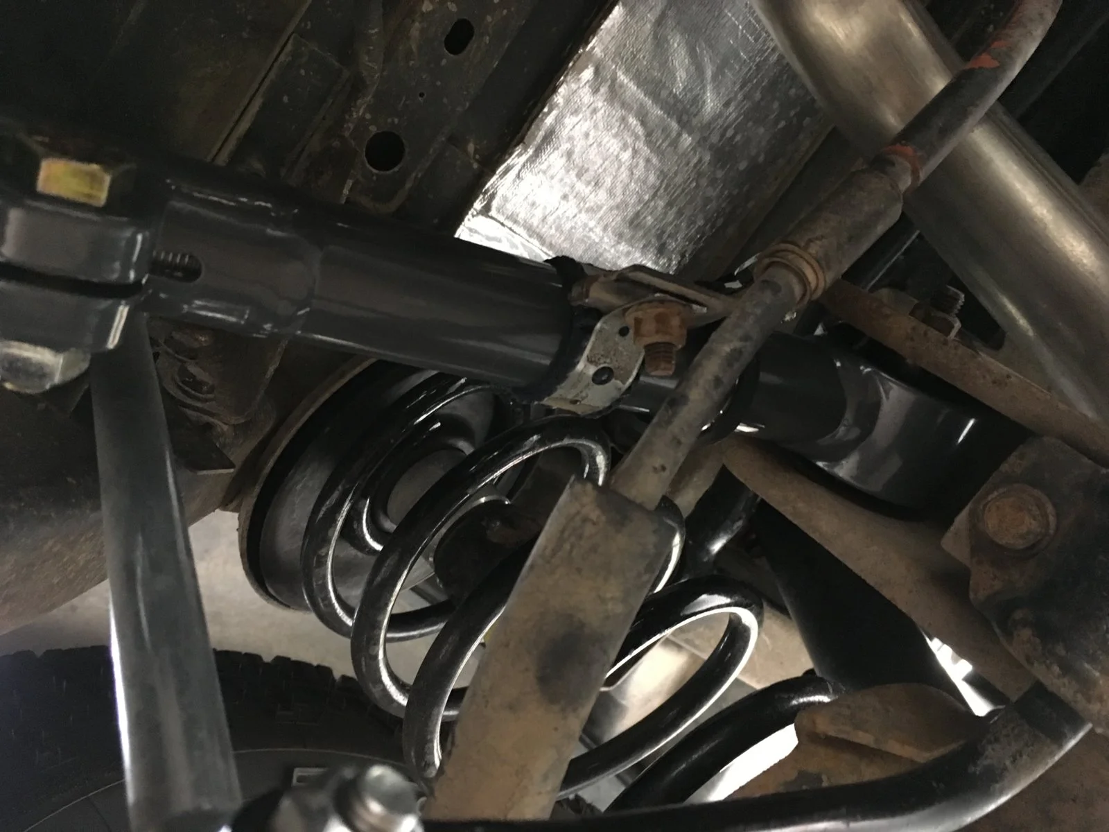

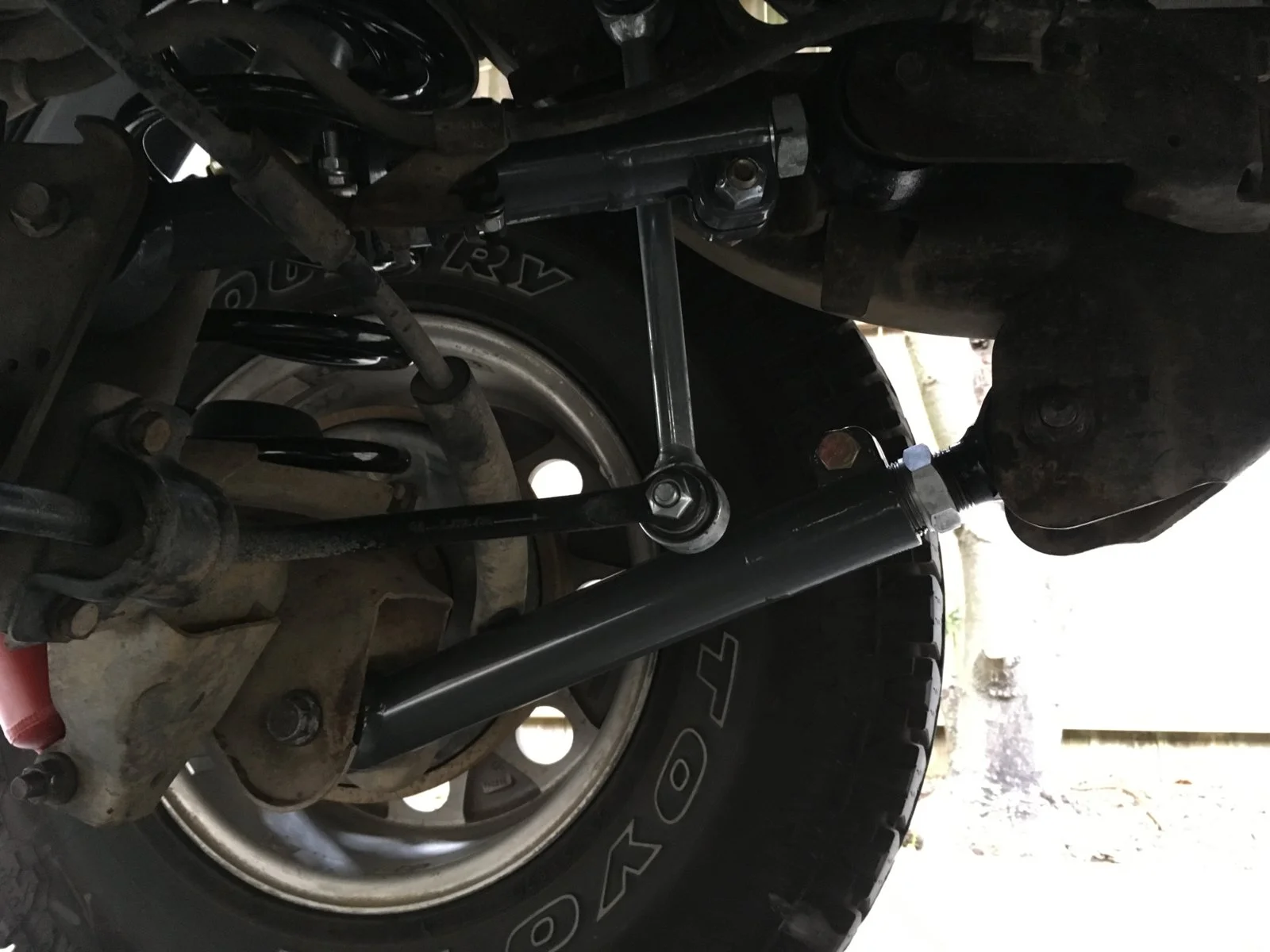

I made clamps to secure the OE brackets. When the pinion will be rolled upward I intend to remove the hard bracket(s), install longer brake hose, and secure with tie-wraps. I may or may not let the P-brake housing roam free.
Sorry, I don't have images of the clamps specifically, but they're sort of visible in the background.
View attachment 79573View attachment 79571View attachment 79572
I'm in the middle of installing adjustable control arms, and didn't anticipate that I'd have to do something with the rear brake brackets after the stock control arms came out. Looks like your simple mounting bracket does the job!
