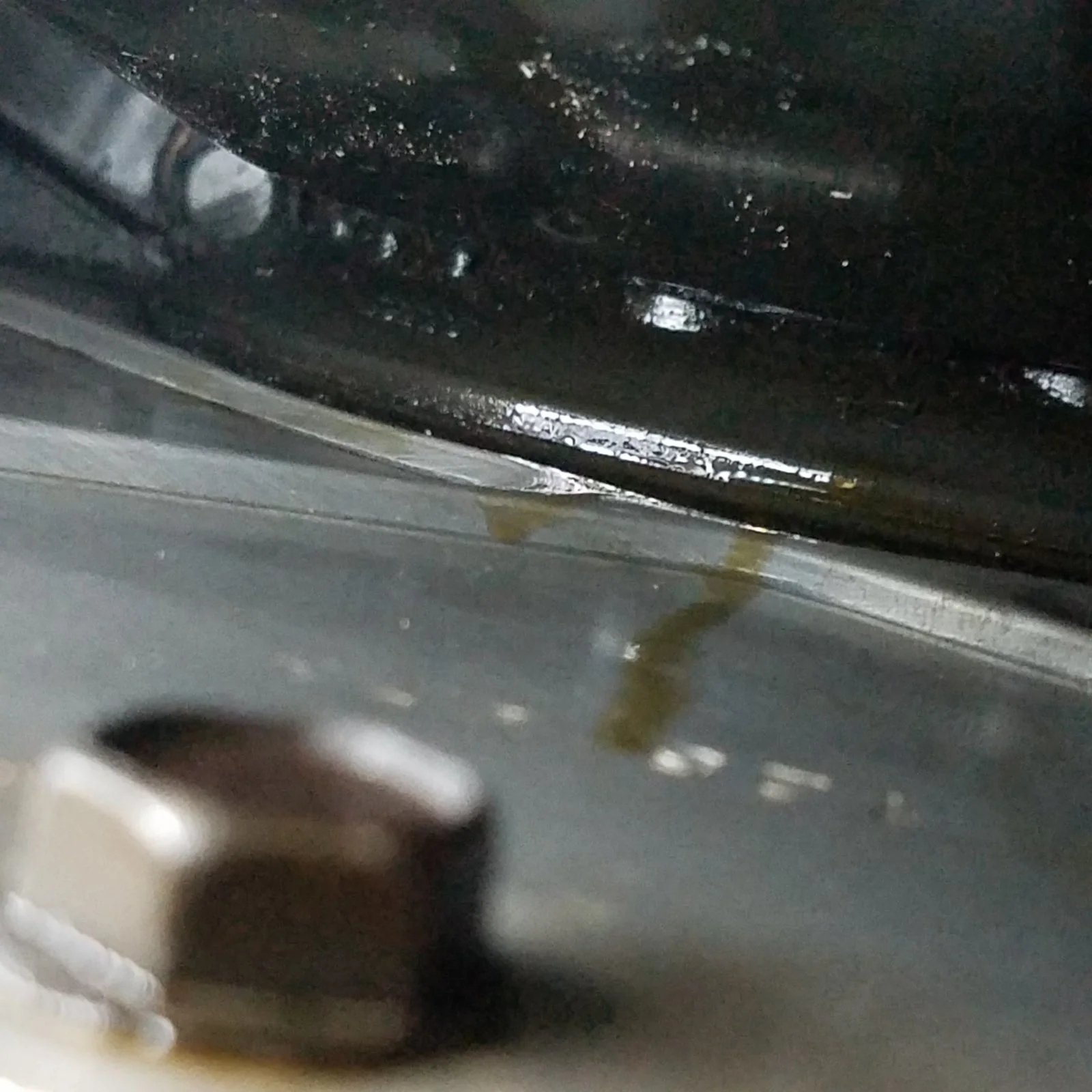

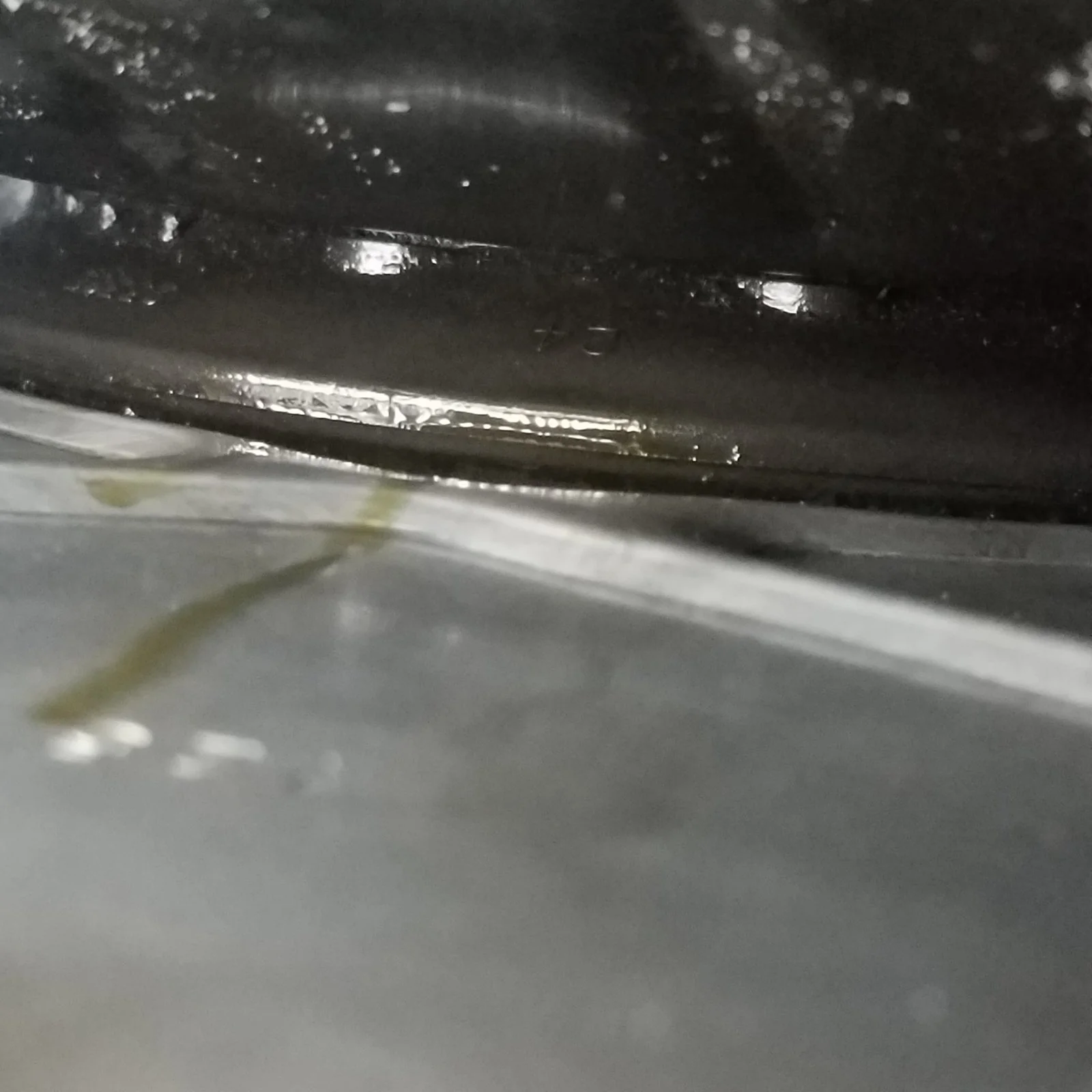

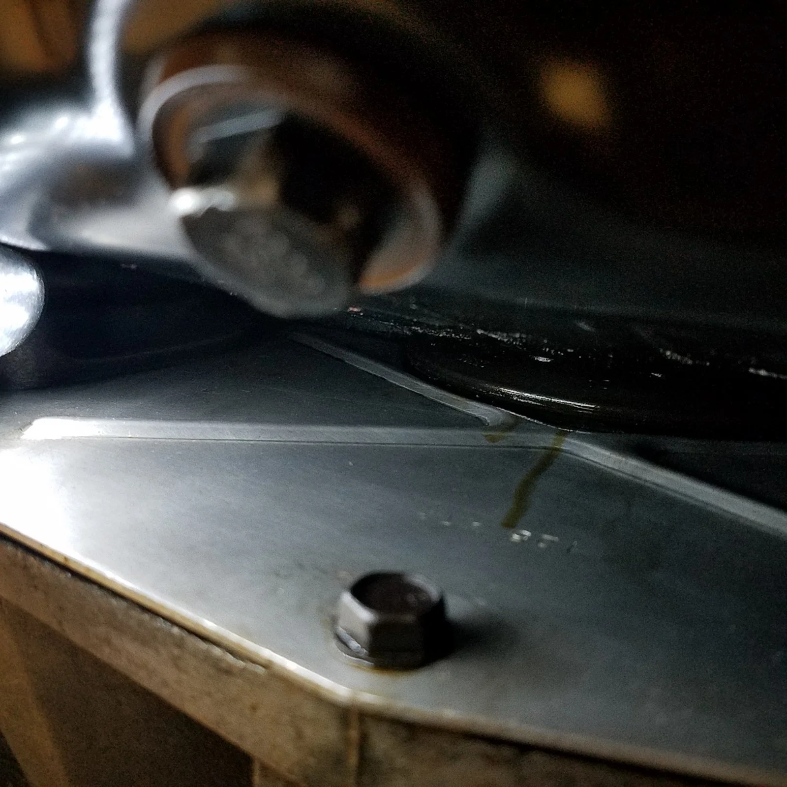

Is this what you are experiencing, in the pics? I assume this is my RMS leaking, and I did have a slow leak from there, but I recntly did an oil change and now it's dripping a little more than before the oil change.
I also have a 2005, so this may be a job for Frank, my local mechanic. Removing the pre cats to drop the pan, on top of everything else will be a huge event for me, and potentially out of my league.

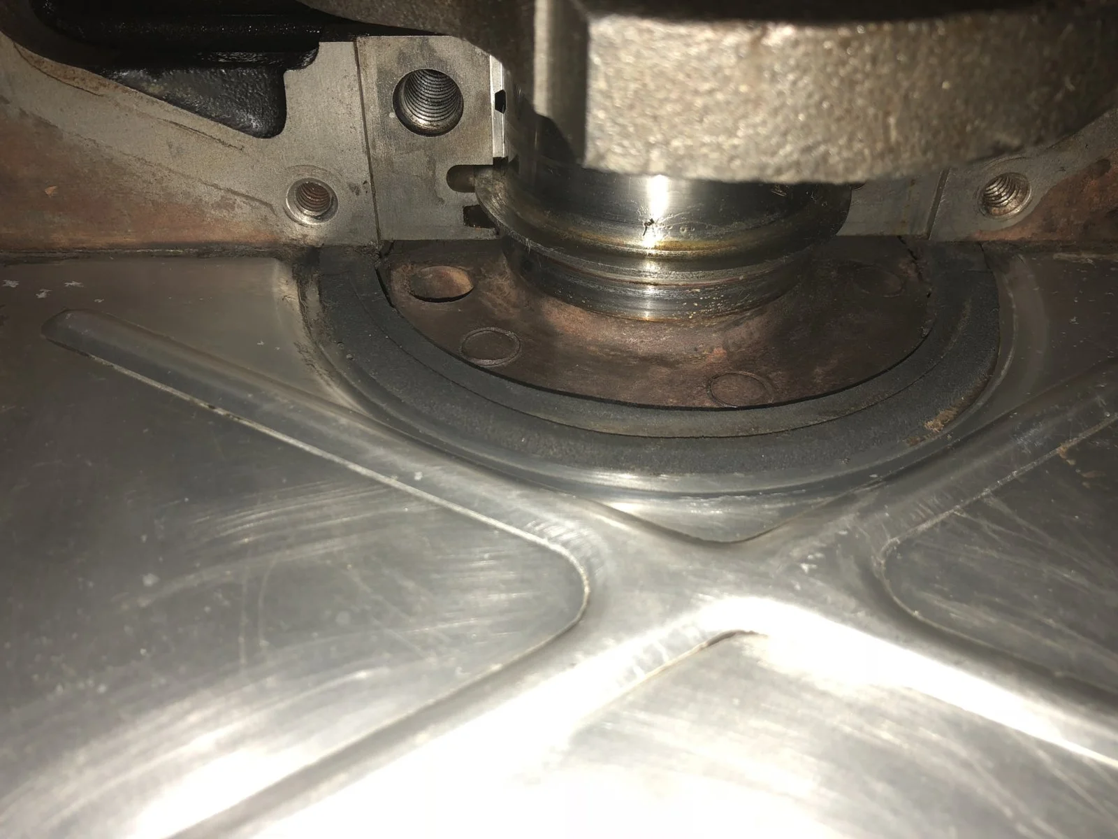

1st-time poster, but have been a long-time stalker and this my third jeep (CJ, YJ and now 05 Tj 4.0 I6). I have been coming here for years for help, so thank you all. First of all, Chris thank you for the write-up on this RMS. This along with other posts, prayers and videos helped me prepare and complete this. I'll be completely honest...this was a huge PITA and I turned into my dad growing up using many different word combinations and screaming into the air or anything I could look at. Even my animals were staying clear. This is the day after and I am bruised, bloody and popping Advil. On my 2005 removing the exhaust was probably my biggest pain. All the bolts came off ok because I was actually re-doing myself a paid RMS failed fix from a shop that has been pouring out worse than when I took it in.
I would say that the 1st rule of this would be to have a second person around for some things. Gravity works wonders getting things off but putting them back on is pretty tough at times without being creative. Dropping the skid plate was a pain as well. As it drops the transmission a little, I had a jack and a piece of wood lightly hold it in place. That movement scared me. I didn’t know any other way to get the exhaust off without removing the skid and I wasn’t about to cut. I never understood what everyone was talking about with the top RMS tearing at the lip until I tore (shaved) two of them. Luckily I ordered backups but that leverage sucked as well so I recommend removing the clutch dust shield for that better angle. That little piece of Plastic that FelPro sends does help a lot.
I don’t know who out there has these long skinny rubber arms but I just simply could not succeed with getting the exhaust back on the manifold. At this point I was on my 10th hour and I just simply gave up with 1 bolt attached on each and will take it into a shop that has more leverage to get in there.
One thing also is that everyone says is to spray/soak those exhaust bolts the night before for removal ease…Well prepare for some foul-smelling smoke for a while. All done, and no leaks at all for once in 10 years but It honestly doesn’t feel satisfying. All that time and blood just for two tiny pieces of rubber kind of ticks me off..The funny ending (not at the time) is that after everything was back on...my jack was stuck all the way extended.
