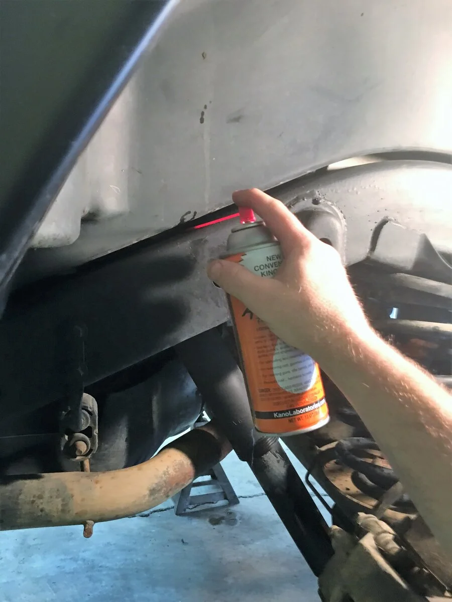

As other said, spay upper bolts with Kroil. When going to install new ones, leave one upper bolt in place. It will be much easier to install the shock.
I did my shocks earlier this summer and I live in a rust belt. If you remove the rear wheel liners you can get in there to soak them down from above. I used 10 inch extensions to reach them. A universal joint style adapter (struggling to remember the exact name of it) might help you get a good seat on them as well.

You can actually get in between the frame and wheel well liner if your penetrating oil of choice has one of those straws with it. I did it that was when I installed my lift. Shining a flashlight in the area helps with being able to see where the end of your straw is pointed.
