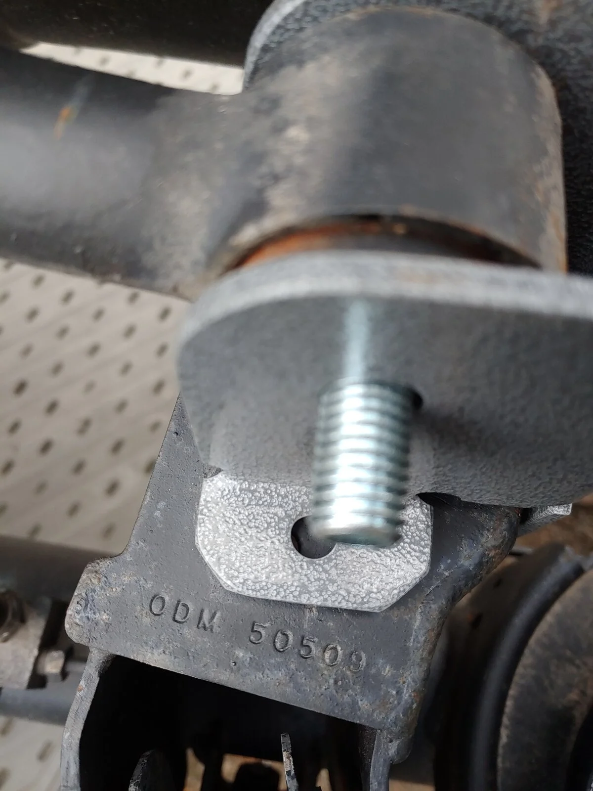

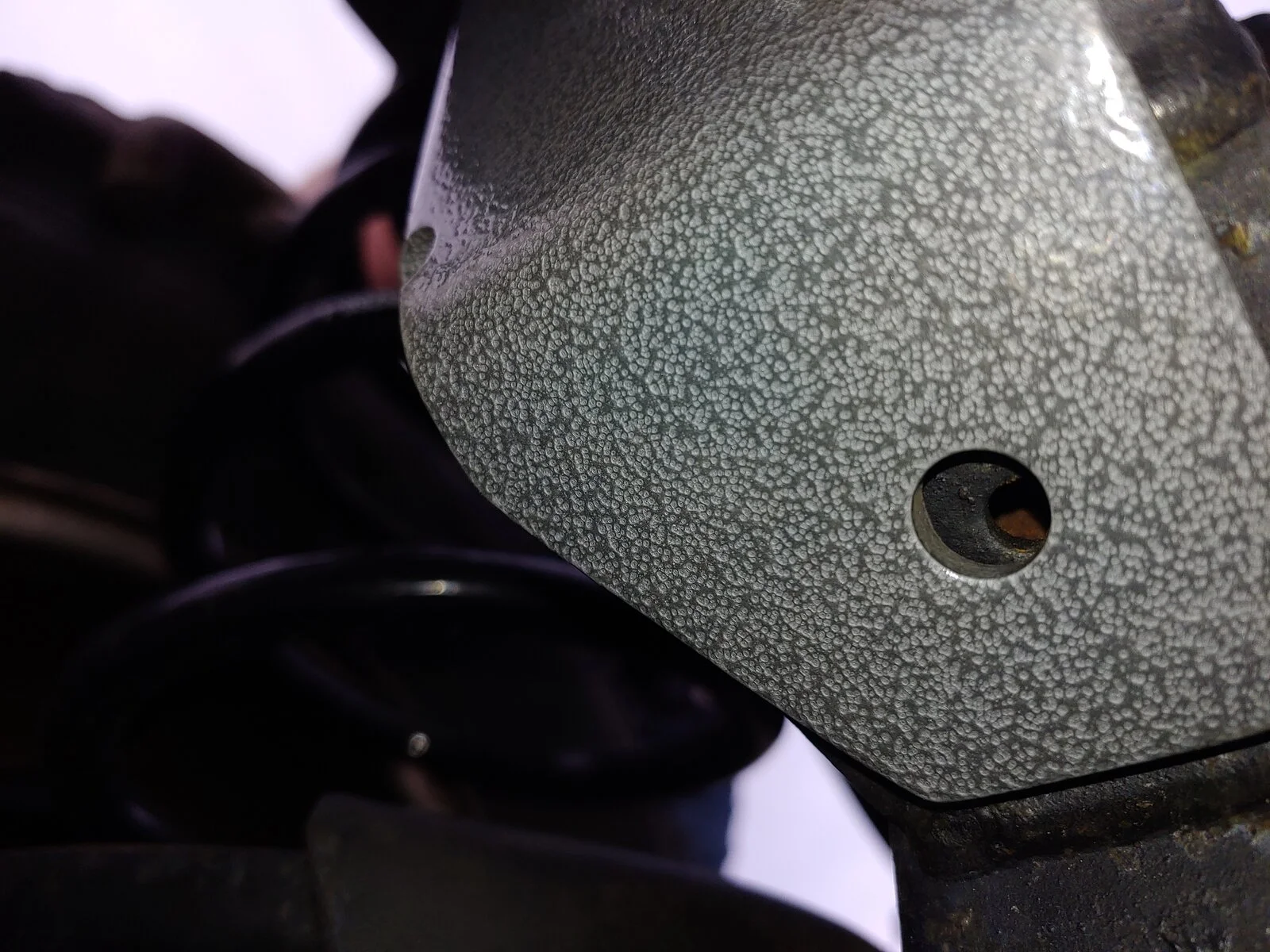

Hey guys, need some help. Do you know if the rear track bar relocation bracket for a 2inch lift should need extra work to make it fit? I order the bracket from Morris 4x4 part no. WAR800007. It looks holes are not in the right place.
I decided to live with my rear axle being slightly off center. I had to jump up and down on the rear bumper in order to get the TB bolt in, but it's been fine (no interference). Another option if you don't want to drill is to buy an adjustable TB. Make sure you check for interference with either method.
