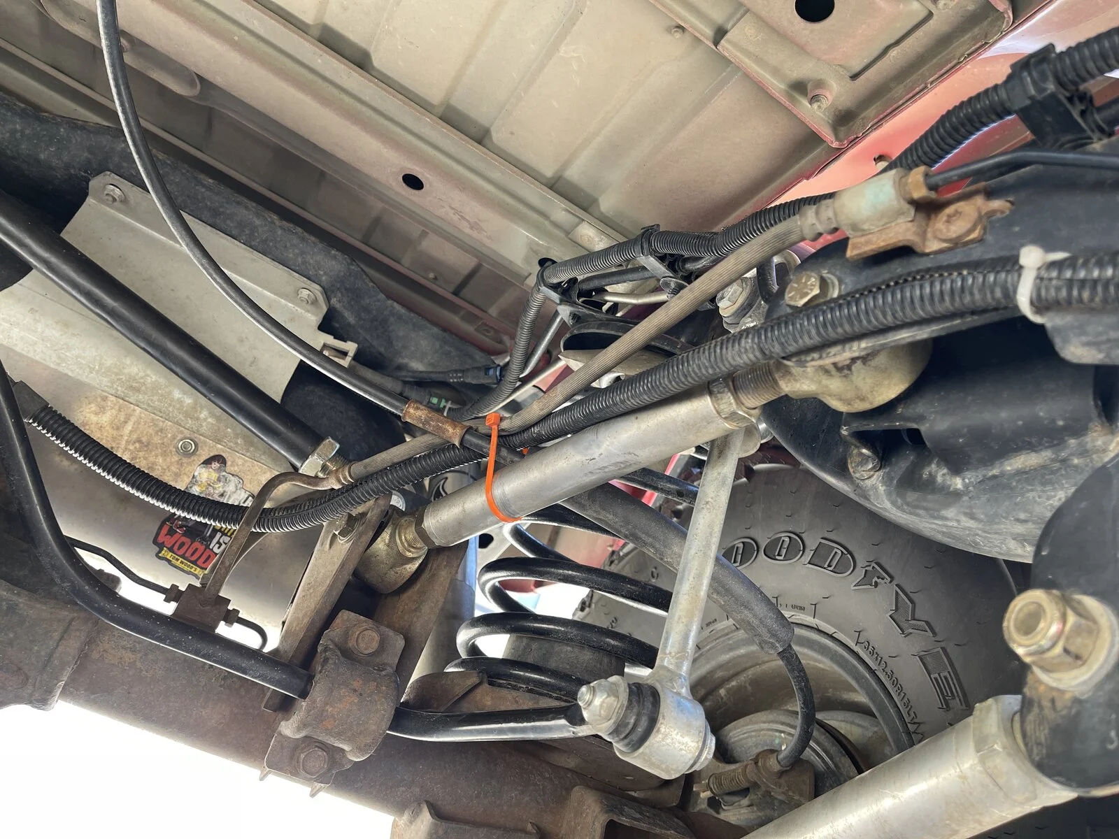

Getting ready to install my rear upper savvy arms, but am wondering what to do about mounting the brake line and parking brake lines that are attached to the original control arms. What has everyone’s solution been? Thanks guys

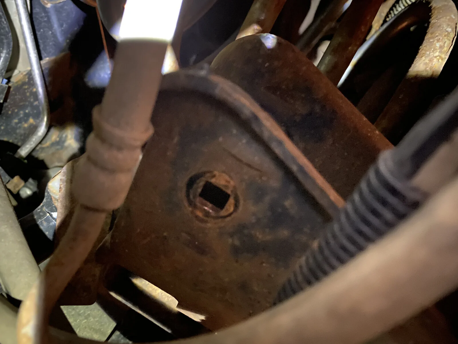

So another question. Was size do I need to drill the holes for the new savvy bolts? Just took an arm off and realized the new bolts dont go into the factory holes
Thanks for all help guys! Got both rear uppers in and pinion adjusted. Completed my savvy arm set now. Drilling the mounting hole for the passenger side frame bigger was fun with the big ass factory exhaust in the way.
