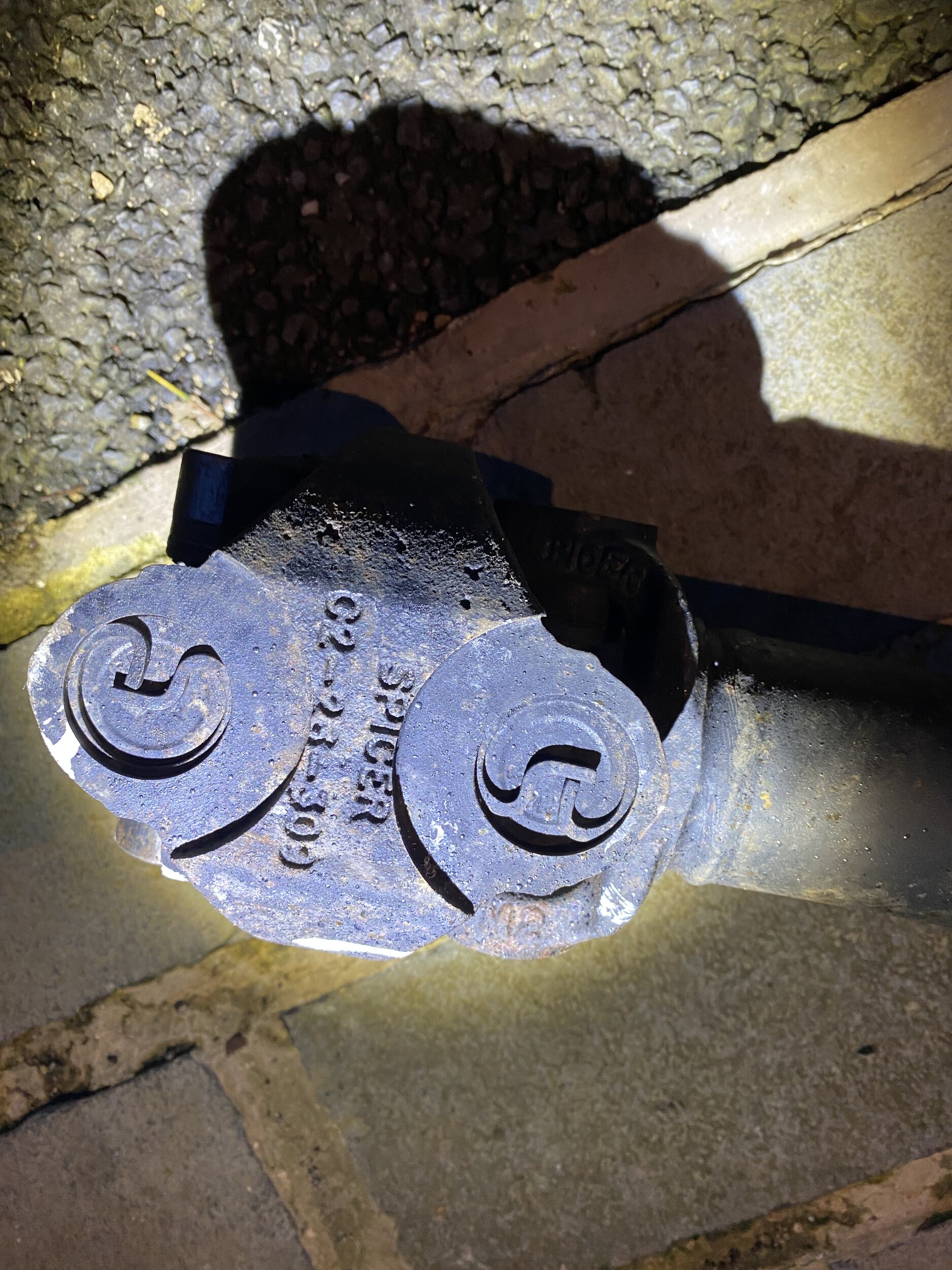

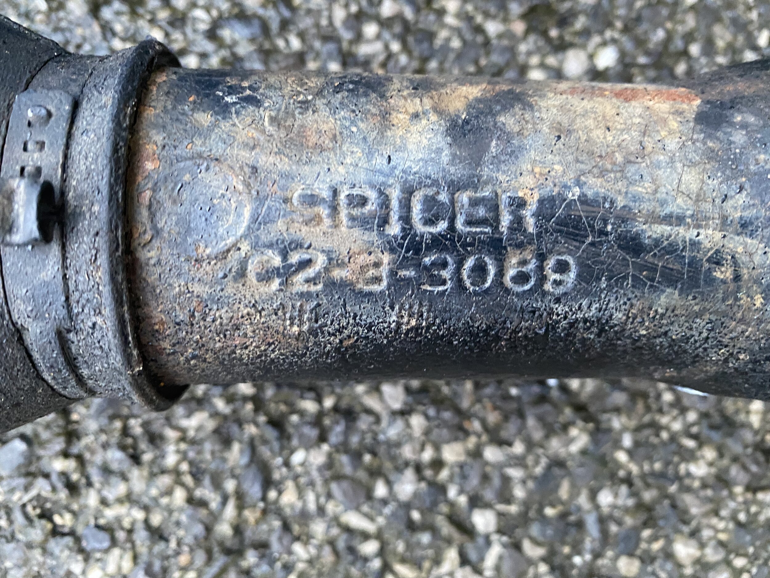

So in trying to stop the massive vibrations i have been having I put 1/2 case drop which have been great on my last tj autos.still vibrating,found a loose uj on the front of my front prop shaft the plastic seal thing on the bearing cups had broken away so allowing movement so I took the prop off and it’s greatly improved things.i have inspected uj,s on the rest of the front and rear props and a lot off them have cracks in the plastic seals on the cups.
The front prop seems to be a spicer unit my question is would you rebuild these props with new uj’s or just buy new aftermarket prop shafts I will be doing little to no off roading in this jeep?
