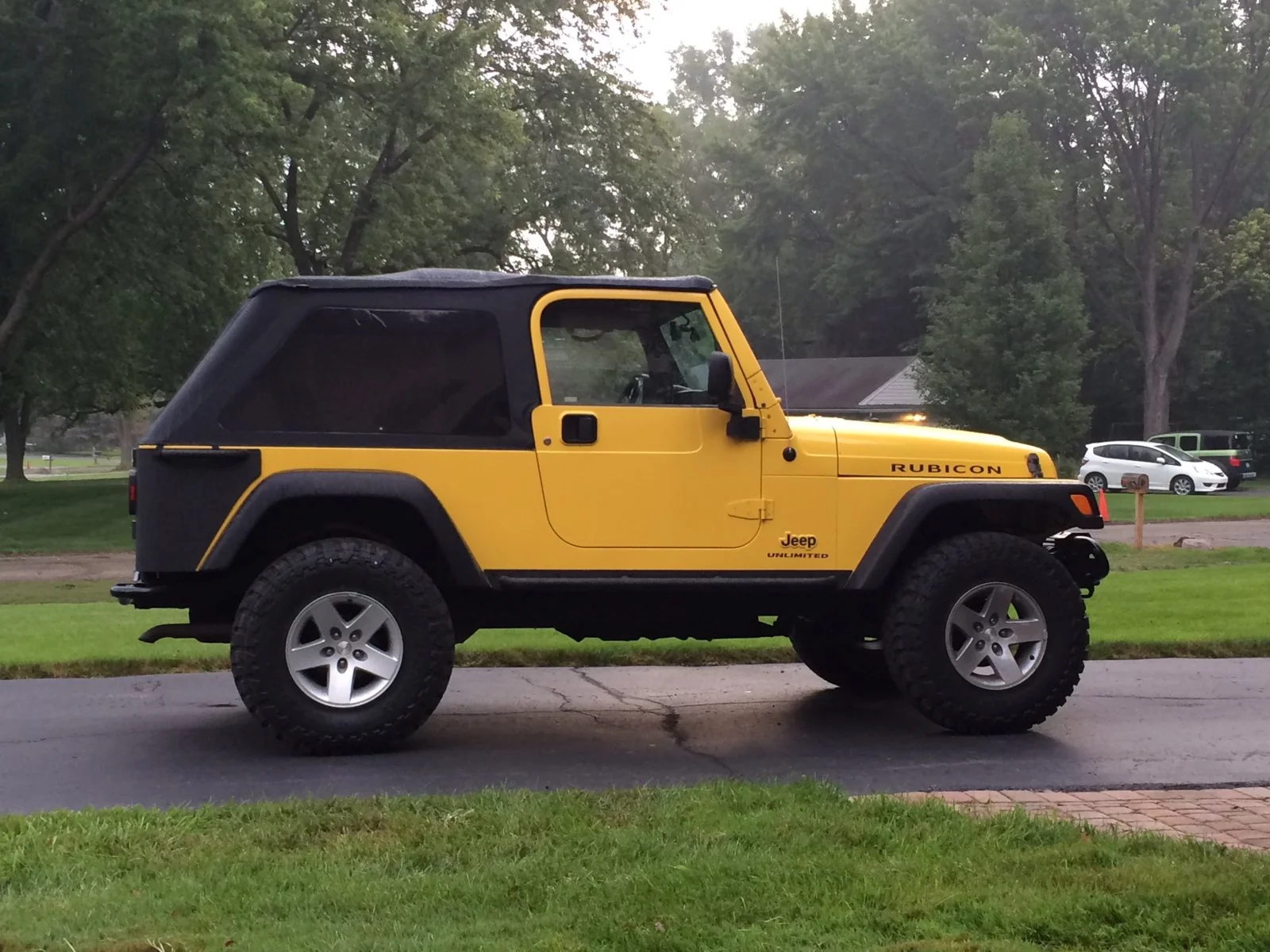

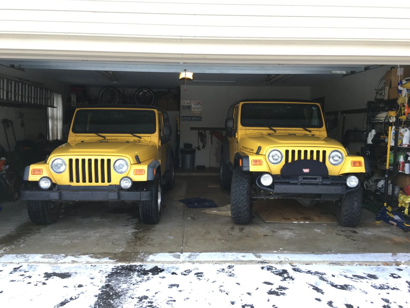

You definitely can't go wrong with the Currie lift. Another route is to consider the 2 1/2" OME lift (DGP Offroad sells a complete kit) and possible augmenting it with a 1" body lift. This will give you the height you're looking at for 33's but you won't have to be as concerned with the driveline angle causing vibrations. Here's my '05 LJ with that exact setup. For comparisons sake the second picture is my '05 LJ next to my daughter's stock '04 LJ.

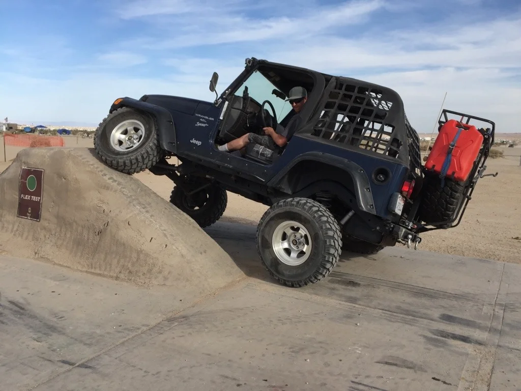

While I do love my Rubicon Express 4.5 lift, the springs suck. They come out of the buckets almost all the way at full flex and the front has sagged about an inch over the last year. I'm going to be upgrading to metal cloak dual rate springs in a few months. I got the whole lift for dirt cheap so I'm not too upset. I would go Metal Cloak or Currie in the future. She does flex pretty good for a short arm kit.

While I do love my Rubicon Express 4.5 lift, the springs suck. They come out of the buckets almost all the way at full flex and the front has sagged about an inch over the last year. I'm going to be upgrading to metal cloak dual rate springs in a few months. I got the whole lift for dirt cheap so I'm not too upset. I would go Metal Cloak or Currie in the future. She does flex pretty good for a short arm kit. View attachment 3891
Nice looking TJ, I know right where that photo was taken. One thing I'd suggest are taller bump stops for the front axles. Your front tire is stuffed too far up into the fender where there are several really sharp objects located. :)
Thanks.
I think it just looks like it's stuffed up really far because of the fender flares. The come down from the fender edge a lot. Nothing rubs at all at full flex very surprising when you look at it. I have a 1 1/4 body lift and a 1 inch motor mounts (thanks again Chris!) that I'm going to put on after I get my TT skid. Plus I want some type of tube fender in the future.
