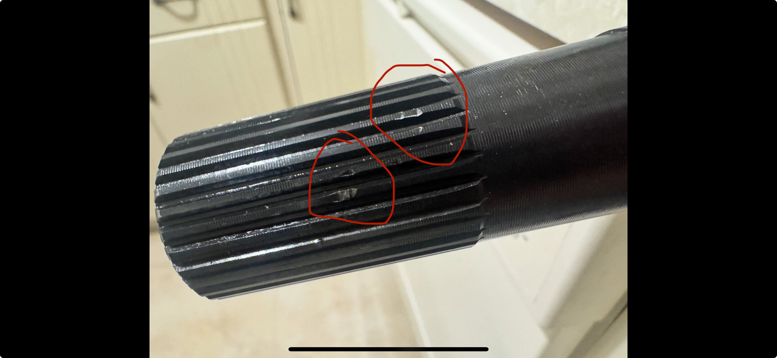

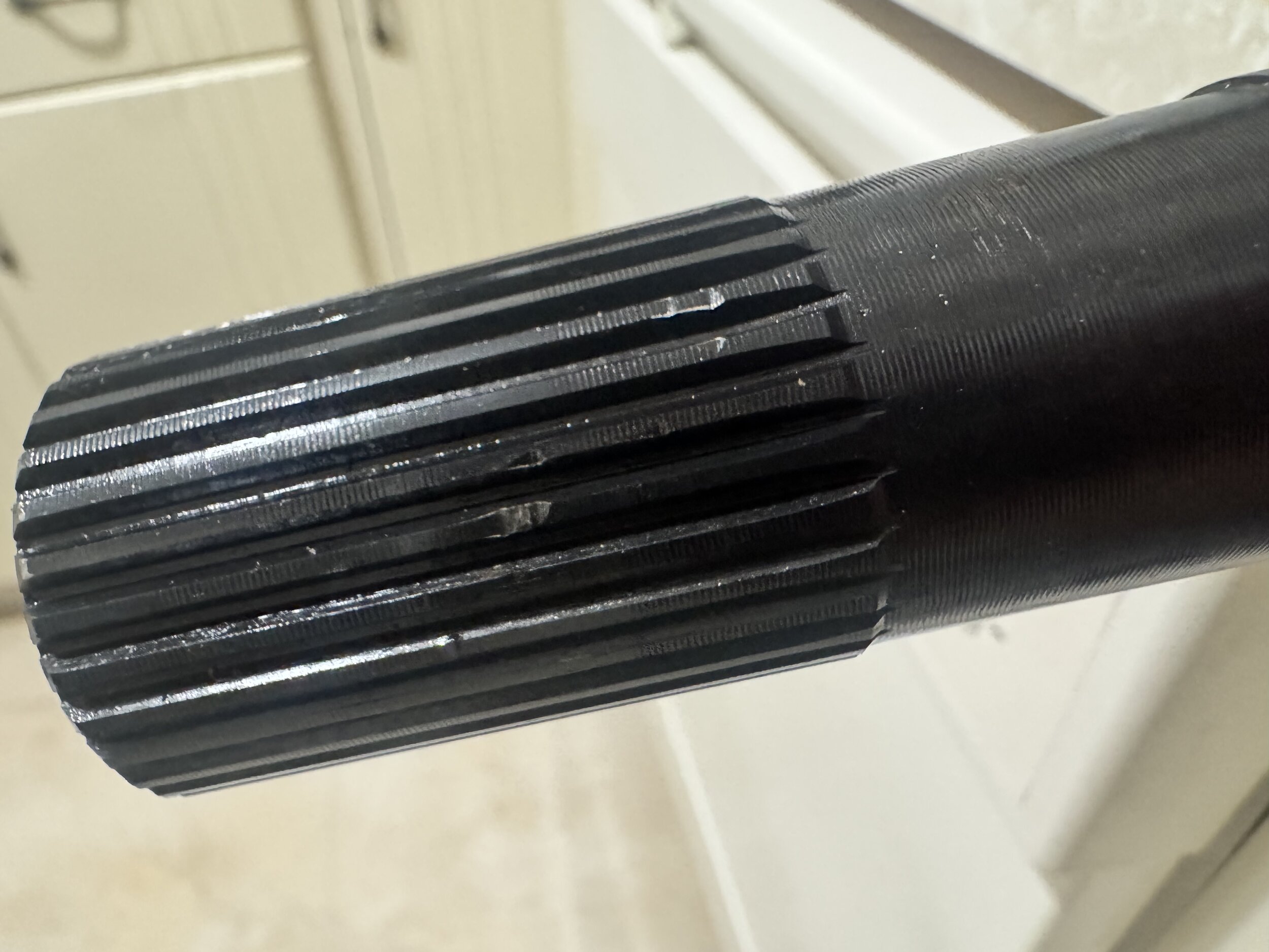

Hey everyone, I just got my revolution discovery series rear shafts in the mail today and it looks like some of the splines are nicked.
I’ve never bought a set of brand new axle shafts so i’m not sure if this or normal or not. Do you guys think it’s fine or should I call revolution about this? Thanks

The one on the right is fine. The one on the left will probably bind on the splines in the carrier side gear and make it hard to slide in fully. It won't hurt anything if it goes in the correct distance. I'd slide it in, if it fights you, make the call.
Would a quick fix be to take a file to it?

thanks guys, I'll give it a shot before i go bugging them.
