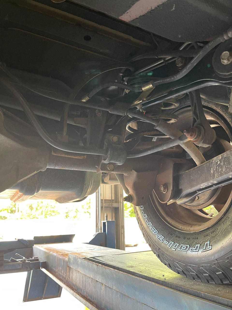

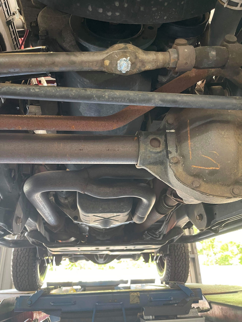

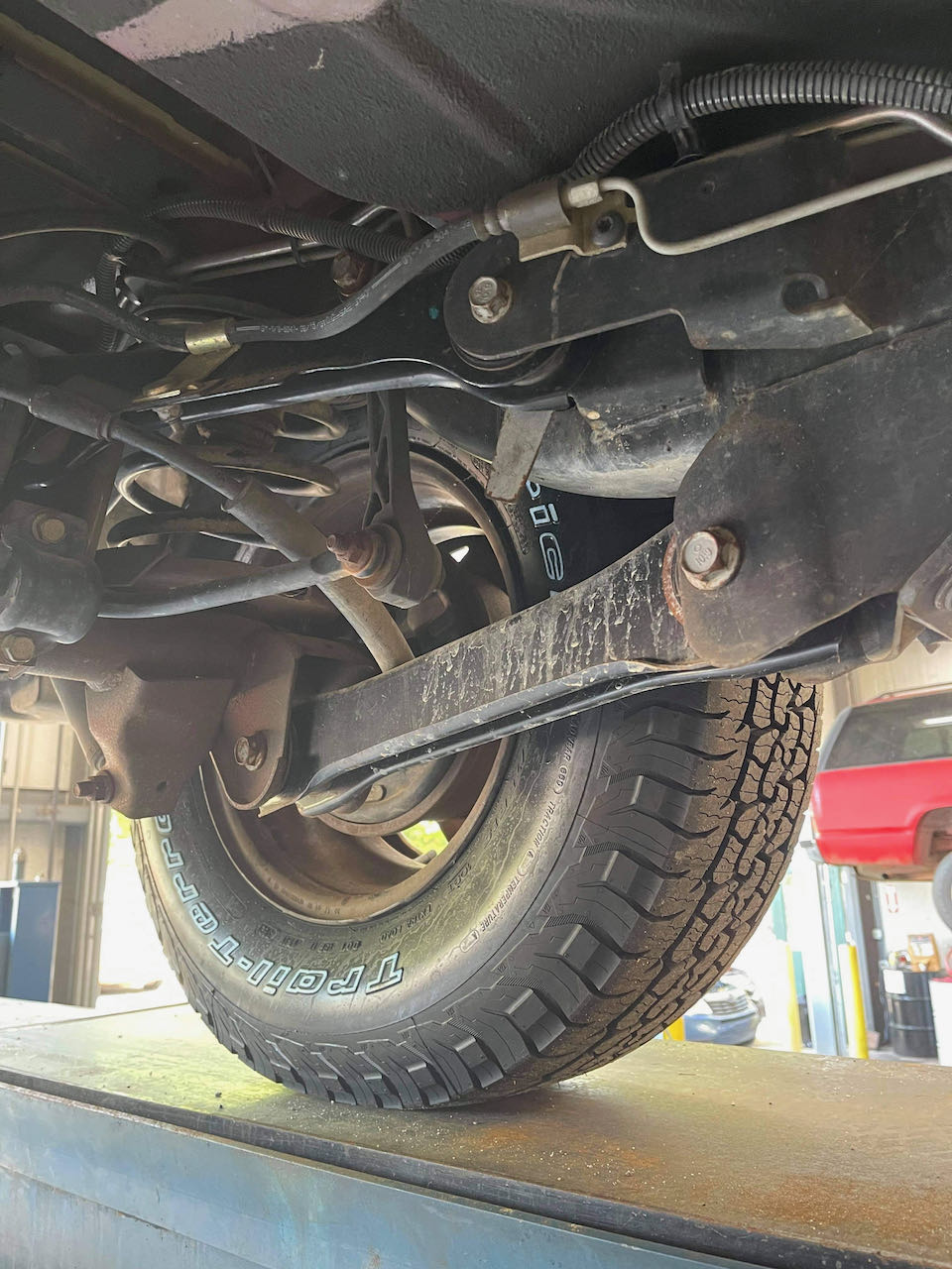

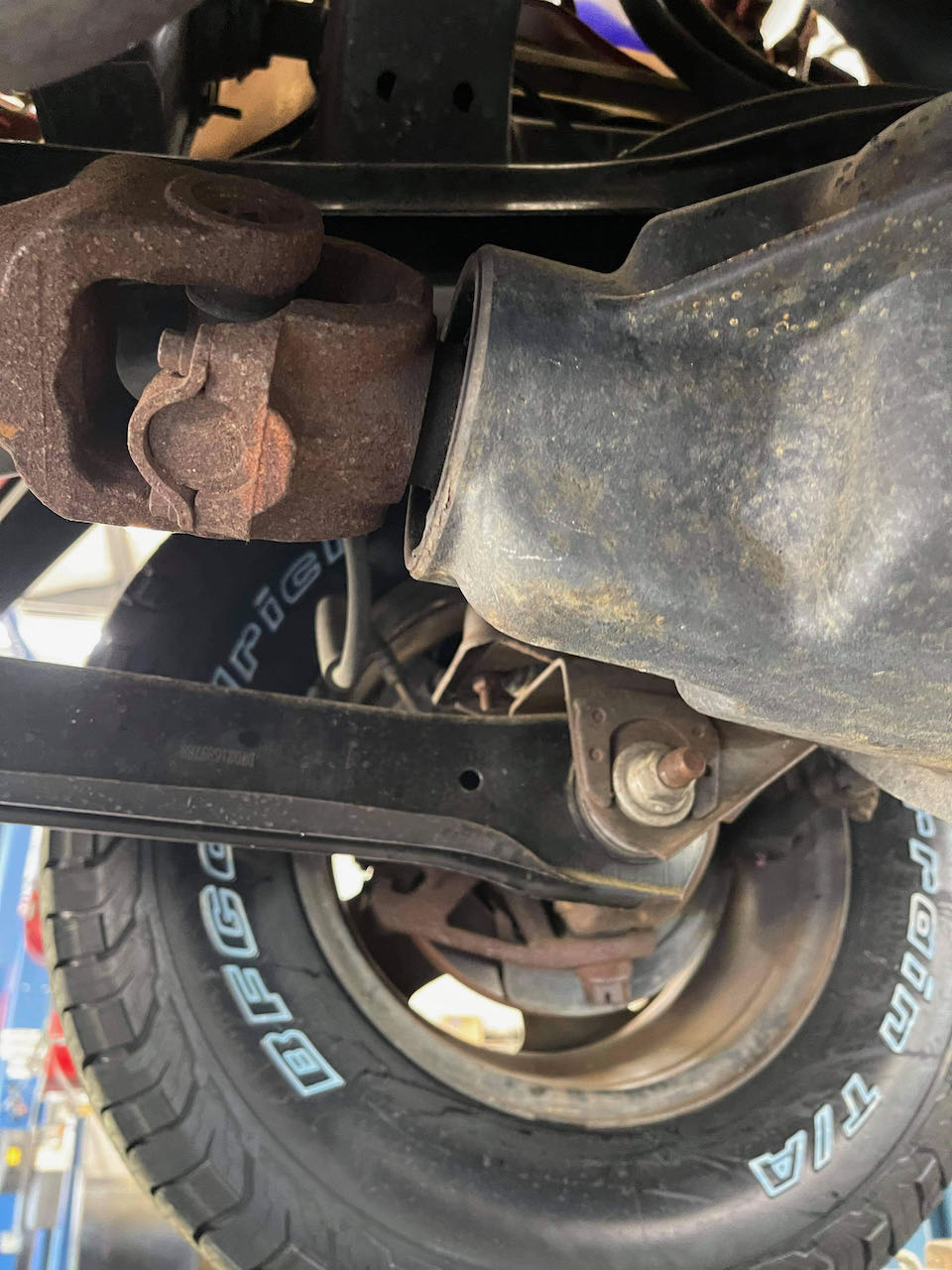

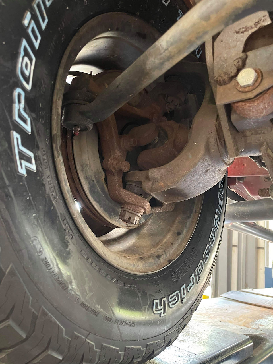

  • Mechanic agreed Jeep was in good shape (aside from known shock, brakes, and steering leak ) moving my lift up the priority list and an excuse to get some Black Magic

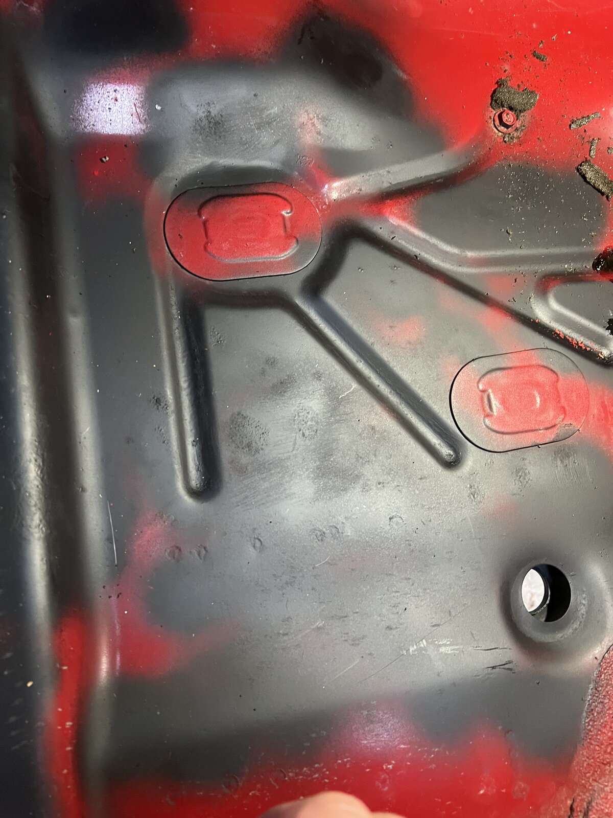

  • Wire wheel and rust reformer the passenger floor pan

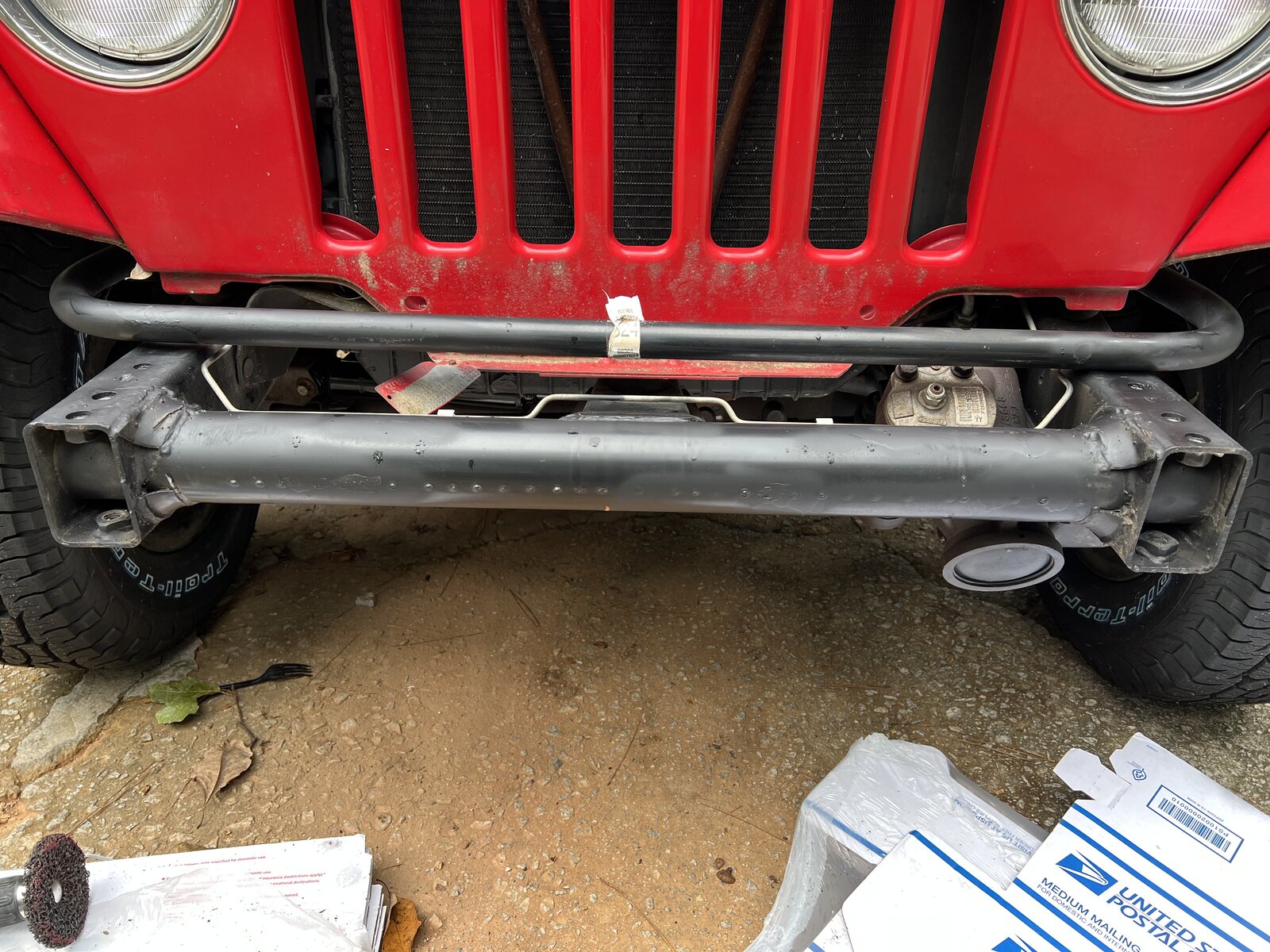

  • Pulled and sold the old winch and bumper

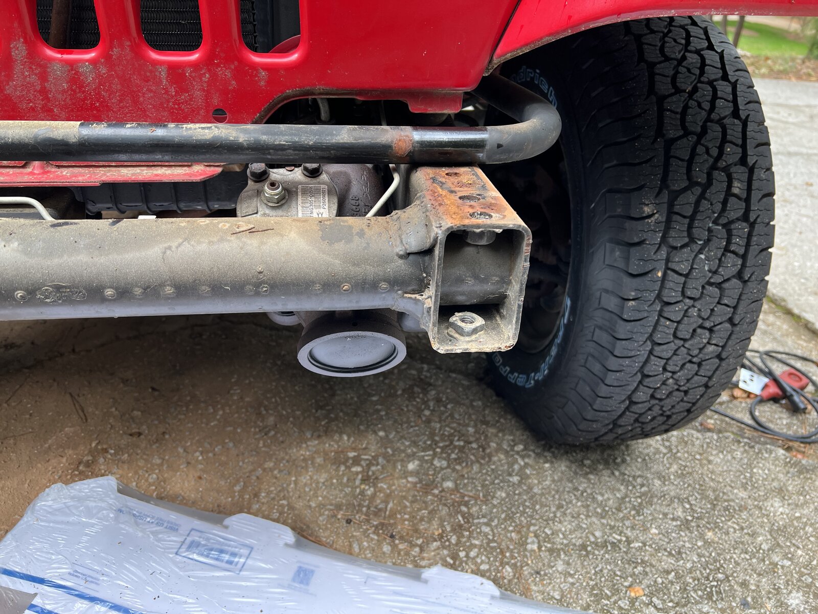

  • Wire wheel and rust reformer the frame mounts under the old bumper and the sway bar clamps
  • Installed new sway bar bushings and original bumper

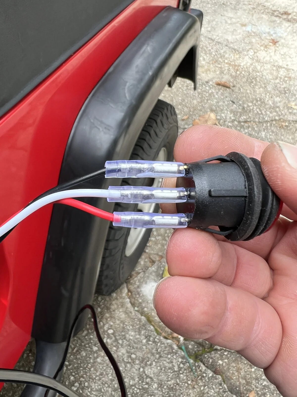

Learn how to wire a relay for the fogs

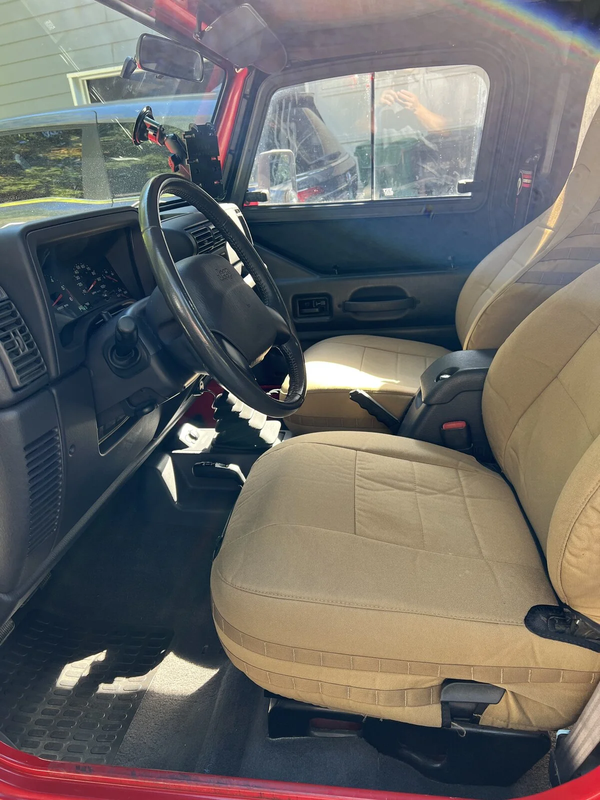

Bartacts back in. I miss my spice interior but the Black and Tan is growing in me.

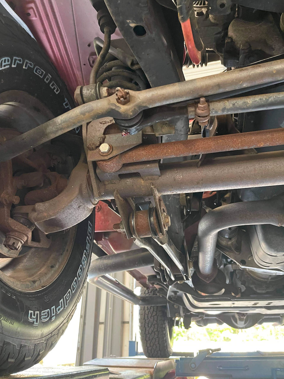

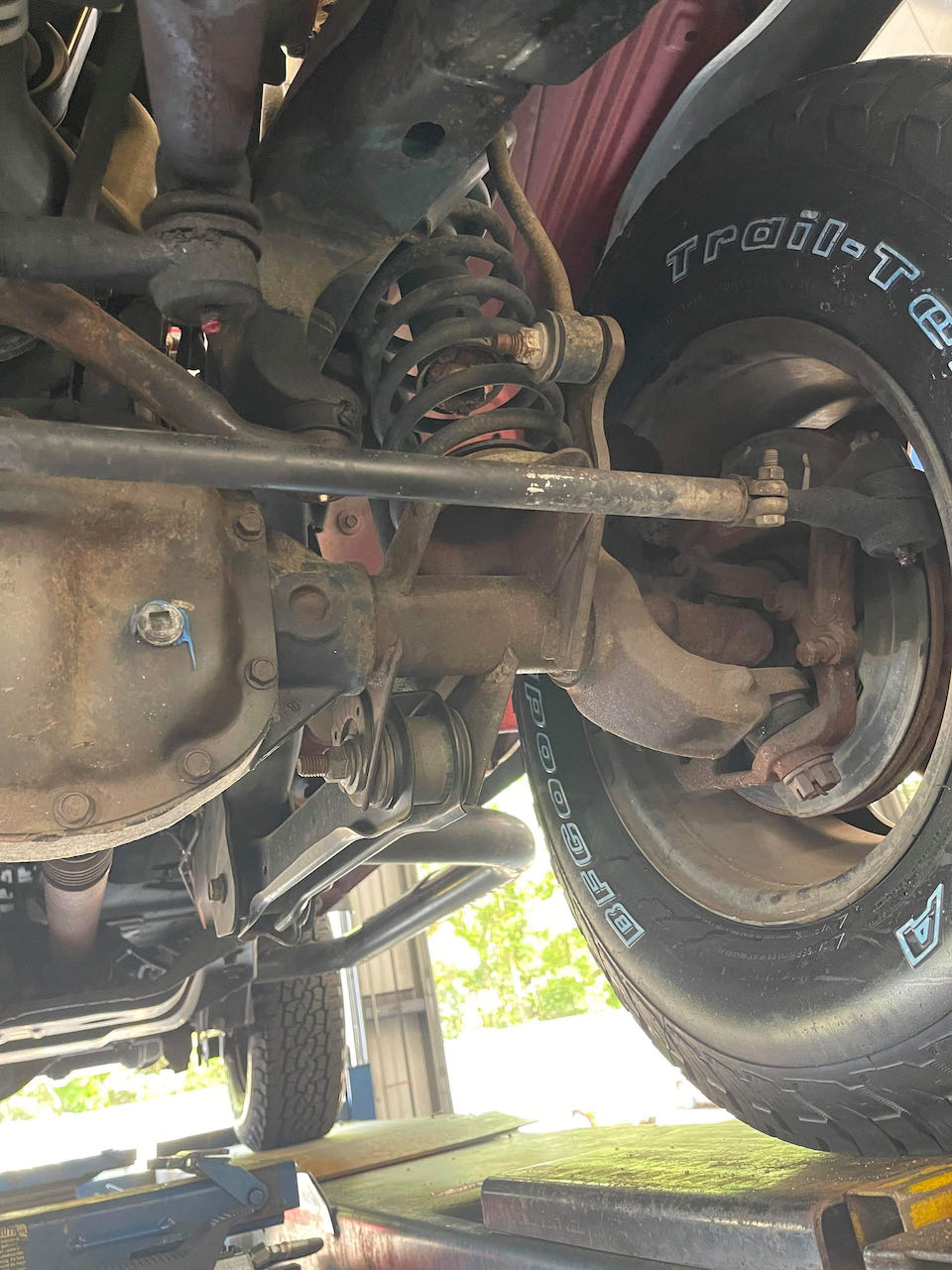

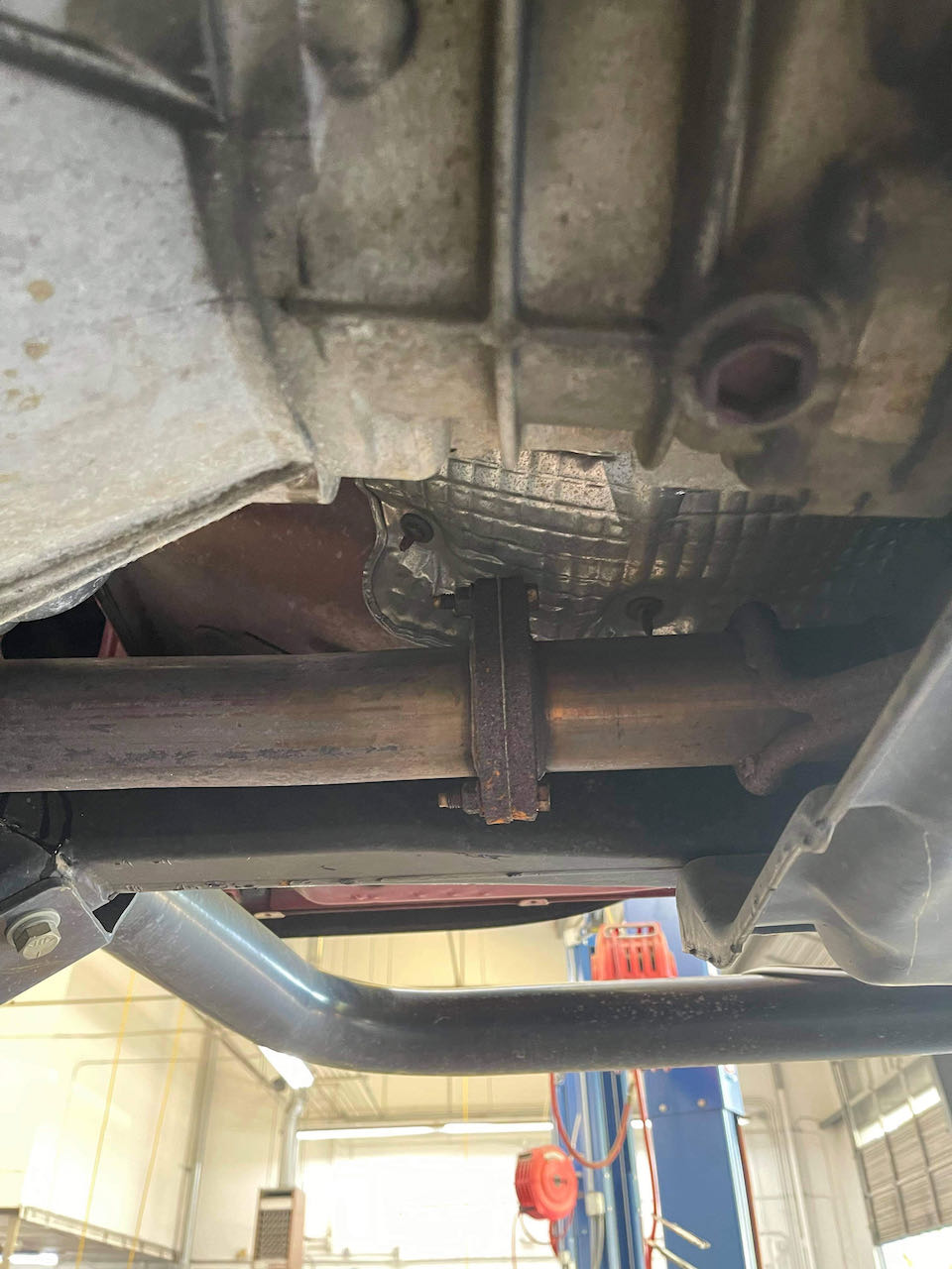

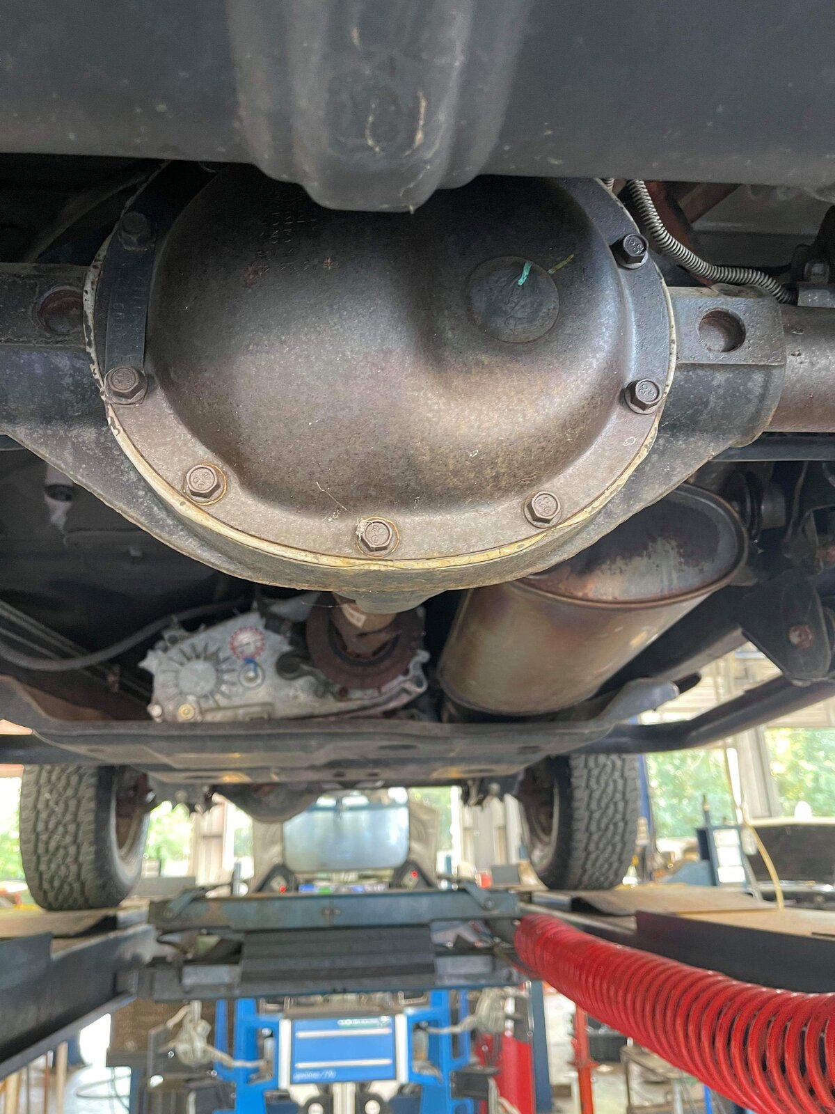

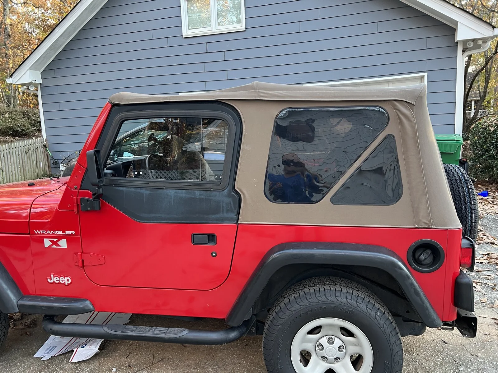

Lucked into this divorce find as a replacement for my wrecked 02. PO is a master mechanic in a small town between GA/SC (No rust or salt) In 2006 while going through a divorce he titled it to his father where aside from maintenance it's essentially been garged since then. 2002 Flame Red, 4.0 5psd, 3.73, and 33k on the clock. Bone Stock with the exception of front bumper, rear hitch, newer soft top, radio, and new tires as of this week. Pics as it is today and looking forward to documenting its build.

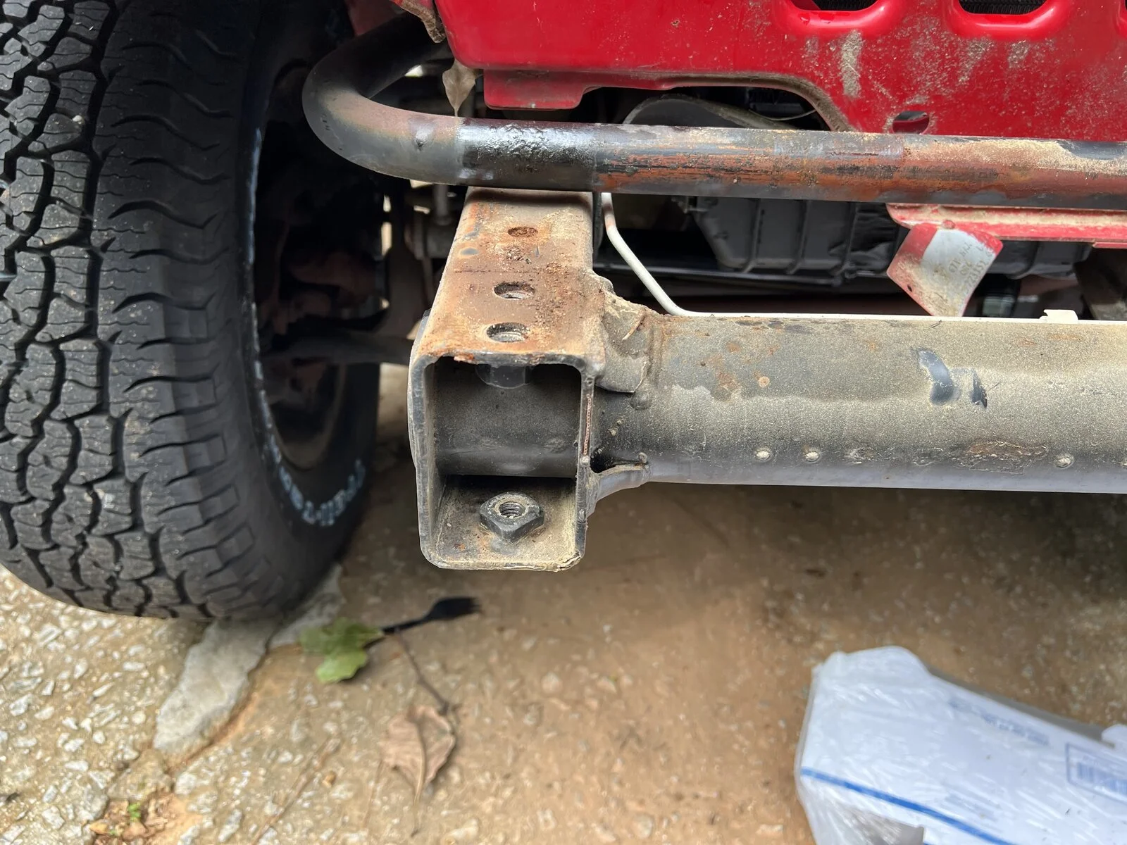

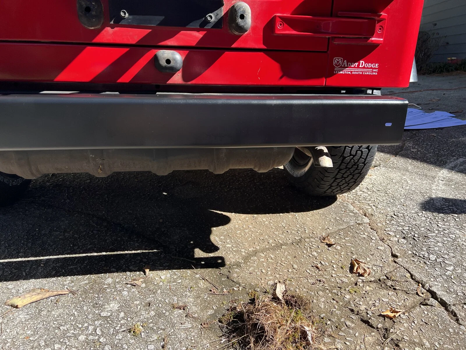

  • Pulled the rear hitch

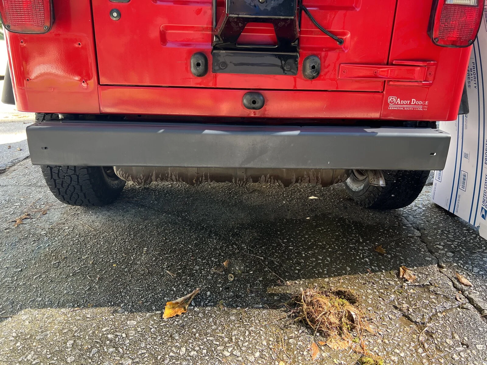

  • Painted the back bumper

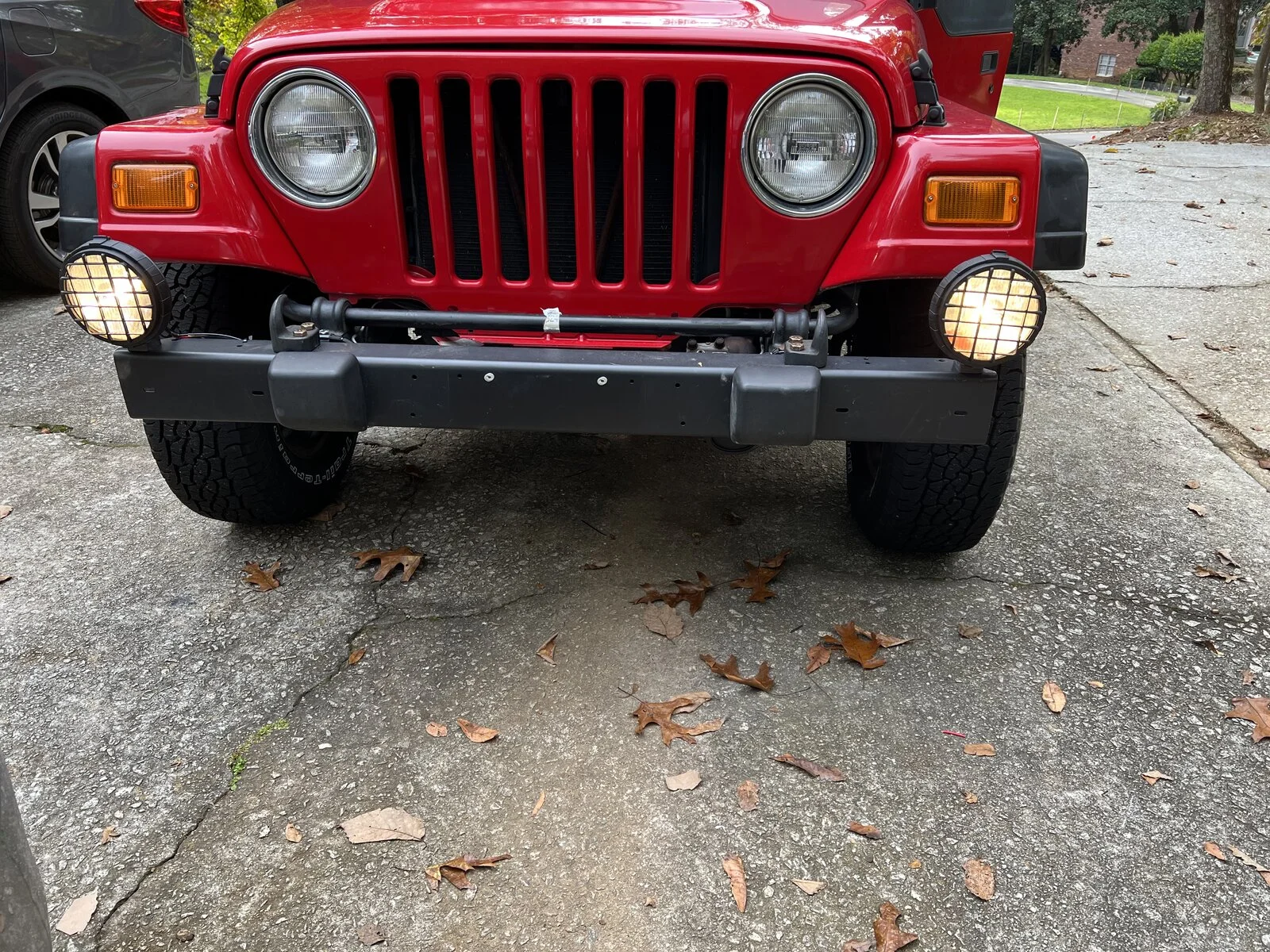

  • Painted the Fog light cases

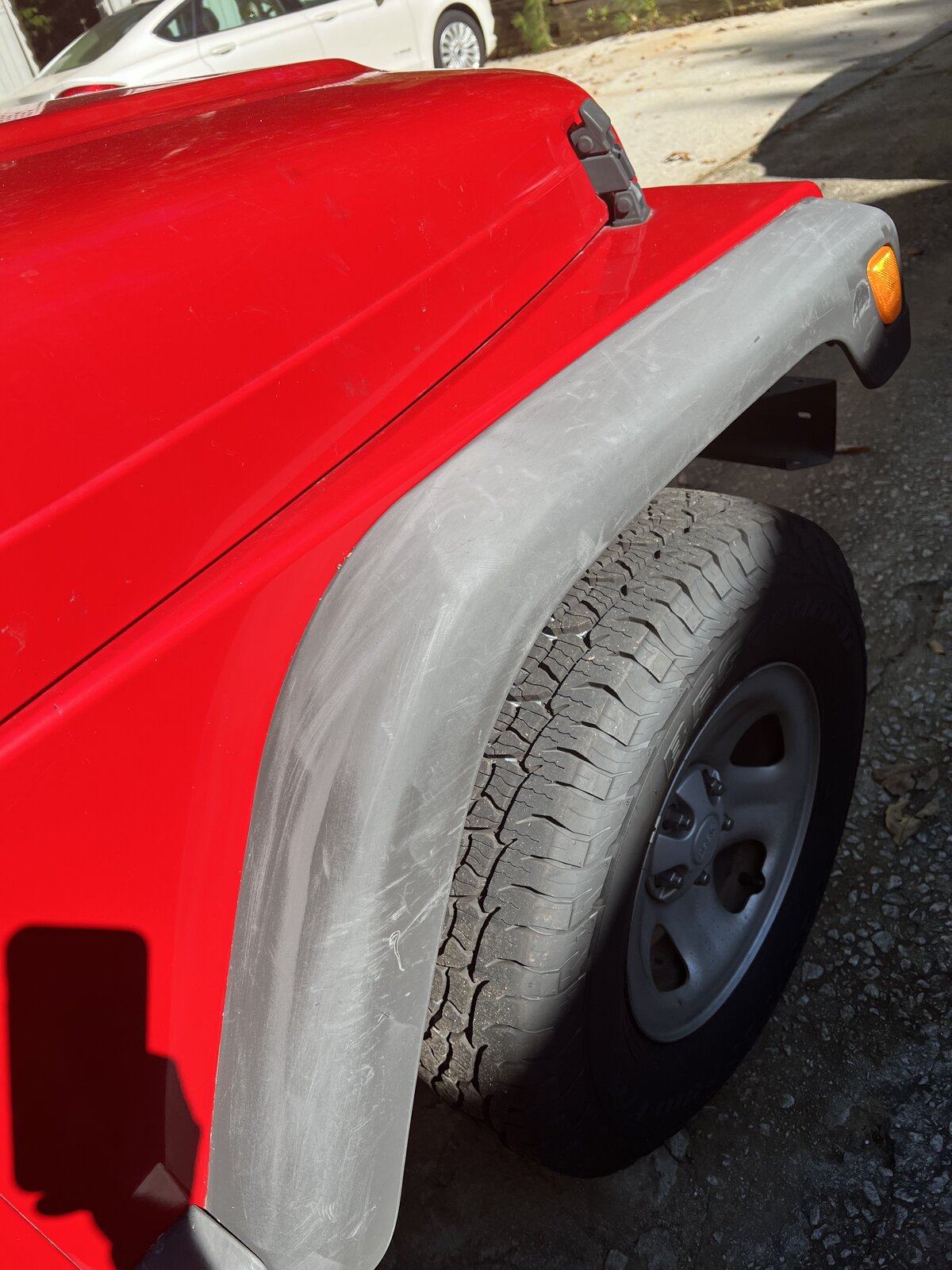

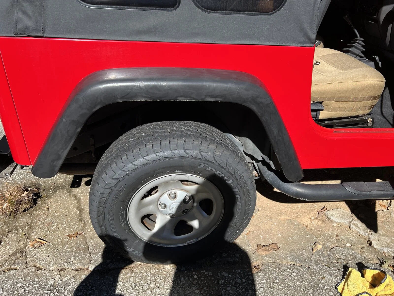

  • Heat gun the fender flares (not impressed). Adding new flares to the list.

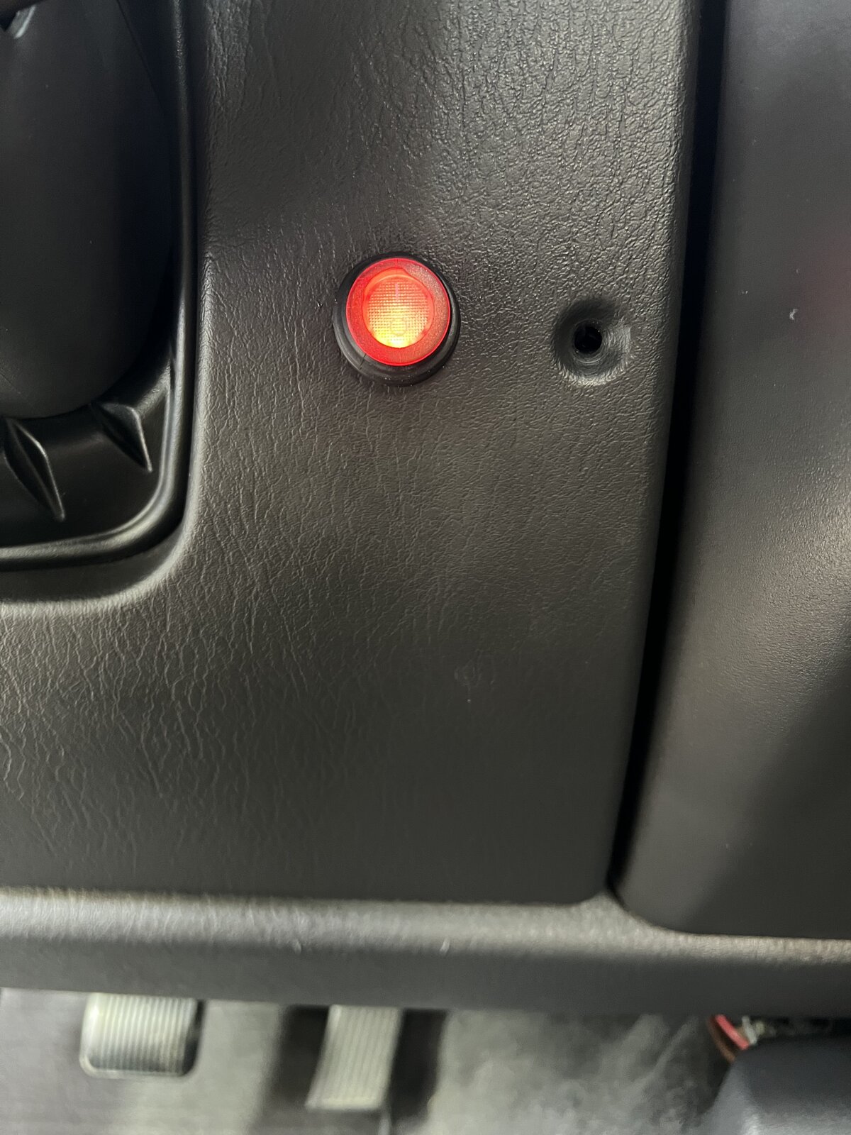

Wired the switch for the fogs (Need to take pics)

Finished driving light install

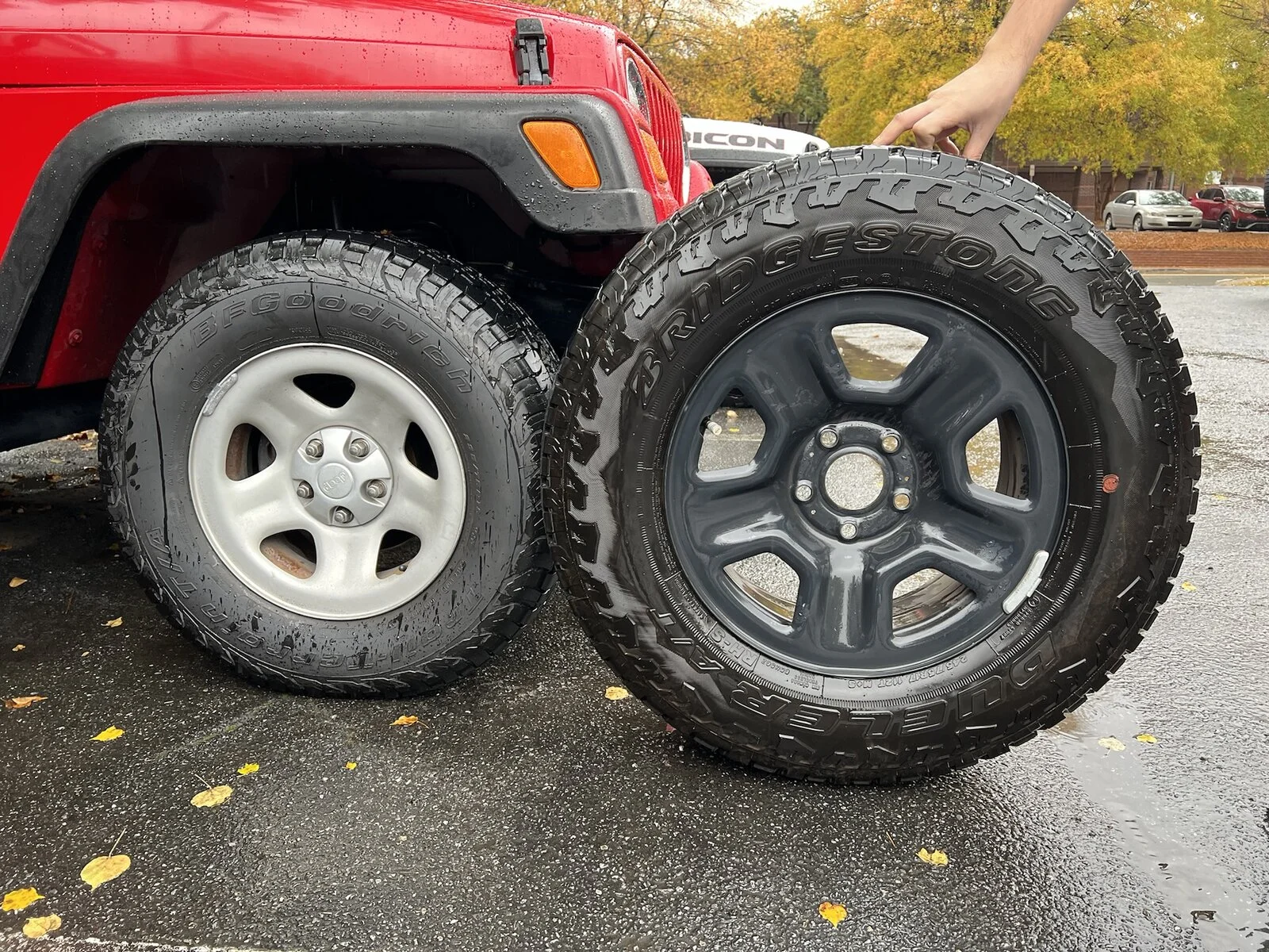

Picked up NIB pro comp steels 17x8 with the 5x4.5 lugs to go with the new tires and not need adapters

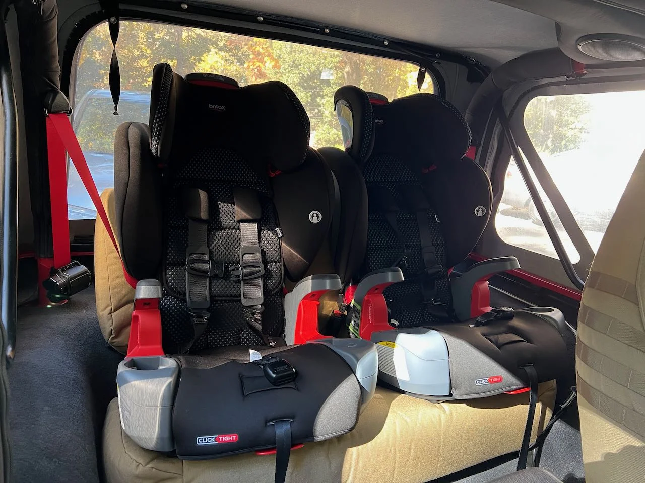

Installed new Seatbelt plant seatbelts and carseats for the kids. Pulling the seats and replacing the belts is still a pain in the ass the second time but atleast I had all the tools and knew i had to pull the seats to start with.

BMB pads and rotors installed. Unexpectedly did need new calipers (also got new hoses)

The good…found a pre-tramp stamp Bestop Dark Tan top on facepage for $175

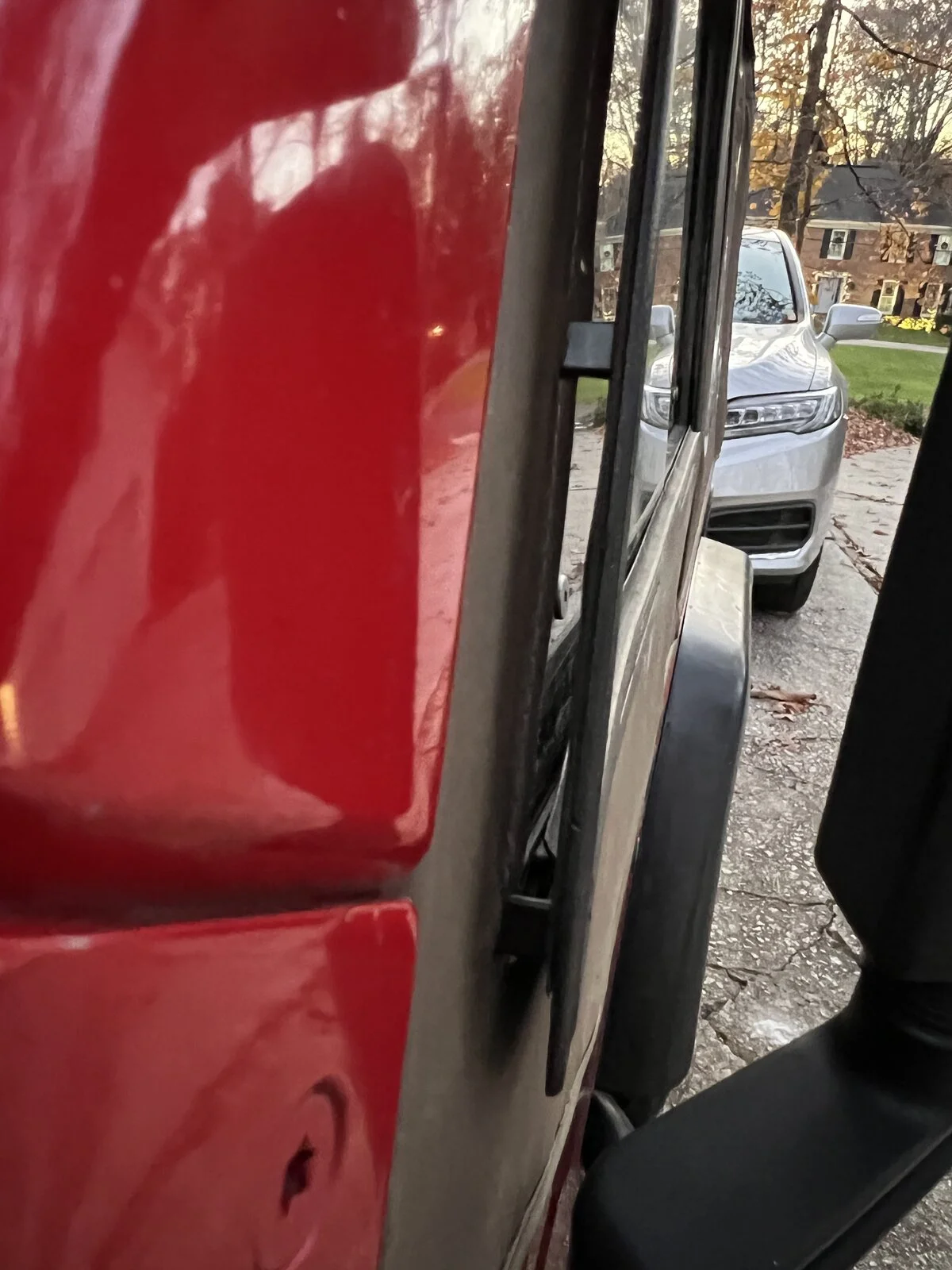

  • Fixed my damaged slider window.
    • Used some JB Epoxy on the top part of the window frame to secure it to the metal external frame
    • JB Putty to resecure the external side of the window frame clips back into the interior side
    • JB Expoxy to secure the external fabric back to the plastic frame

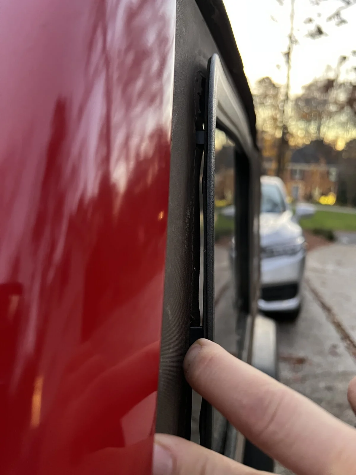

  • Need to figure out where the door/window seals are bad since I had water on both floorboards this week. I cleaned the Cowl when I got it so I dont think its the issue. Its probably a mis-alignment of 20 year old door, window and frame seals. 1in weatherstipping on its way and hopefully will seal it up

A few feet of foam weather stripping has sealed all the gaps between the top, half doors, and slider windows.

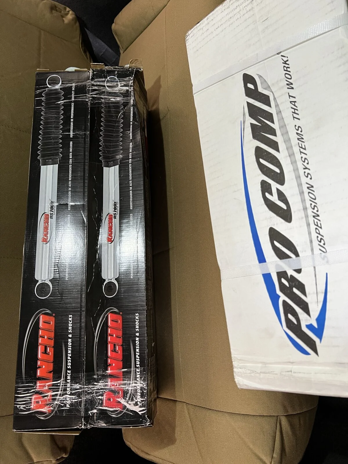

Finally got confirmation my buddy is coming the first week in Jan to help me with the lift install. ProComp and Ranchos are sitting in the garage ready to go, and it will be nice to have an extra set of hands to remount the winch and the hitch. Depending on our beer consumption, I may convince him to help me drop the tank and do the fuel pump.
