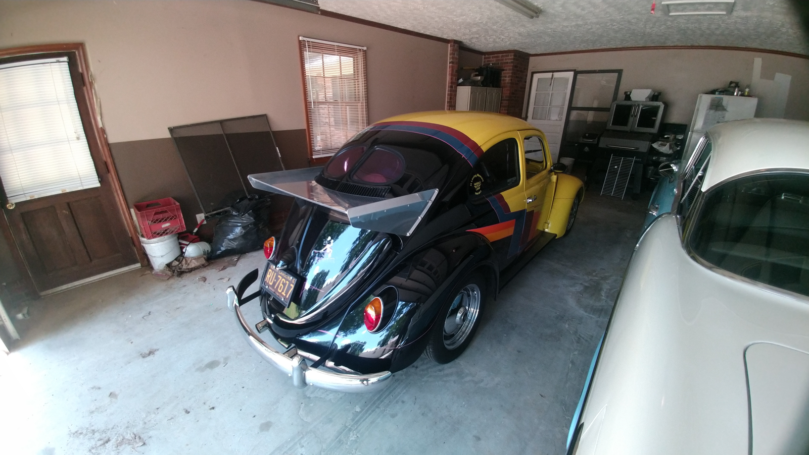

Those old VW engines are pretty tuff. I have a friend whos family has been into old VWs for a long time, including racing some. My buddys uncle had a bug we called "the blower bug" due to its huffer-puffer. It was a street car, but Butch was known to have a little fun on the street. One day he dropped a valve while going boogie-woogie and the tell-tale on the tach was stuck around 12,500. :LOL: The cylinder that ate the valve was destroyed but they had that engine torn down and back together in one Saturday. I just happened to stop by as they fired it up, so I hopped in the car with Butch, he took it slow down the road a few blocks, turned around and stabbed the pedal to the floor banging gears around 11K. That was a fun car. :cool:
Here she sits last year, minus the blower. Butch painted it late 80s/early 90s.
