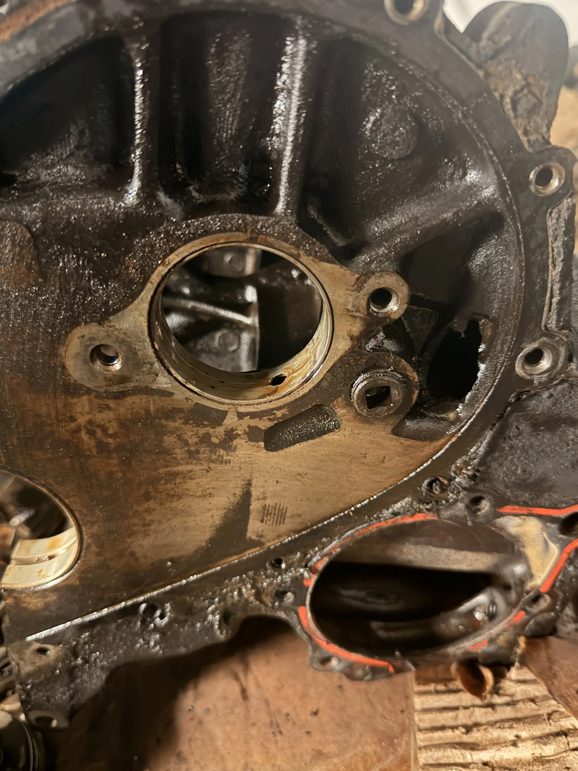

So tore it down and broke the piston skirt on #5. Didn’t look to bad, so I thought I might rebuild it. But when I took off the oil cover and removed the cam I noticed the hole in the block in the picture. It’s right above the cam behind the timing cover. I assume it’s not supposed to be there, but please correct me if I’m wrong. Anyone ever seen the block get a hole there? I don’t see how it could be related to the piston skirt. 🤷‍♂️. Does that go to a coolant passage?

Weird place to have a hole from casting, and it’s jagged like it blew out.
