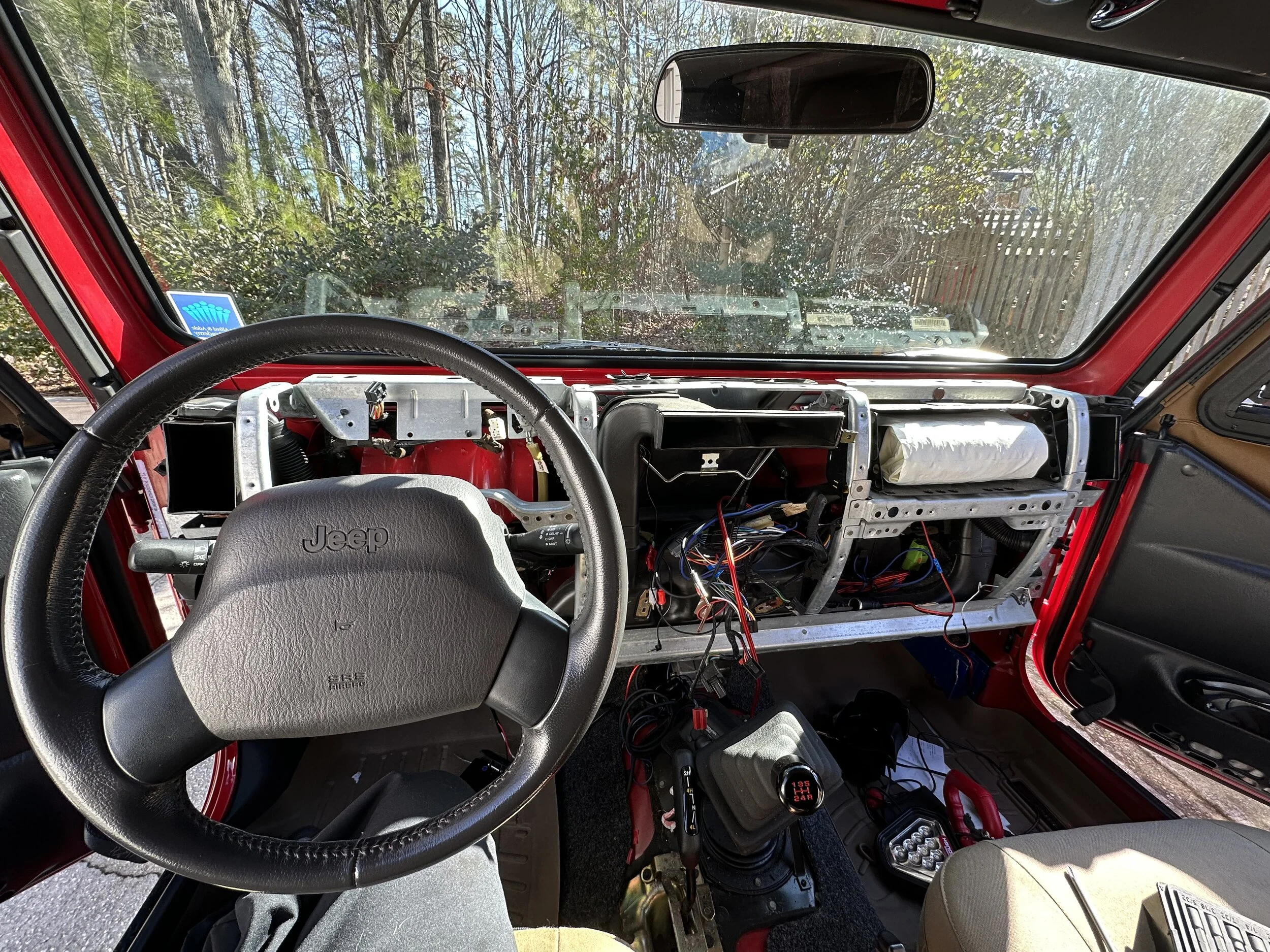

Short answer yes to just removing the plastic dash.
Thanks!
Anything special I need to know?
  • Tag and bag all your screws.
  • Disconnect the battery so you don’t accidentally trigger the airbag
  • Look up some heater core replacement videos. You obviously don’t need to disassemble as much but it’s a good reference
  • Take your time, the plastic may be brittle in parts and nothing needs much force to remove
  • Low heat / heat gun + hard plastic putty knife or trim removal tool is a good way to “fix” light scratches.
For the painting, I suggest reading up on the various interior trim / paint techniques and opinions and varied results. It’s one of the main reasons I did a swap rather than paint.
Reactions: MikeE024 and SSTJ
One more, while it’s out, you’ve got easy (not that it’s hard) access to swap radio, speakers, or run any other wires you may want.
