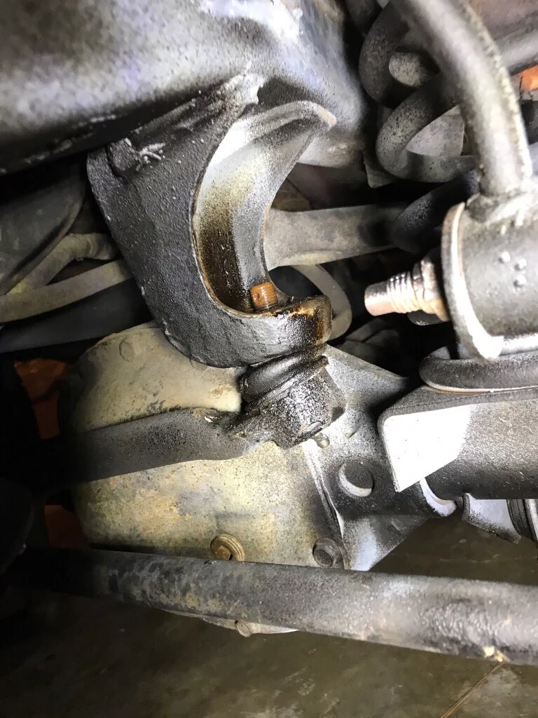

It’s the front also this part is just stuck in there.

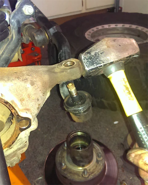

Once more, is the other end of the track bar unbolted and loose? Bang HARD sideways on the side of the track bar mount with a BFH to unseat the stud. That is a time-honored way to unseat tapered studs and it's faster & easier than using a pickle fork or tie rod end puller.
This photo shows me using that technique to unseat the tie rod end's tapered stud from the knuckle.

Ok I’ll try it and yes the other side is unbolted.

Wow, that is cool. I use a tie rod puller but will give this a shot next time.
P.P.S. Never hit the threaded stud itself whenever trying to unseat a tapered stud. That just mushrooms the stud and will usually just make it fit even tighter and make it more difficult to unseat.

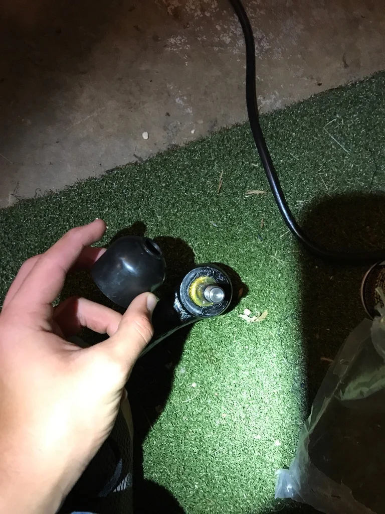

Finally got it out thanks a bunch. Also the new track bar has this little plastic but I guess was protection for shipping or do I need it?
