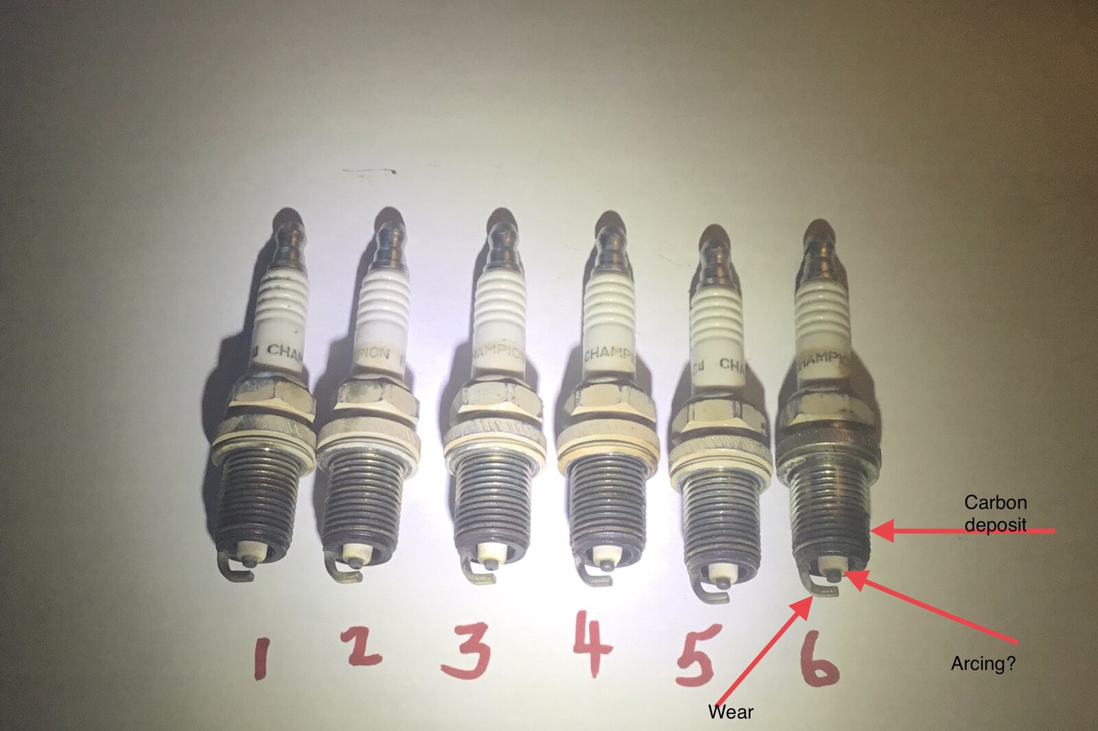

I have been getting an occasional check engine light and running out of ideas, thus far I have replaced spark plugs, checked fuel pressure adding an in-line fuel pressure gauge, swapped camshaft position sensors, conducted an engine smoke leak test and compression checked the cylinders. The engine sensors including the 4 O2, IAC, throttle body, MAP, CPS, TPS and PCM are recently new.
the year old spark plugs I replaced did not look bad at all, cylinder 6 could have had some minor arching around the electrode. Pulling the new plugs I just installed they all look the same after 1 week of around town driving.
these are the year old plugs;
but honestly I think I’m looking to close they actually look pretty good?

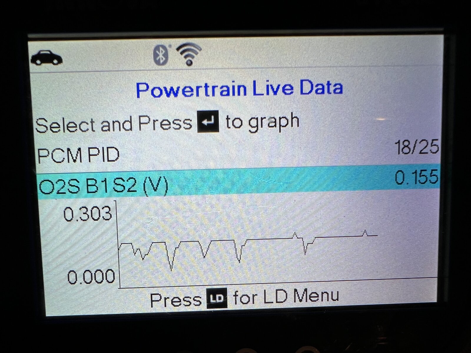

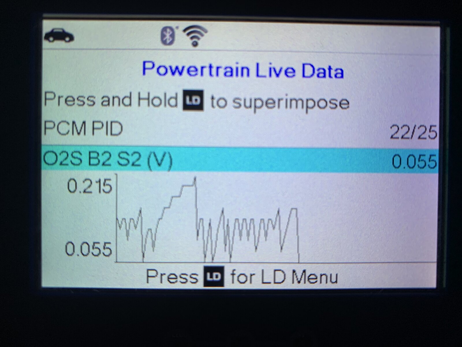

The check engine light just came back on but not all bad the code has changed from a P0306 to a generic P0152 O2 Sensor slow response. With the misefire on cylinder 6 codes and the generic O2 sensor slow response I’m going to swap out the down stream O2 sensor in bank 2 and kind of like I’d guessed… it’s still a guess bank 1 and bank 2 read fairly close but different enough this is probably my issue?
I'm confused. A code P0152 is a bank 2 sensor 1 fault. Your graph is for for both sensor 2's (downstream sensors). The graphs show post catalytic sensors. And those downstream sensors have nothing to do with fuel delivery.
Now, on a side note: Your bank 2 catalytic converter looks like it's toast according to that graph. I can't be 100% certain, because I don't know when this screen grab was taken (closed loop, RPM, etc). But at operating temperature, the downstream o2 should look like the first picture you posted. It should be a relatively flat line post cat. When the downstream o2 sensor starts mimicking the upstream switching, it indicates that the cat is trash. (Not surprising being that you were running so rich for god knows how long. This will destroy a cat in no time.)
Your sensor 1 (upstream) o2 sensors are the sensors used by the PCM to determine STFT which drives injector pulse width.
This is a long winded way of asking... Why would you replace the bank 2 downstream sensor based on this info? Seems that sensor is working perfectly fine, it just happens to be indicating a bad cat. You need to pull up graphs for both of your upstream sensors. If you decide to post them, make sure that you're in closed loop, and that you hold the rpm slightly above idle (about 1500 rpm). Hold that rpm until an entire screens worth of data populates and then snap a pic.

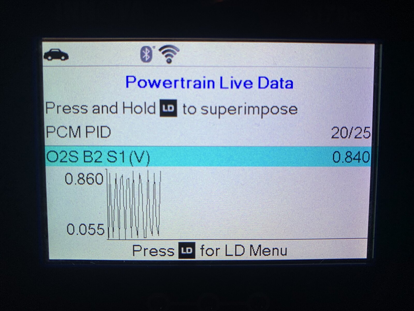

I didn’t have my code reader with me when the light came on so this is just after pulling into the garage eng temp 210, at idle closed loop. I did a side by side graph of the upstream sensors and they looked pretty much the same actively moving up and down on the chart the range of movement equal between bank one and bank two, looking at the small screen on the code reader almost identical slightly different synchronization. the only difference being between the down stream sensors drawing my attention there.
I did a typo when I posted sorry it was late, the code is p0153, still the upstream sensor bank 2 then? I was confused about which one to look at so it is obviously measuring the gasses before they are treated by the precats, that makes more sense. Dumping extra fuel into the exhaust would do the cats in pretty quick I guess if it was, they don’t seem to be plugged its running the best it has since the engine went in but I guess they could be burned out without being plugged? I’ll change some sensors first and hope this solves the codes I have a spare set. I noticed the air fuel jumping for just a couple seconds getting on the freeway pretty lean 16.?/1 im not sure if that is just my combination of injectors and tune or more likely the O2 sensor response times?
But the big sign on the side of road points toward the bank 2 precat then as the most likely culprit or should I expect both precats toasted if it was that rich on fuel and this new code warning me of it running lean, I’m not sure if all this fits as the same issue or if the symptoms are just coincidental.

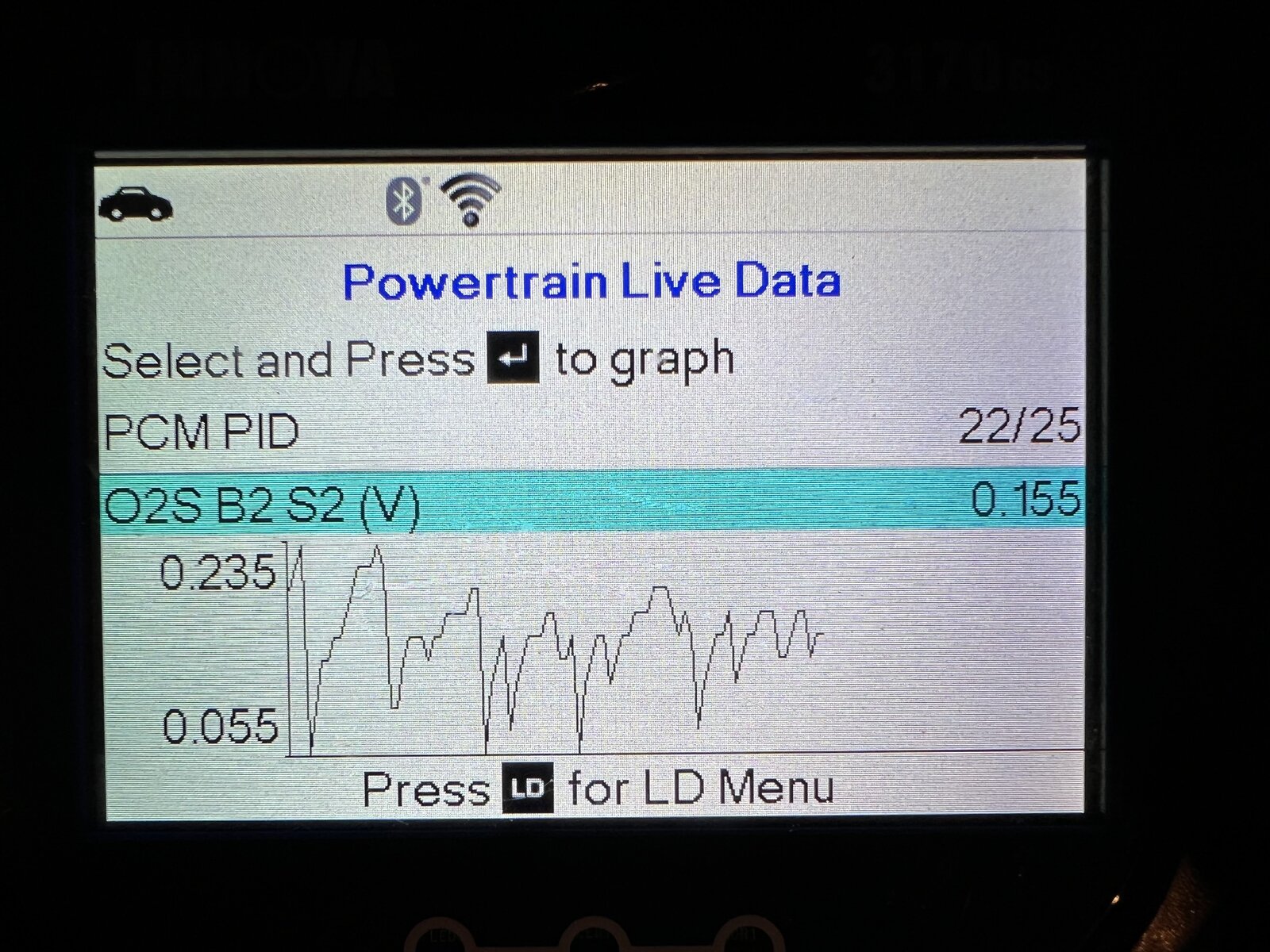

I have these graphs from November of 2020 just after the engine went in the precats would not have been toasted at this point they were fairly new, the O2 sensors were new I was in the process of fixing vacuum and exhaust leaks, missing engine ground straps and a host of bad engine sensors work improperly done by the shop that installed the engine, so it was hard to pinpoint where the issues were coming from.
the sensor graphs I think have not changed much?
At least I didn’t think the precats were bad unless the blown head gasket would account for just bank two going bad if the cylinder where the opening occurred was also in bank two and that could clog it?
