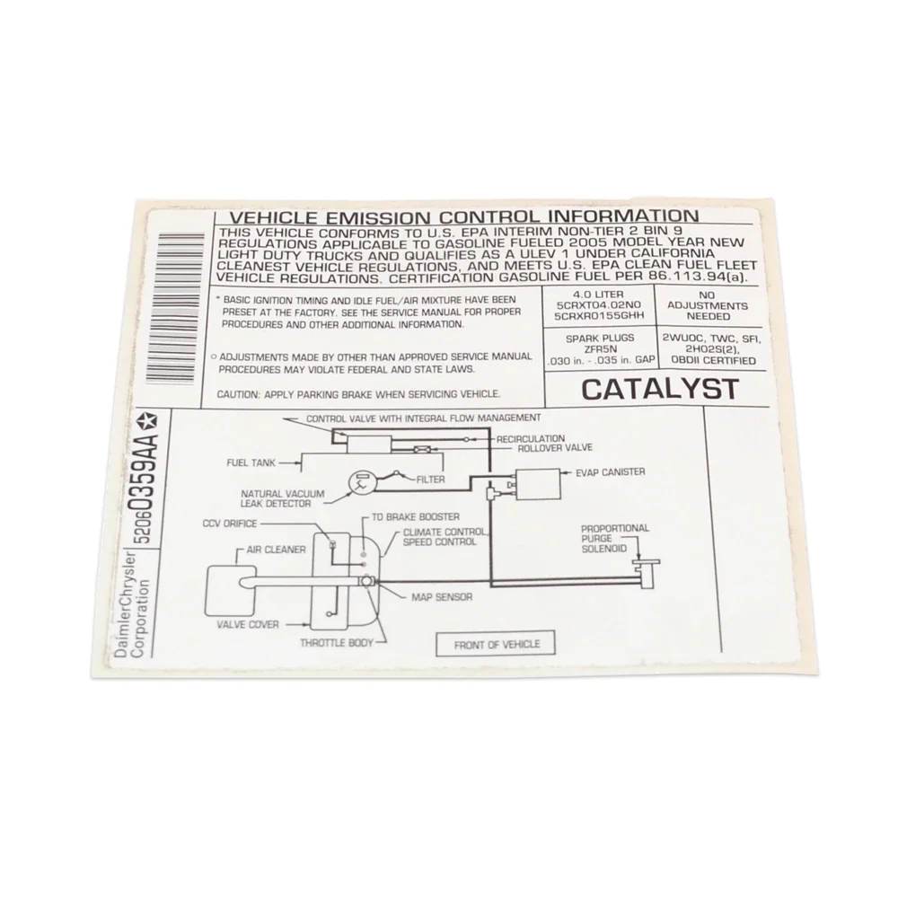

I have been looking to buy a one tone swapped LJ recently and I keep finding deals in other states that are great apart from the fact all the evap/smog gear has been ripped off :(
I know it's a bit of a long shot, but does anyone have the details or know of a guide on how to re-install all of it?
I'd have to work out what parts are missing and then get them all plumbed back in so it will pass smog in California.
Hopefully I can find one that's just missing the evap canister :D
The factory service manual has pretty detailed info on the evap system, you should be able to get it back to a normal state with it. You can get yours for free over in the TJ Resources sub-forum
