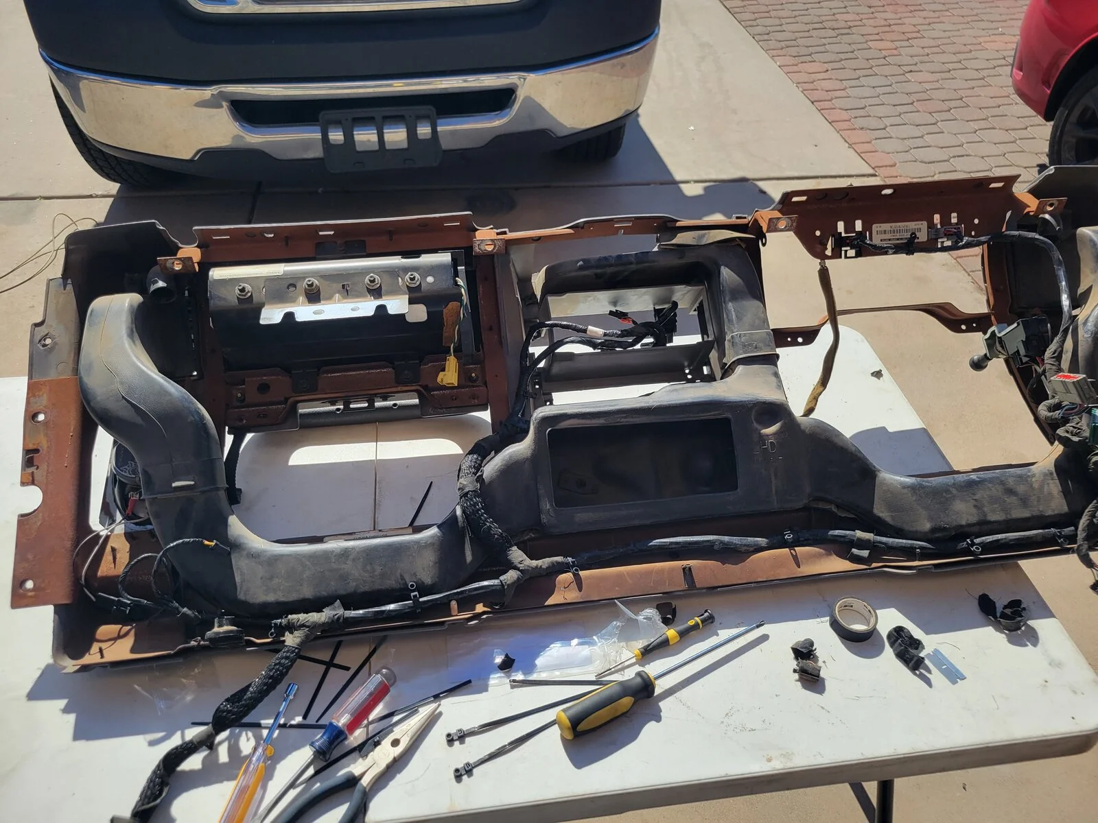

Do you mean you can get the cluster only out that way, or do you mean take the whole dash out like the picture? My cage ties into the floor along side the dash so it would have to come out either way. But it is really simple, I just want to get one of the monitors set so it will be able to pass smog. The light is the least on my worriesYou can!!!!! Take off the knee panel and give her the old reach around. It isn't nice but it might be better Than your other optionView attachment 309228
The back of the cluster is open to a point

Well that might save some time. Thank you.I'm almost certain that you can replace the bulb from the back without removing the cluster. They are 1/4 turn connectors. Next time I'm working on mine I'll look at the back while it is in place
Edit. I can fell the light on my 97. With a curved set of needle nose I can remove it
