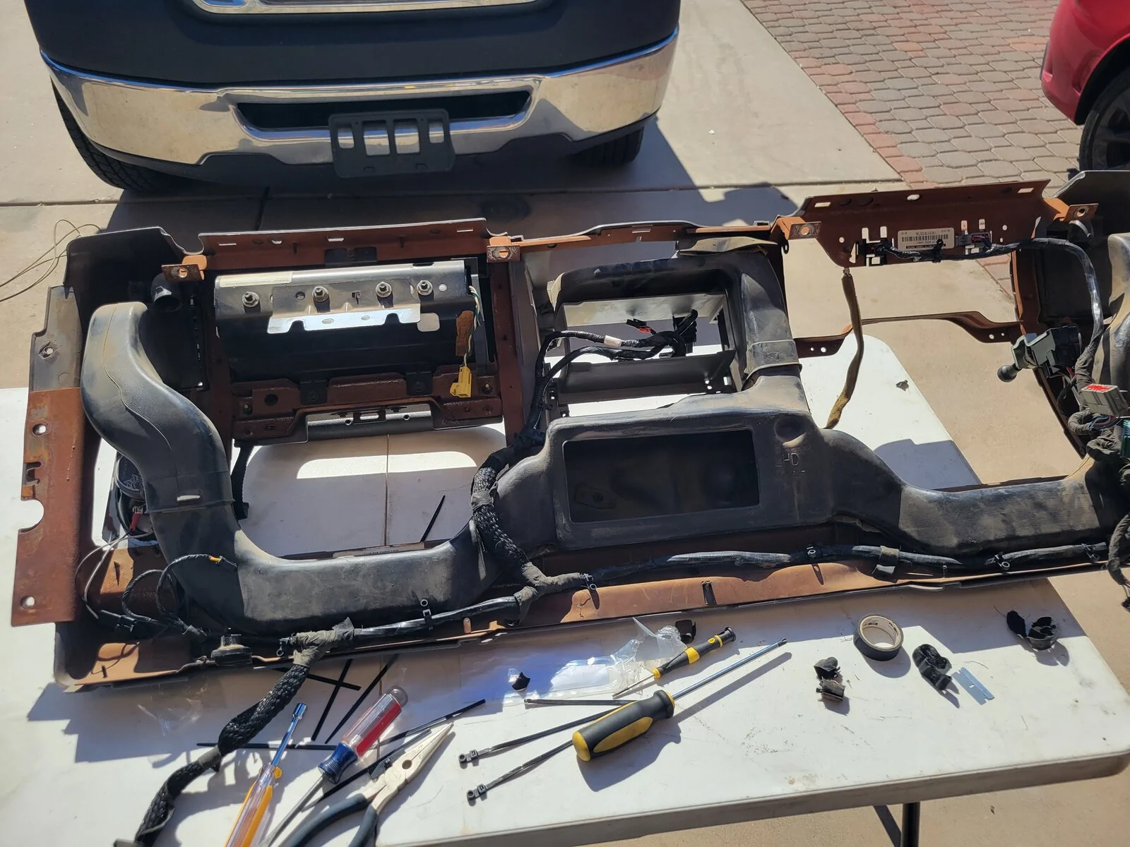

You can!!!!! Take off the knee panel and give her the old reach around. It isn't nice but it might be better Than your other optionView attachment 309228
The back of the cluster is open to a point
Do you mean you can get the cluster only out that way, or do you mean take the whole dash out like the picture? My cage ties into the floor along side the dash so it would have to come out either way. But it is really simple, I just want to get one of the monitors set so it will be able to pass smog. The light is the least on my worries
I'm almost certain that you can replace the bulb from the back without removing the cluster. They are 1/4 turn connectors. Next time I'm working on mine I'll look at the back while it is in place
Edit. I can fell the light on my 97. With a curved set of needle nose I can remove it

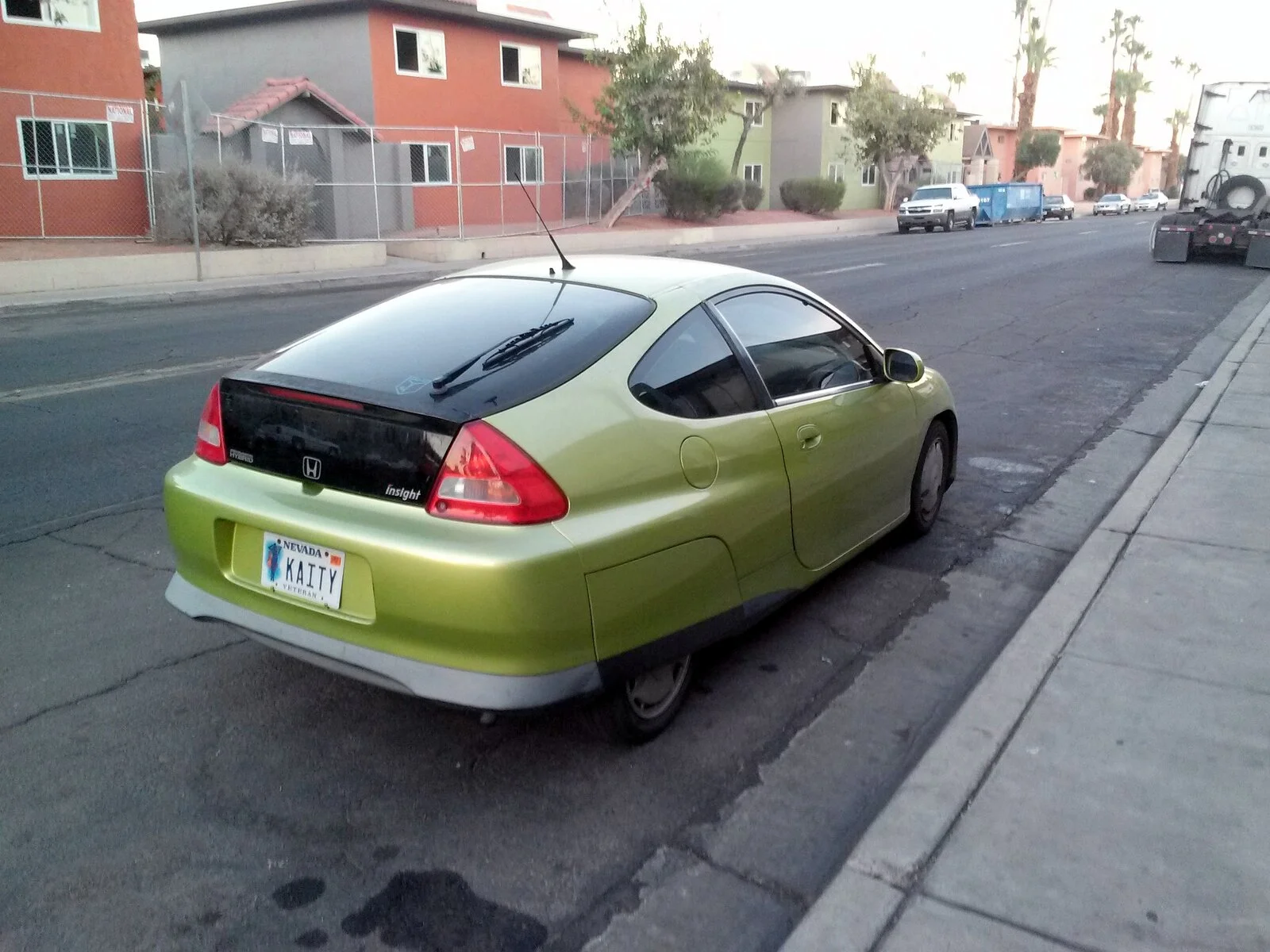

I had one of those, fun little car.
Yeah, it had it's drawbacks and overall limitations but I do very much miss that car. It was rather unique and to date still the only Hybrid I've ever seen come with a manual transmission option.
My IMA battery kicked the bucket, and I couldn't afford to replace it, so I bypassed the IMA so it could drive on the regular engine, but found out CEL was insta fail for smog, which was always absurd, since that car with or without the hybrid battery was a low polluting car even by California standards.

Those citrus green ones are very rare. If I ever got another one and couldn't find green I'd probably paint it white. First few years I had mine I averaged about 85 mpg. Sometimes I forget those things are over 20 years old, time flies.
Yeah, made in small numbers during the 2000 model year only, but mine was a citrus, 5 speed with A/C. Had I been in a better situation back then, I'd have tried harder to keep it. I averaged 60-75 MPG usually. Driving up I-40W to Flagstaff was the worst though.
Well that might save some time. Thank you.
