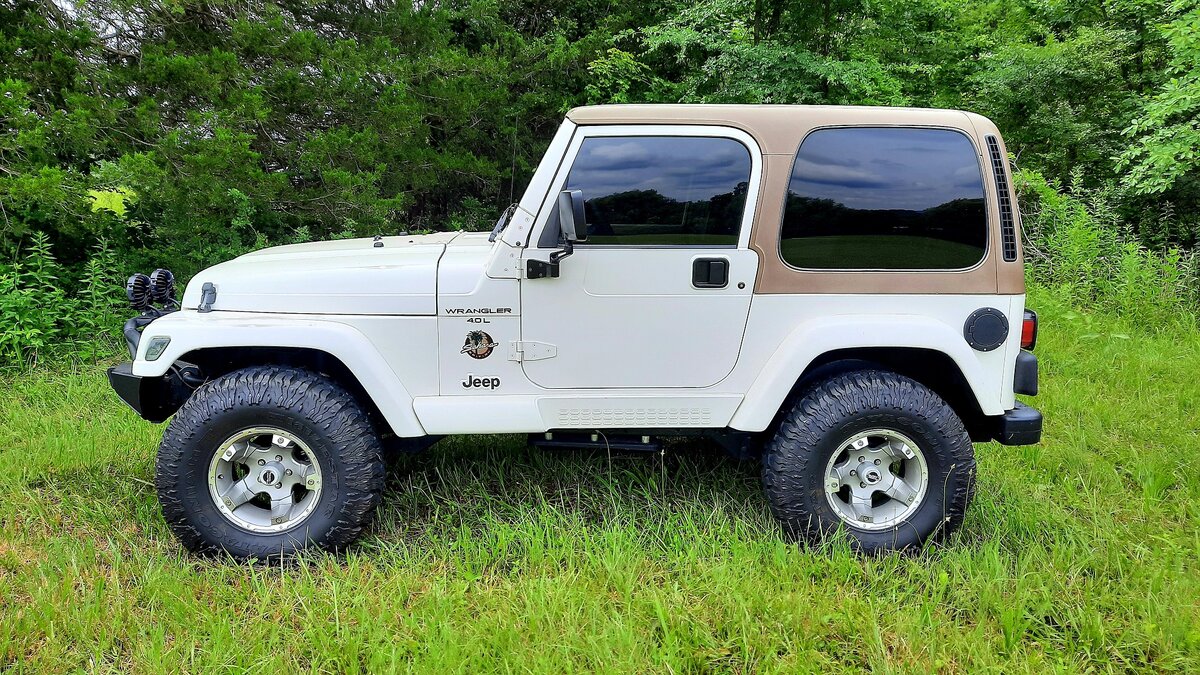

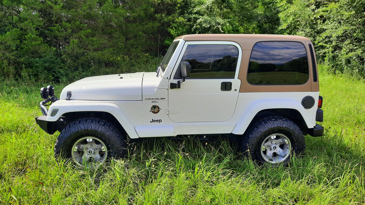

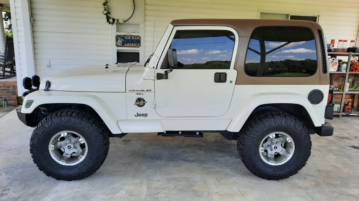

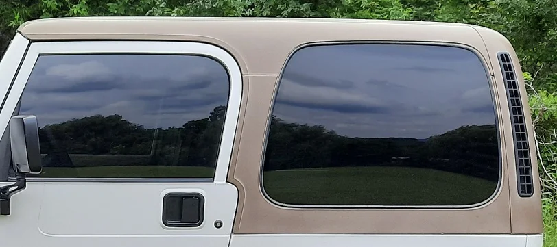

I read on here about using penetrol to restore the paint on your hardtop so I picked up a can at Lowes for under $11.00
The day before I used the penetrol, I used warm water and several magic erasers to clean the hardtop. I paid special attention to the rubber around the side windows since they were white and oxidized looking. The magic erasers removed some of the fading from the top and made the rubber around the windows look black like new again. I gave the top 24 hours to dry before applying the penetrol.
I have read about different ways people apply penetrol, with a roller, foam brush, rag, etc. so I chose to apply it with a cotton rag. First I used painters tape to mask off the rubber around the windows. I then applied penetrol to half the top, waited about 3 mins and used a microfiber cloth to wipe the excess off. I then completed one side, the other half of the top, the other side and then the rear. I didn't want to do too much at one time because I didn't want the penetrol to stay on too long because it gets stickier as it dries. I buffed the hardtop several times with the microfiber cloth to make sure there were no streaks or swirls.

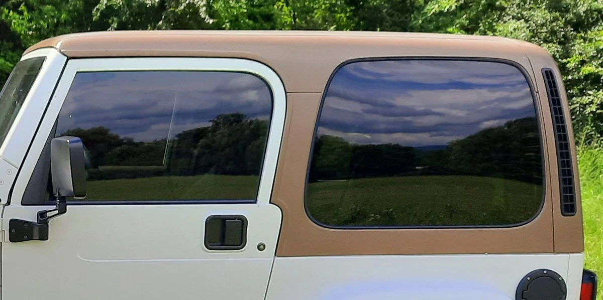

Here are some before and after pics. The top looks like new again. I couldn't believe the difference it made.

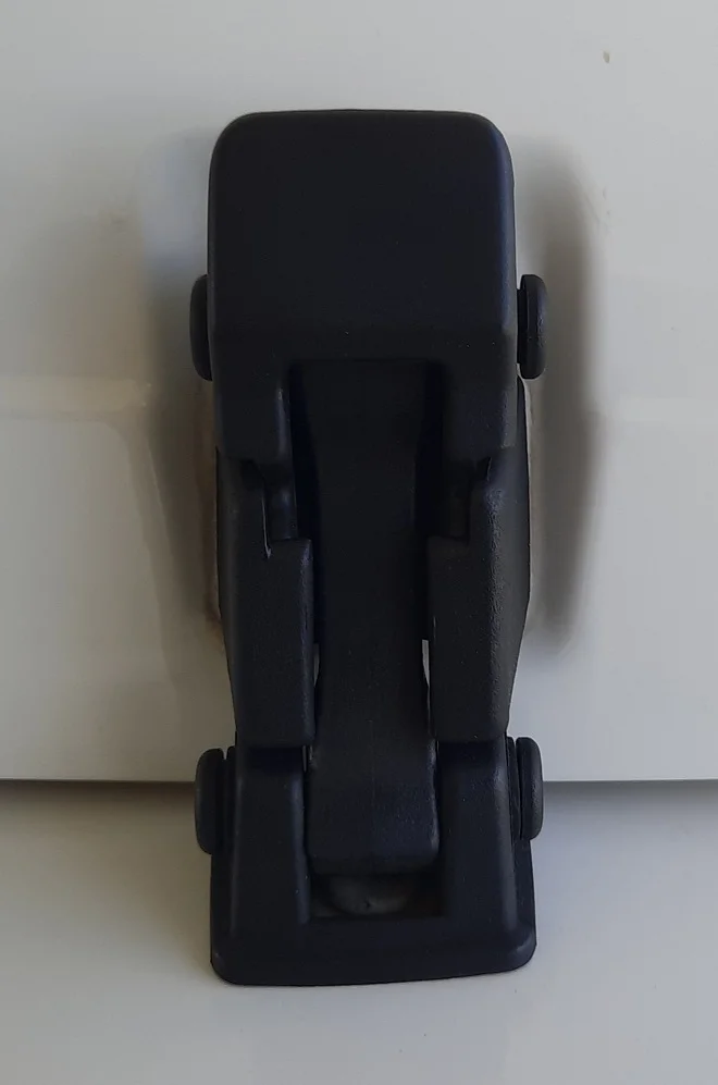

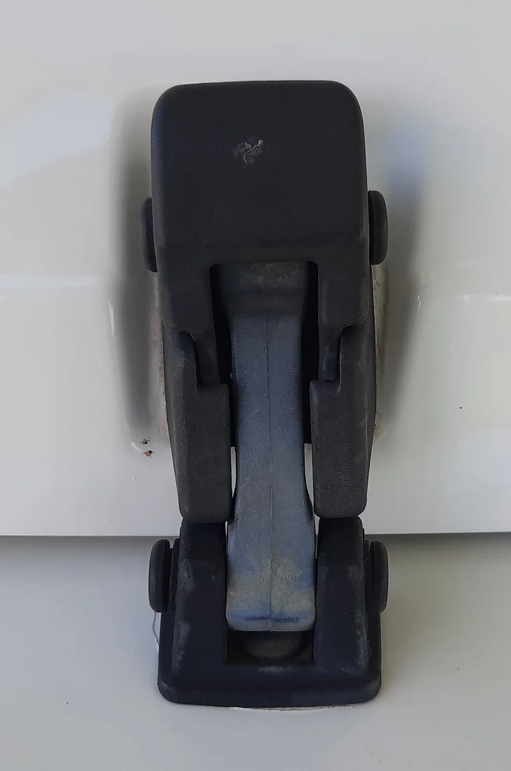

I also did the hood latches with the penetrol and they look like new again as well. I taped off around the latches and applied the penetrol with a small foam brush, waited about 3 mins and wiped it off with a microfiber cloth.
I'm very happy with the results and if you're wanting to make your hardtop look like new again, I would highly recommend this.

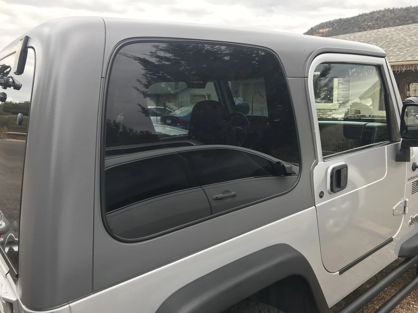

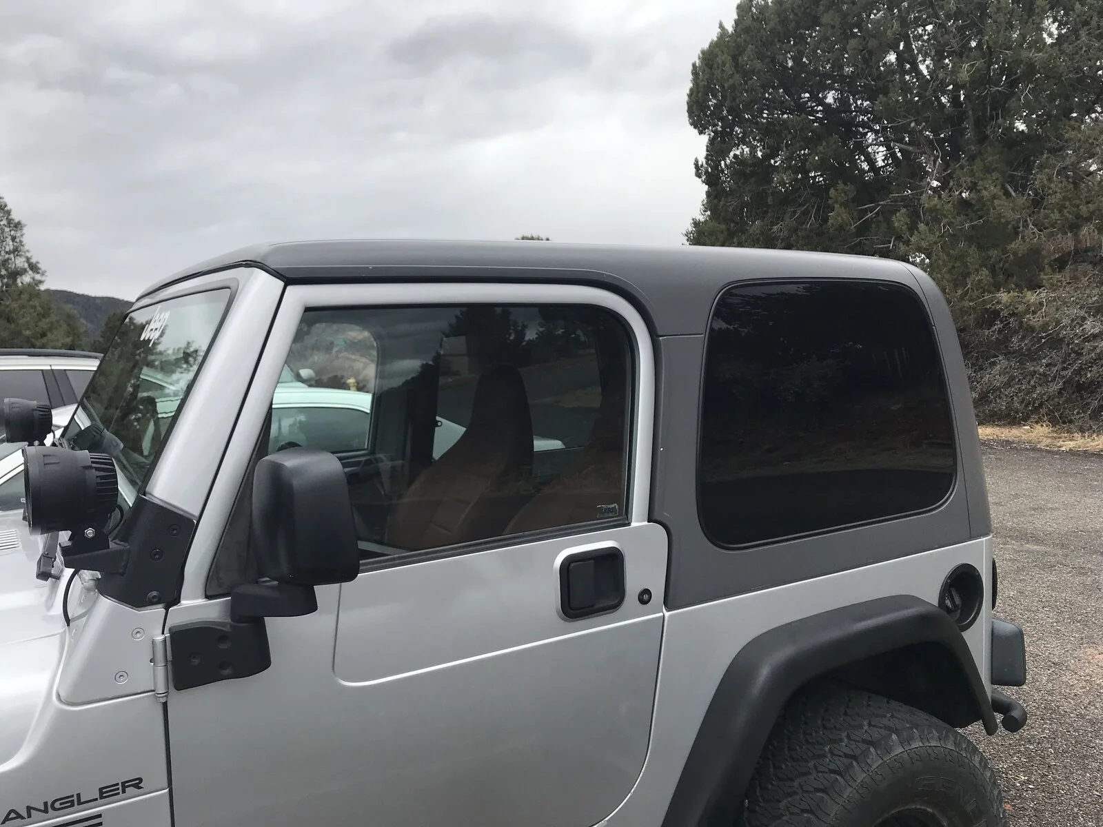

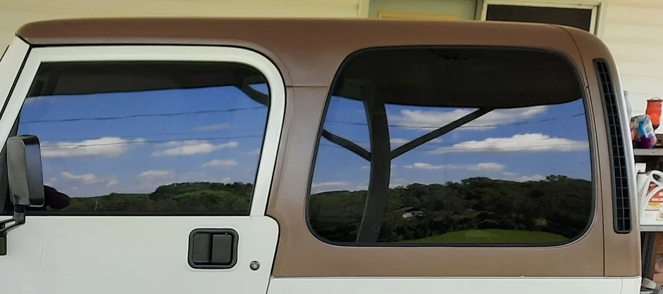

I used this on a grey hardtop a few years ago and even though I didn't have it more than a few months, the color held up after several washes. These pictures are a couple of days before I sold it. You can see how glossy it still looks, but it was smooth and dry to the touch.
