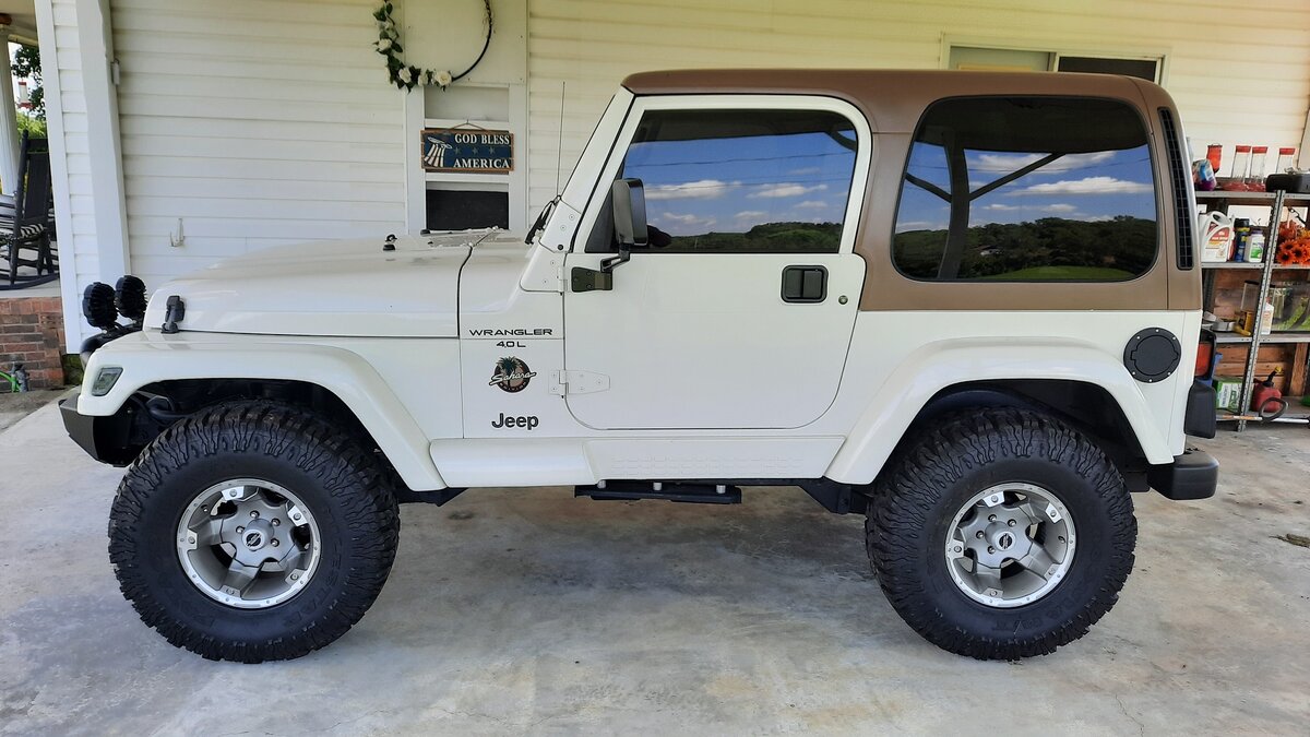

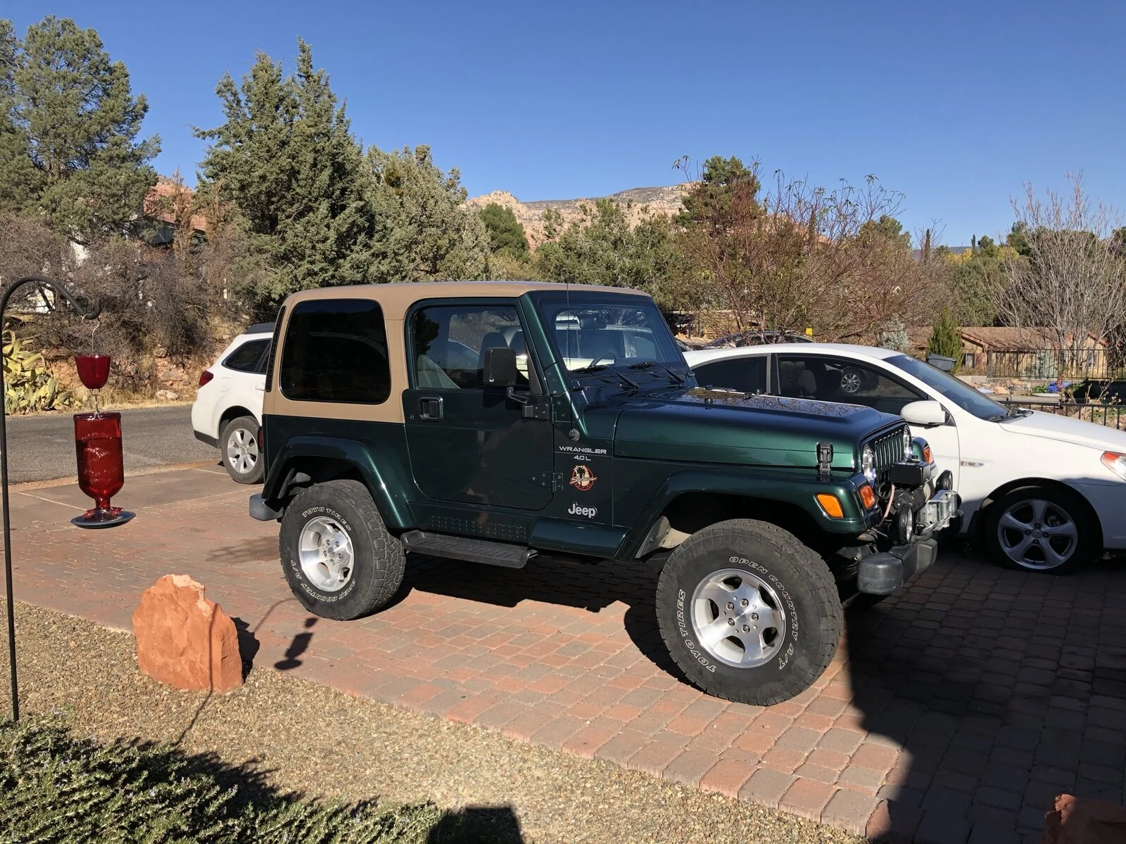

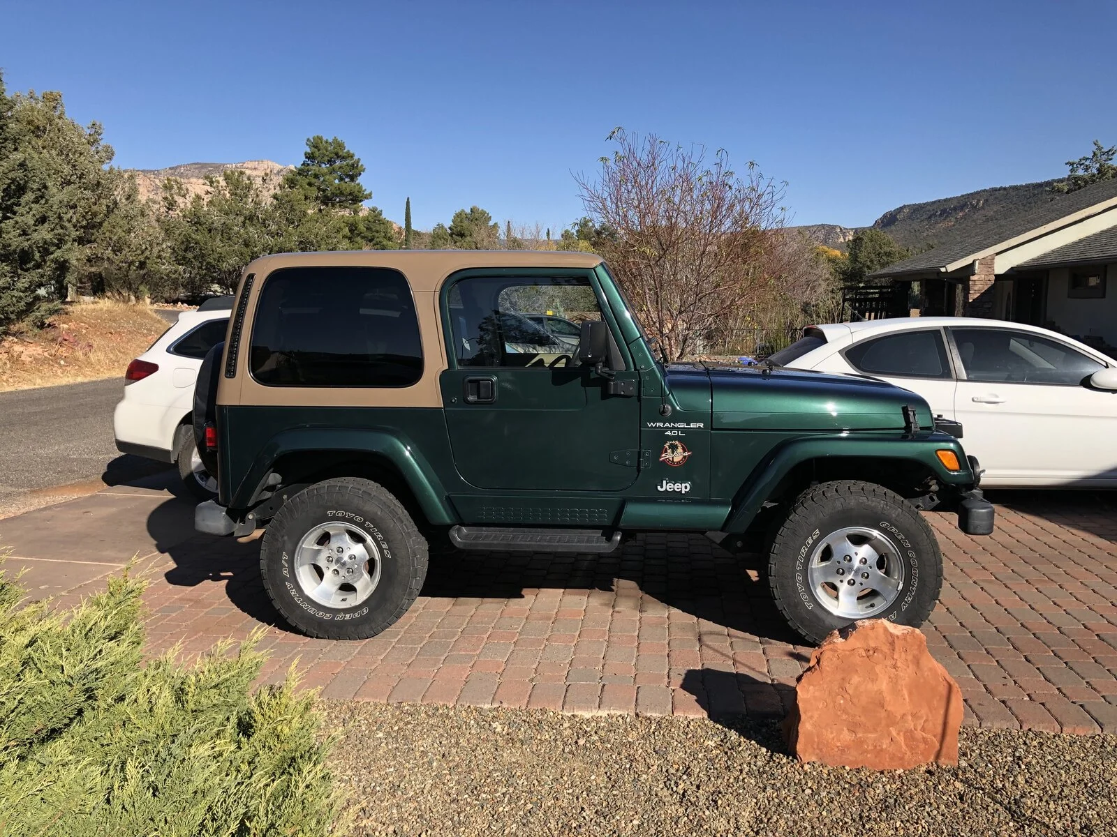

Restored my hardtop

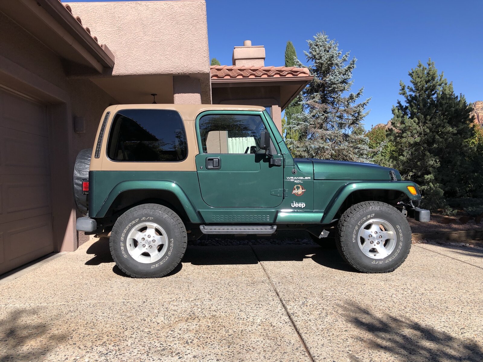

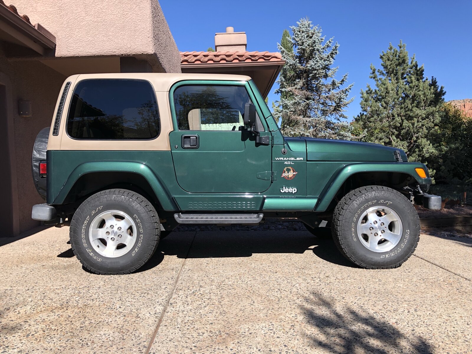

Just wanted to give an update on restoring the hardtop. Its been over 4 months now and the hardtop still looks like the day I cleaned and applied the Penetrol.
I generally wash the Jeep every weekend so its had about 15-16 washes since it was applied. (I missed 2 or 3 washes due to being busy)
I'm still very happy with how it turned out. Before it gets too cold the Jeep will get a good washing, clay bar and then waxed. I believe I'm going to try the Turtle Wax Ceramic spray and see how it does.
I'll give another update in a few more months to show how it fairs during the winter months.
That turned out looking sharp as hell! Well done! That paint looks like a perfect match too.
Definitely keep us posted on how it holds up.
Bionic_Scorpion - I took your advice on the Penetrol and it worked great and still looks great.

I'm glad to hear you had a great experience with the penetrol and thanks for the heads up on the ceramic spray. I've been reading reviews on it and it sounded too good to be true for something so simple to spray on and wipe off but I figured I'd give it a try.
It making your vehicles shine like chrome sounds like a no brainer for me to try it. Thanks brother.

@Bionic_Scorpion any update on how the color has held up? I sold my Sahara last December but I've seen it passed around on CL and FB a couple times and the hard top still looks fresh imo.

The hardtop still looks the same. I dont think the penetrol covers up anything, I think the magic eraser and penetrol removes the white film from weather and sun damage. So as long as you keep it clean, it should stay looking new.

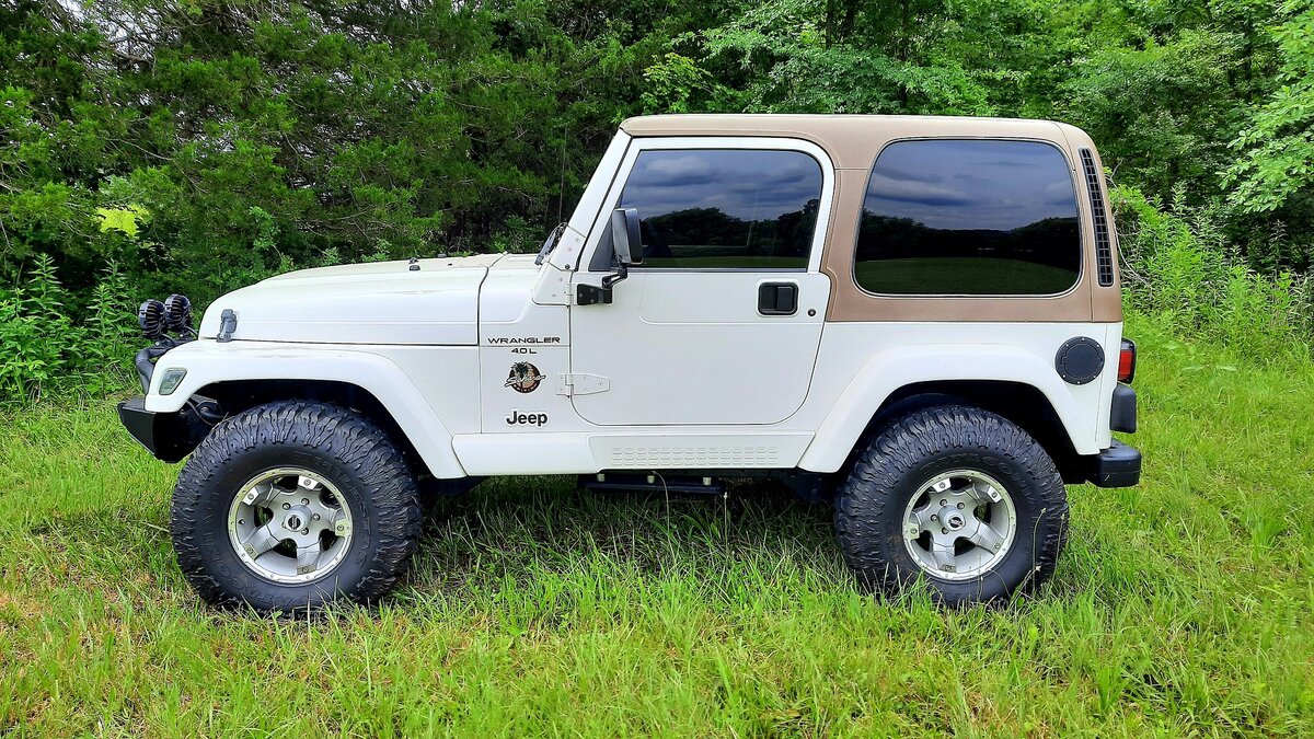

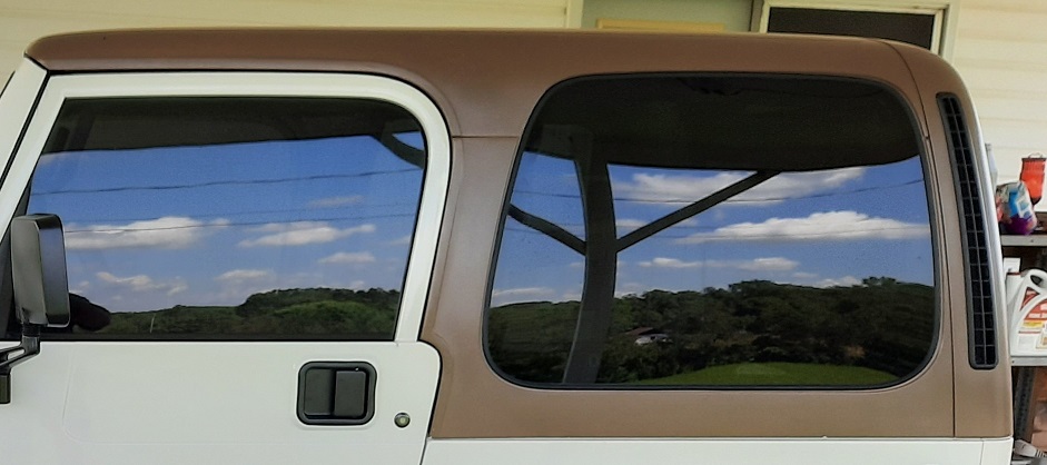

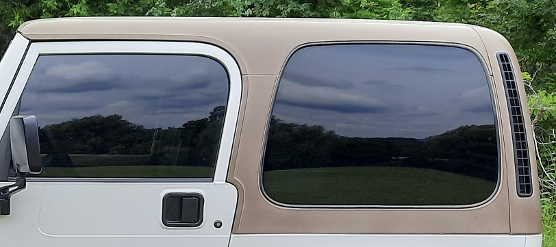

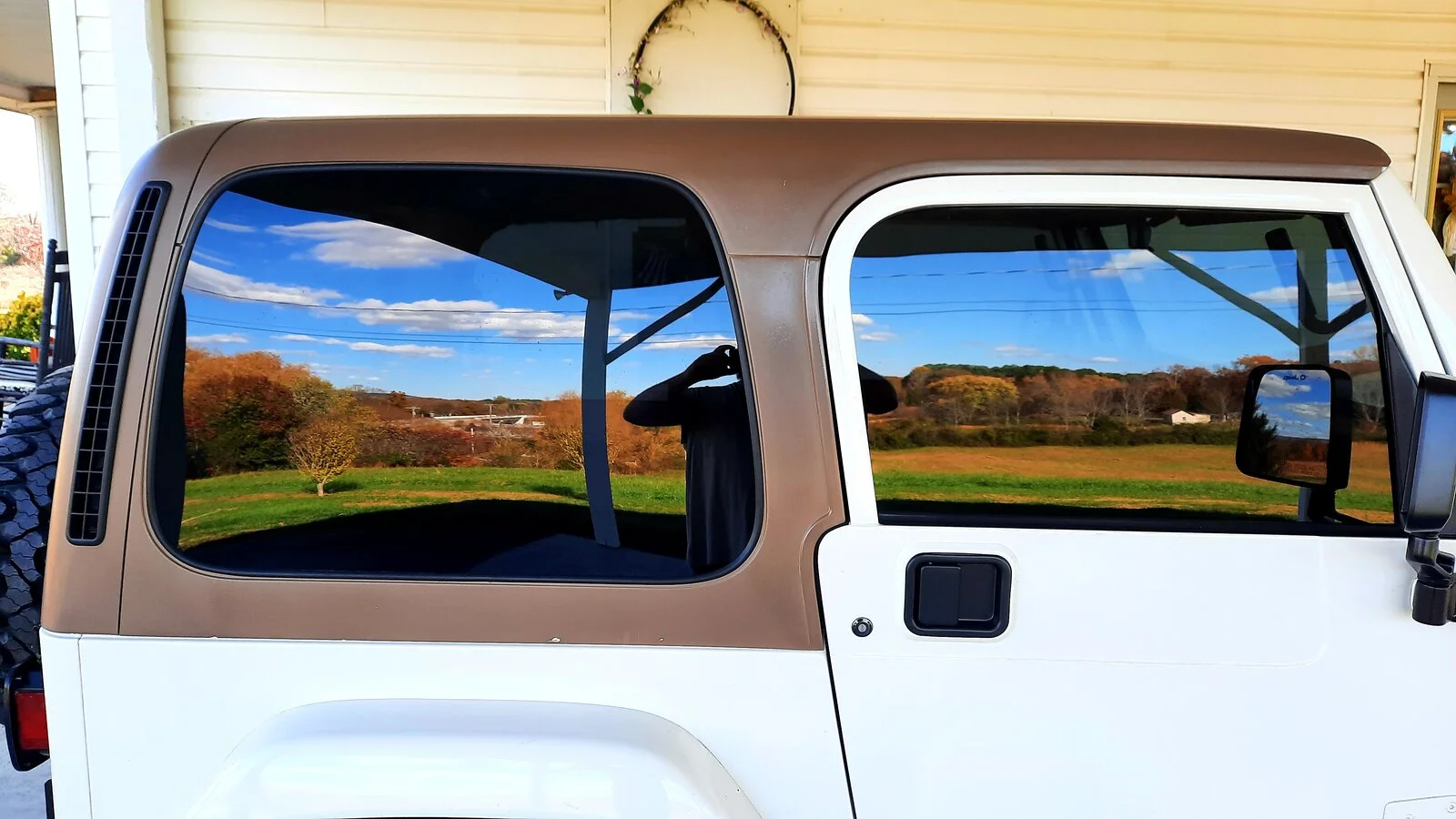

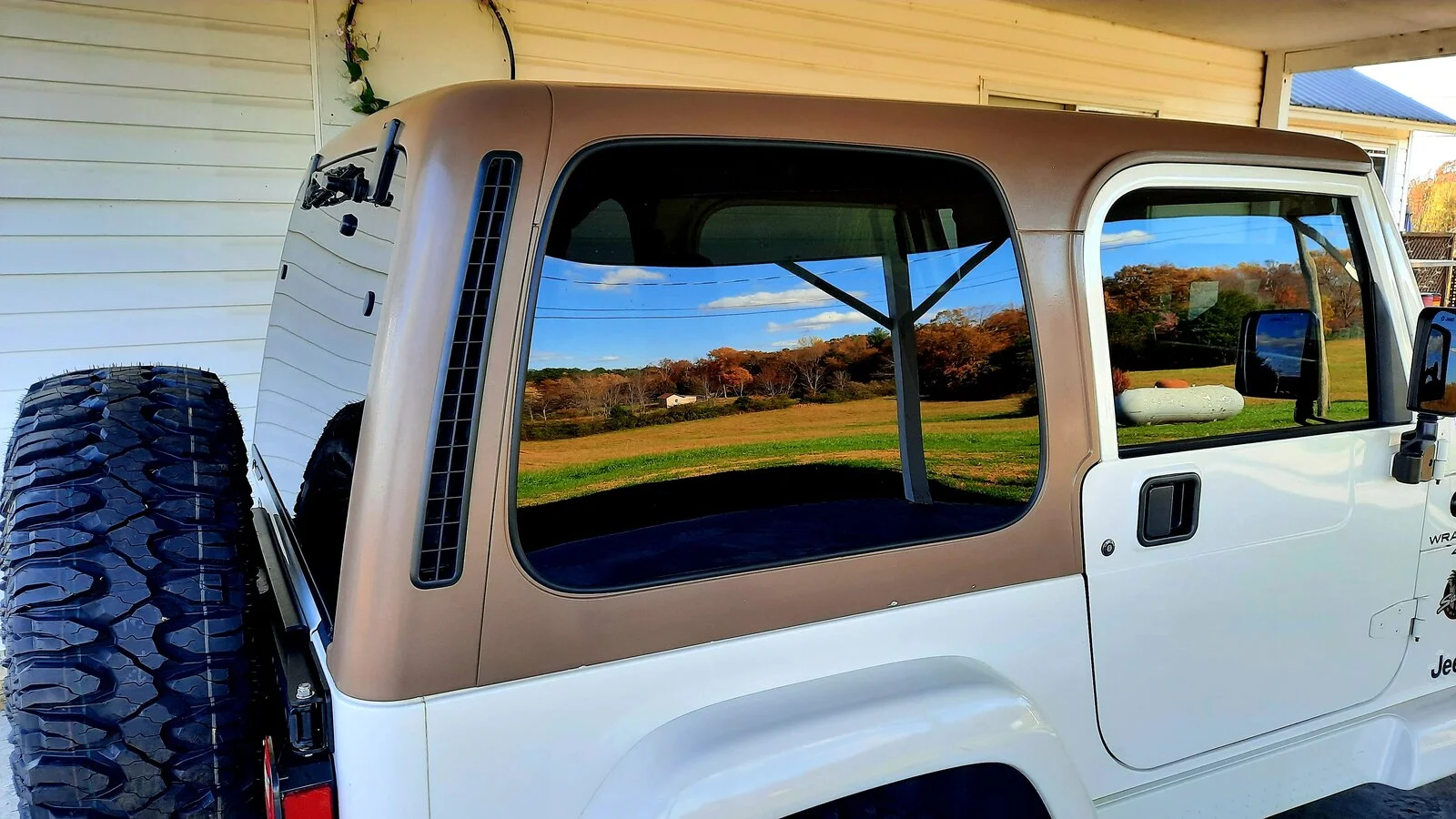

Here are some before and after pics. The top looks like new again. I couldn't believe the difference it made.

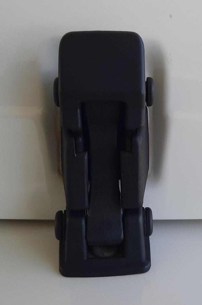

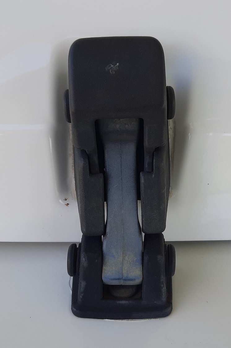

I also did the hood latches with the penetrol and they look like new again as well. I taped off around the latches and applied the penetrol with a small foam brush, waited about 3 mins and wiped it off with a microfiber cloth.
I'm very happy with the results and if you're wanting to make your hardtop look like new again, I would highly recommend this.

Before and after with Penetrol.
And then after buffing.
