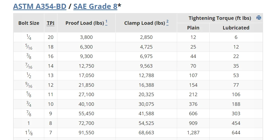

I bought a lsd for my Dana 44 I installed my new ring gear and torqued to specs. Then I found a good deal on an e locker before finishing my gear change. My question Is can I reuse the ring gear bolts to swap it over to the new locker or do I have to get new bolts.
