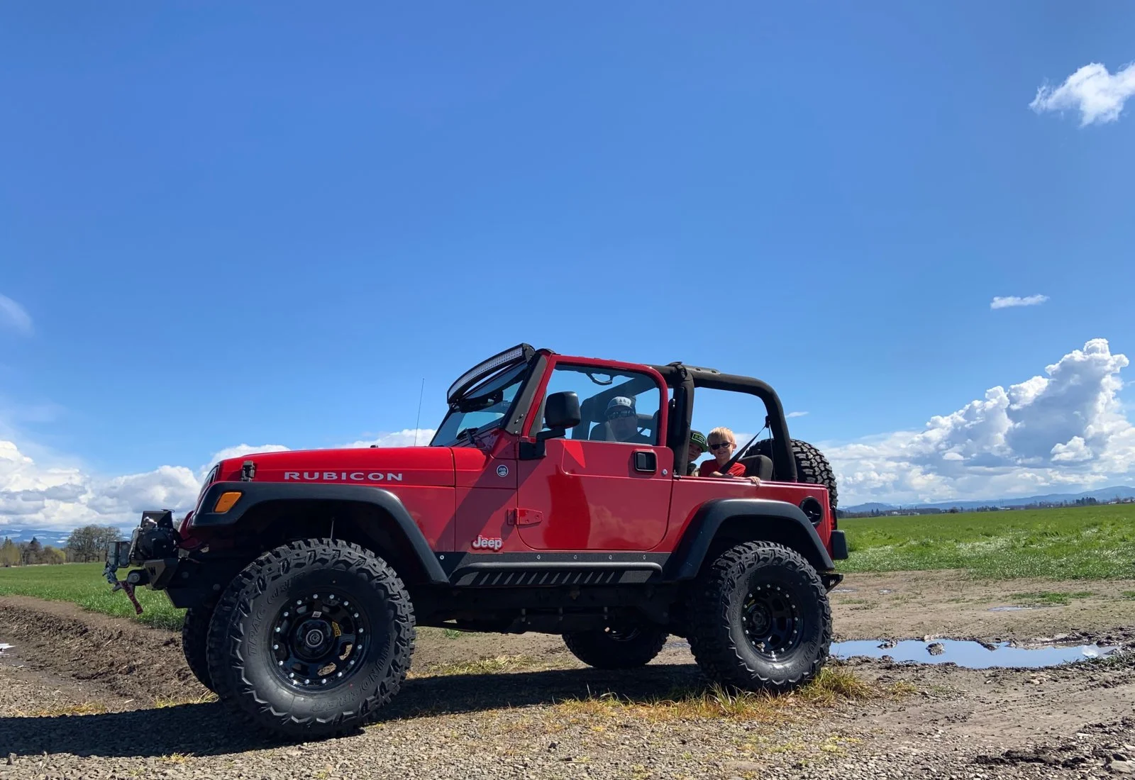

My 2004 Rubicon drives great with a 4" lift. You need to spend the money on a good lift kit. Mine is mostly Curtie stuff.

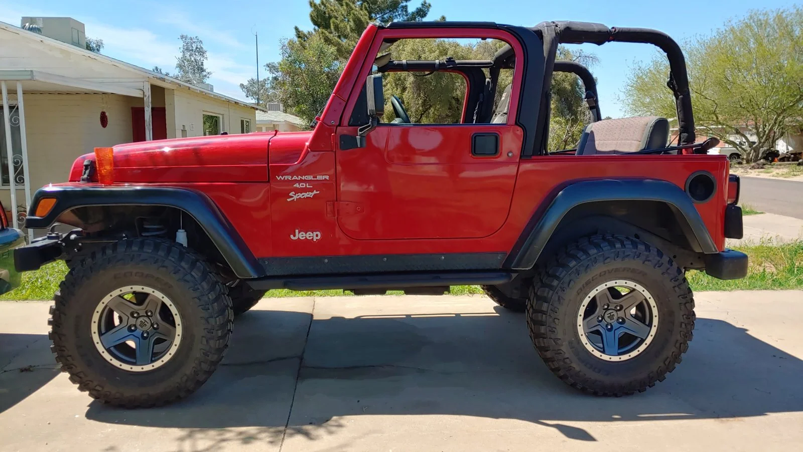

Thanks. It’s getting a 1.25” body lift which I honestly don’t want to do but a tummy tuck forces that hand....I think it sits perfect at a total of 4”.
So in the pic you have a total of 4" suspension lift? ... or you're at a 2.5" lift and planning a 1.5" Body lift to make up the 4"?
