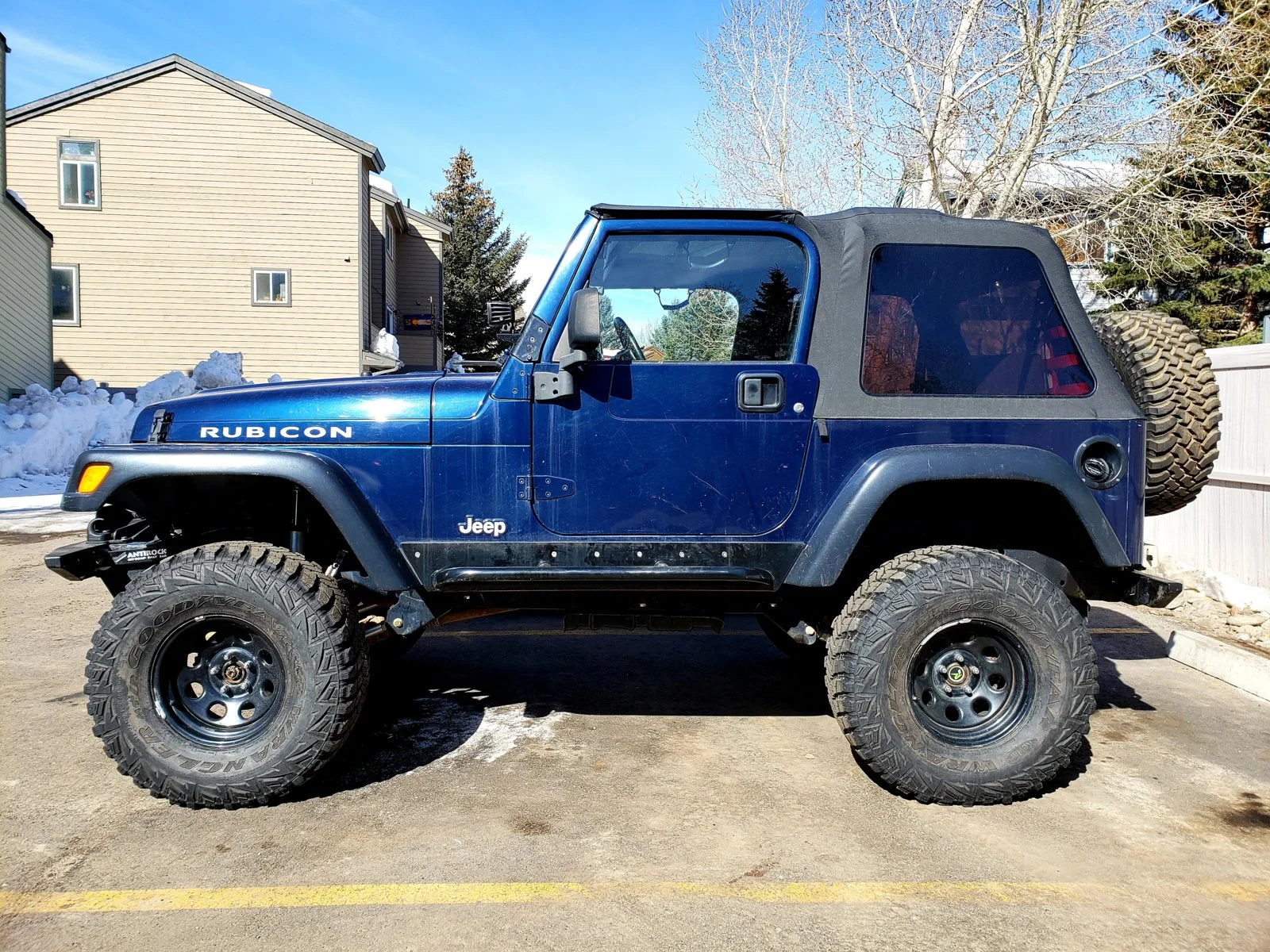

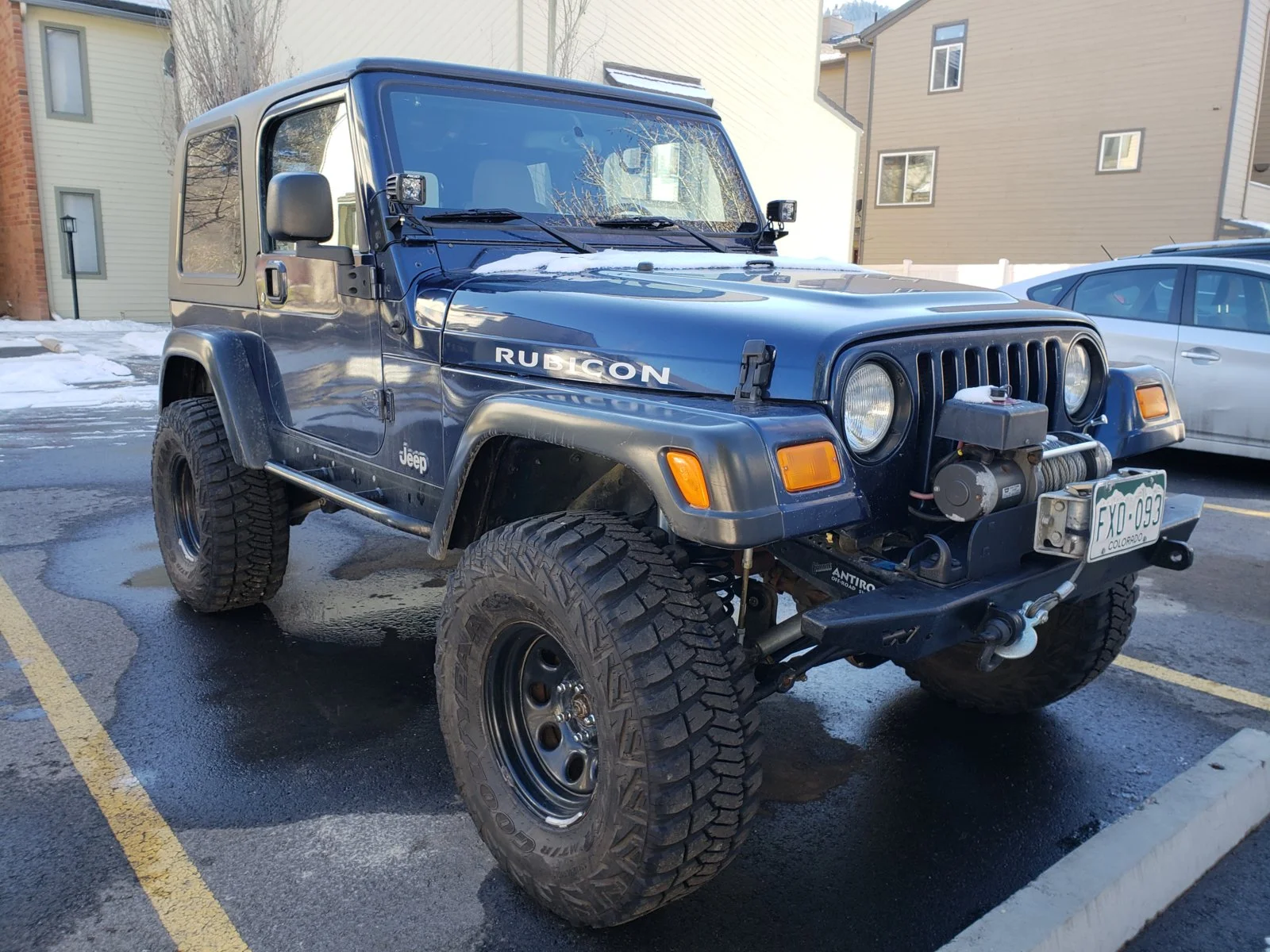

4" lift and 33"s on top and 4"+1.25"BL on 33"s on bottom picture.
Very nice! How's that step on the rocker guard work out for you? I was wondering if it was better to go with a nerf going back to the frame or a set-up like yours.
It’s not much of a step as it’s tall and setup as rocker protection. But my kids use it as a step getting in. I just leg in. If your Off-roading the Jeep, you wont want anything sitting below the body. If your all street, the nerf type steps will be a better step.

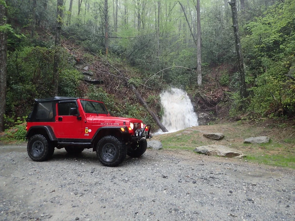

My Jeep had a 4" Skyjacker lift. I still use the springs. I changed the rest to to Bilstein shocks, JKS rear track bar, Currie front trackbar, Currie CorrectLync steering, Currie control arms. I have 33x12.5/r15 BFG AT KO2 tires. Oh yeah, red is the fastest color.
Very Nice. Thanks for the info. My experience is that Cops think Red is the fastest color too! .... Never again! I went from 0 t0 3 tickets in 6 months!

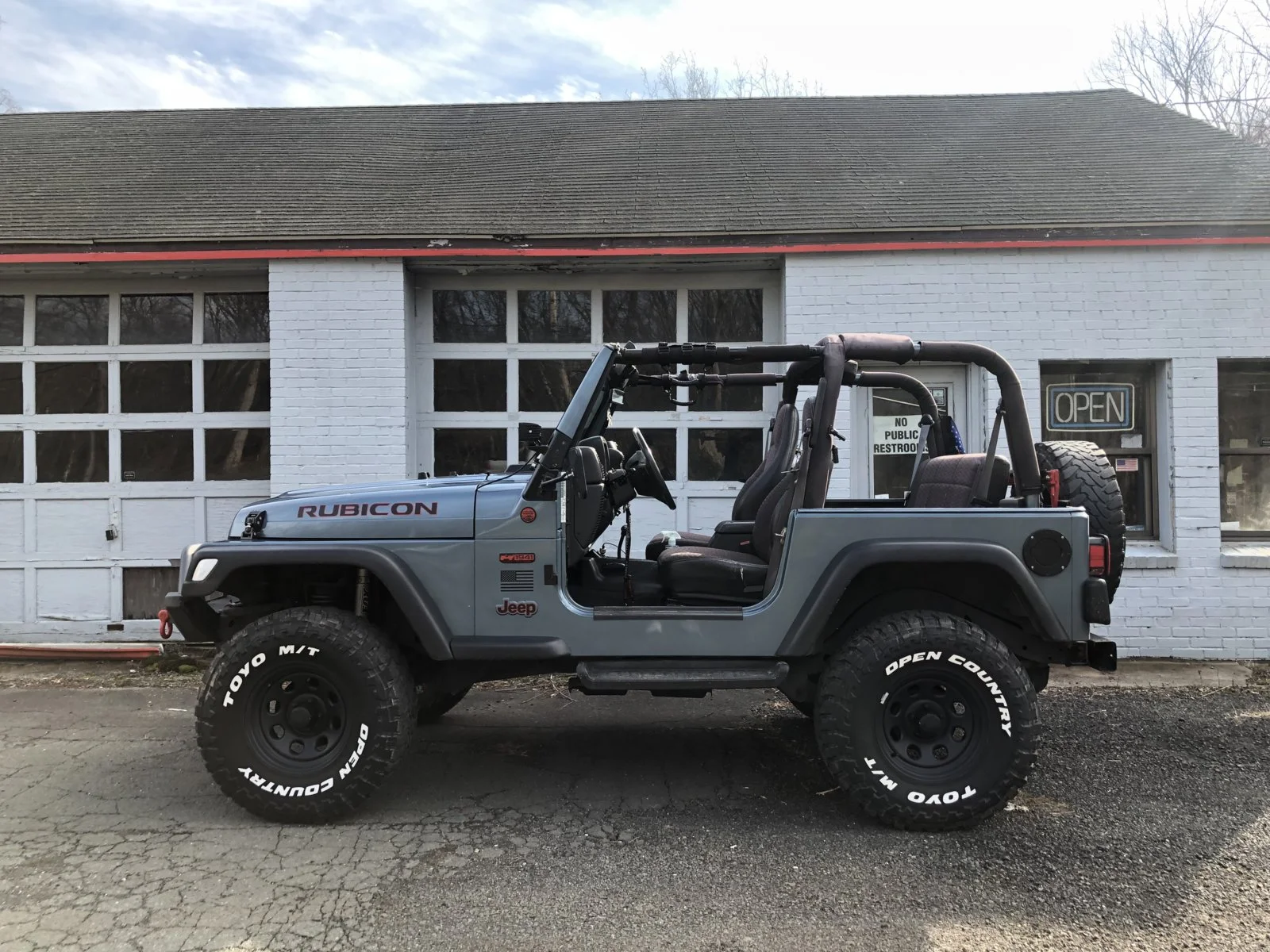

Here's another example, mine with 4" lift on 33s. I bought it with a 4" Rough Country suspension lift and 285/70/17 E rated tires and it rode and drove like a steel wheeled log wagon. Swapped out the RC shocks for some Rancho RS5000x shocks, replaced the 17s with factory Grizzly wheels and mounted 33/10.50/15 c rated tires and a JKS adjustable front track bar and now it rides and drives so much better. Next on my list is a SYA kit and double adjustable rear uppers so I can get rid of the transfer case drop.
Someone above suggested selling the Skyjacker lift and starting over, probably not what you wanted to hear but that is good advice. Installing a bottom shelf lift kit and then having to turn around and start replacing parts to make the handling and driving characteristics tolerable is just a waste of time, effort and more importantly money. Also you will need to factor in a re-gear based on the tire size you go with. IMHO this is an absolute must for both on-road & off-road performance.
