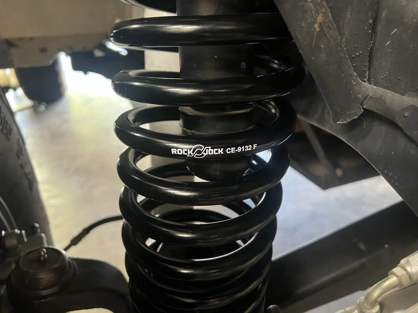

As part of my Savvy Mid Arm install, I purchased RockJock 4" lift springs and bump stops to replace the tired lift components that were previously installed. I noticed the RockJock springs were notably longer than my previous springs but softer in my hand flexing.

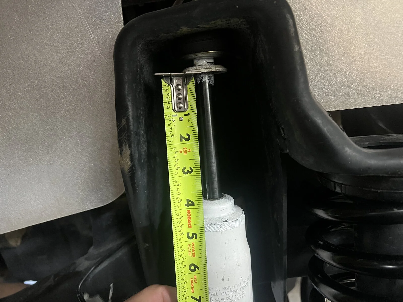

After installing these springs, I was shocked and disappointed at how low my Jeep was sitting. They measure right at the 15.75" loaded length as specified on the website. There is about 1/4" of shock shaft showing when the bump stops make first contact, so that puts my usable up travel at ~3.5". The springs are brand new, so I'm assuming they will settle over the next few weeks and then I'll be sitting even lower.

The problem isn't the springs though, this is just reality when you put an 11" shock in stock mounts. I assume that is a rancho rs55255? When you redo your mounts for the fox you'll put them where they're at half stroke at ride height and you'll have your 5.5".

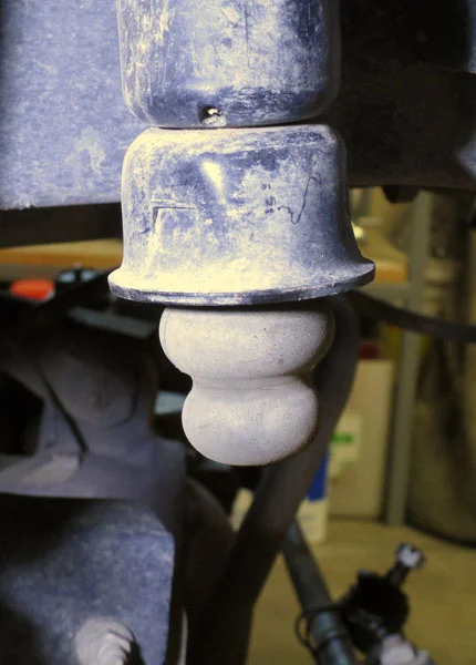

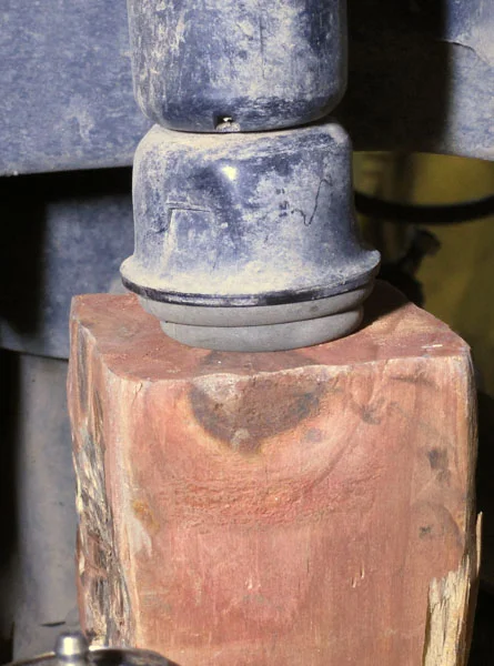

... about 1/4" of shock shaft showing when the bump stops make first contact ...
First contact isn't the best place to measure. Most jounce pads can compress a LOT. This is a static test, and a real bump on the road can easily squeeze tighter:
It's better to measure to the metal-to-metal contact point without the jounce pad (which slows down the axle but doesn't stop it). Otherwise your shocks can take a beating.
