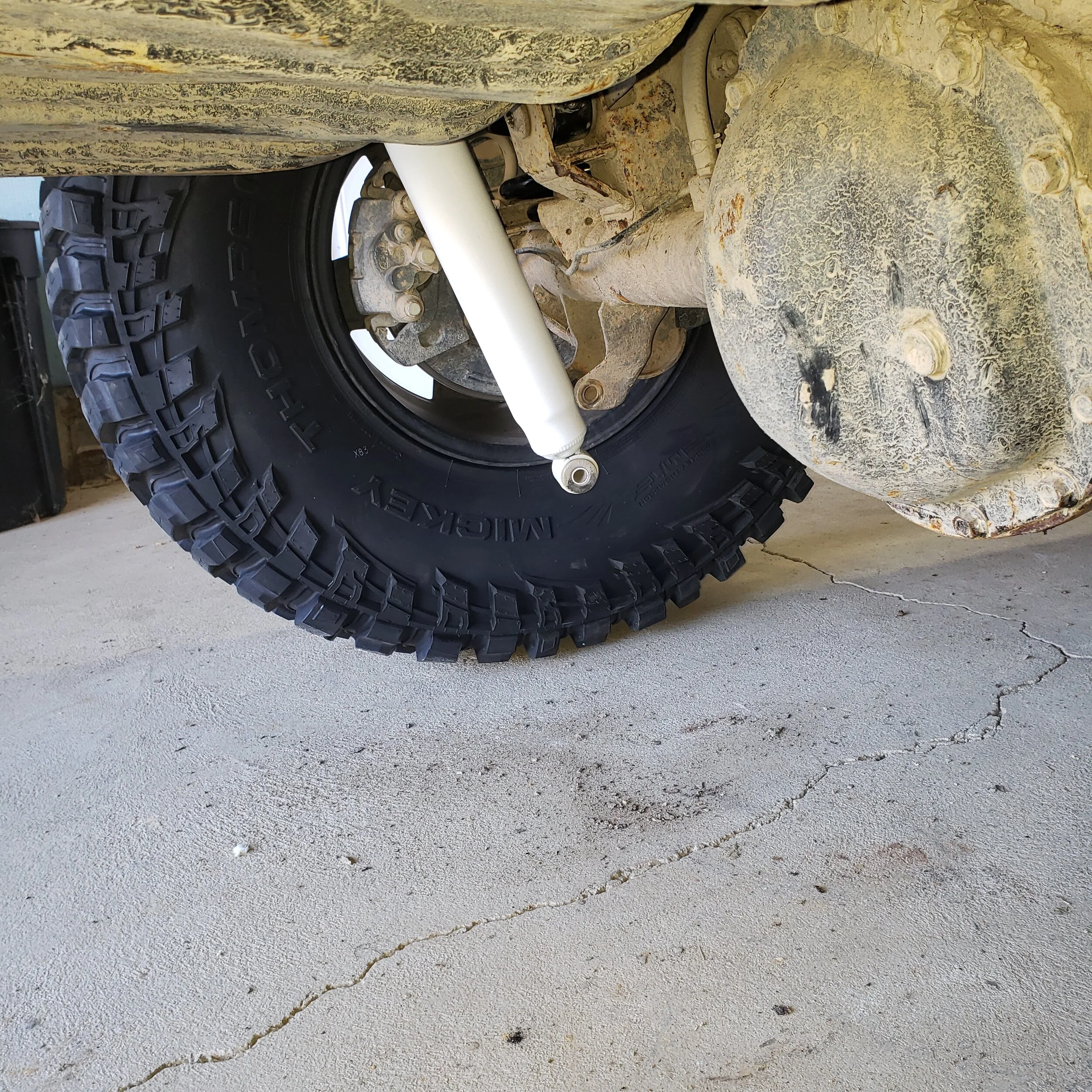

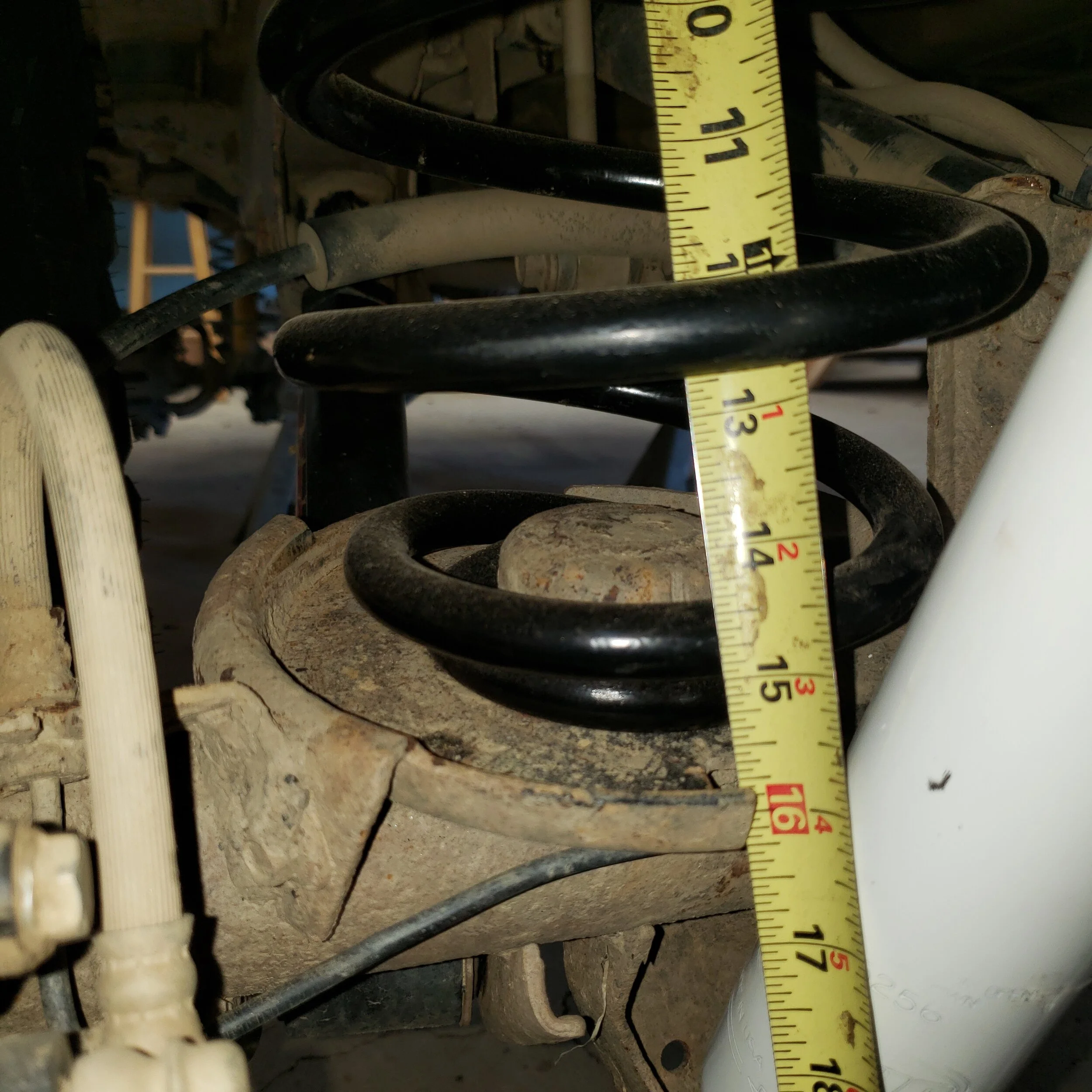

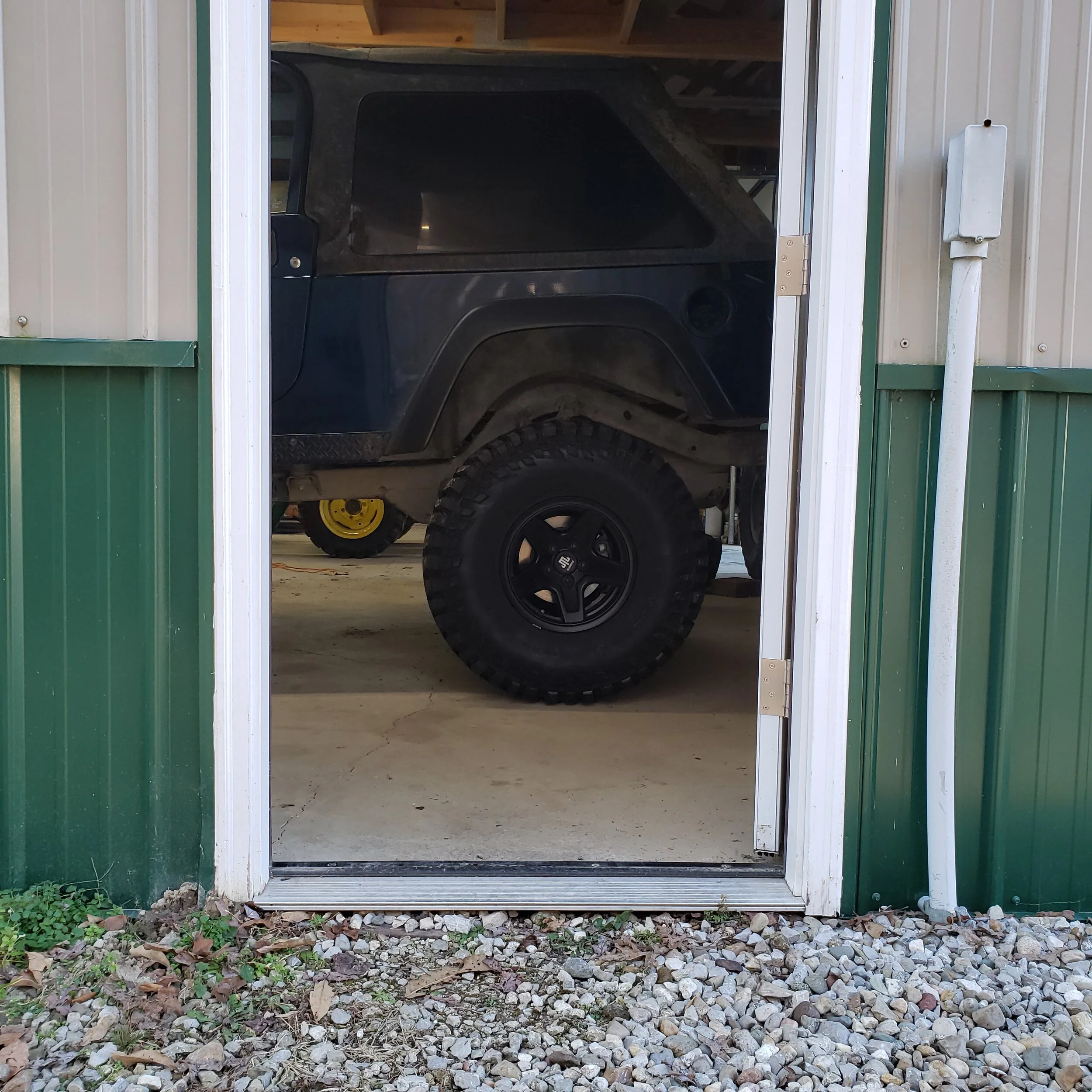

2005 ljr. bought new 35" tires and decided to replace ome 2.5" plus spacers with real 4" springs/shocks. went with ce9131rh3/rs55256 in rear, ce9132fp/rs55255 in front. installed the rears and they seem way too tall. i have at most a quarter inch available downtravel before the shock is extended :) sure hope i've overlooked something stupid, and these will work as i expected. does anyone see something off?

the rear shock in the pic is fully extended at 24.67" (per rancho website, i didn't measure before install)

I have same shocks front and rear and they are close to half extended at ride height at both axles.

First, I can’t tell much from how you measured the spring length because you put the tape measure inside the spring. Measure the outside from top to bottom.
Second, you only installed the rear. Now the nose is down and that allows the rear shocks to extend longer than normal under load. Finish by installing the front.

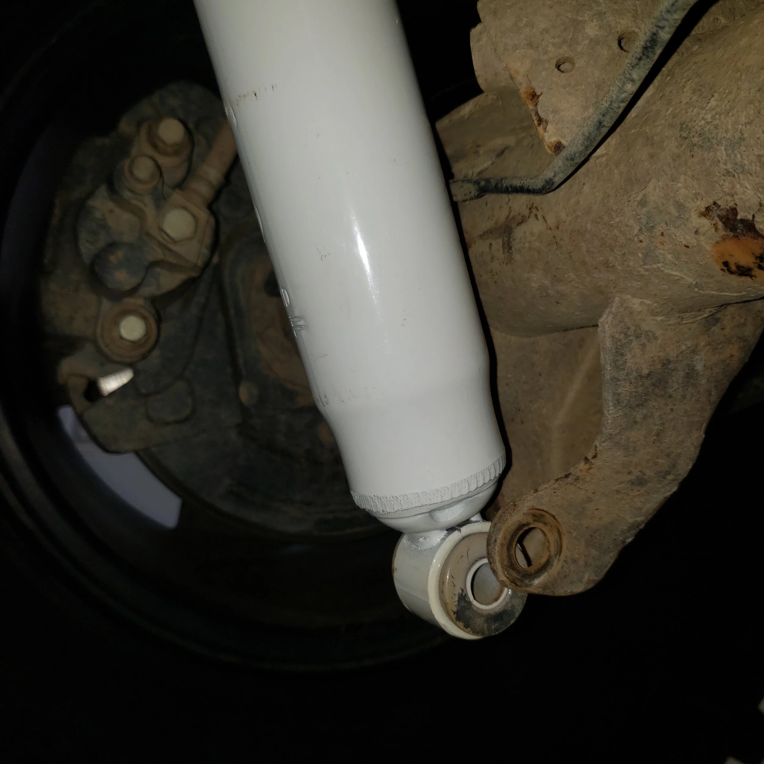

ok guys, maybe i panicked too early. i installed the front tires with the old springs and the extended shock picture shows about 2 inches gained there. i expect the new front springs to give slightly more front height, and the hard top and heavy spare will drop the back a little more.

If you are getting 8" of lift out of those springs you need something else. 2" of downtravel isn't ok.Toss a couple tires in the back if you want to replicate a spare and fuel

Wait...was the front on jack stands when you panicked?
yes but lower than new ride height.
not sure i'm out of the woods yet, so i welcome any experience with these 4" LJ rockjock springs :)
You can't make any judgement about ride height until the entire vehicle is sitting on its own weight on the tires. Put the front springs in and set it back down...then make your measurements.
