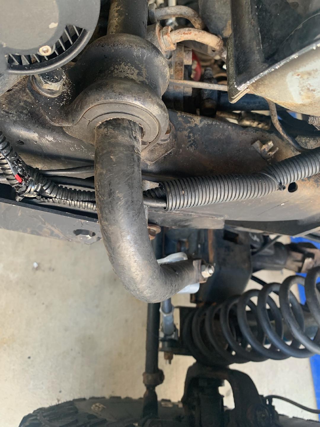

I am replacing my sway bar and disconnectors that I bent pretty badly during my last outing. Replacing the whole setup with a Rock Jock by John Currie. This Jeep is primarily for off-roading. I know that the highway performance that I used to get with the sway bar connected will be sacrificed.

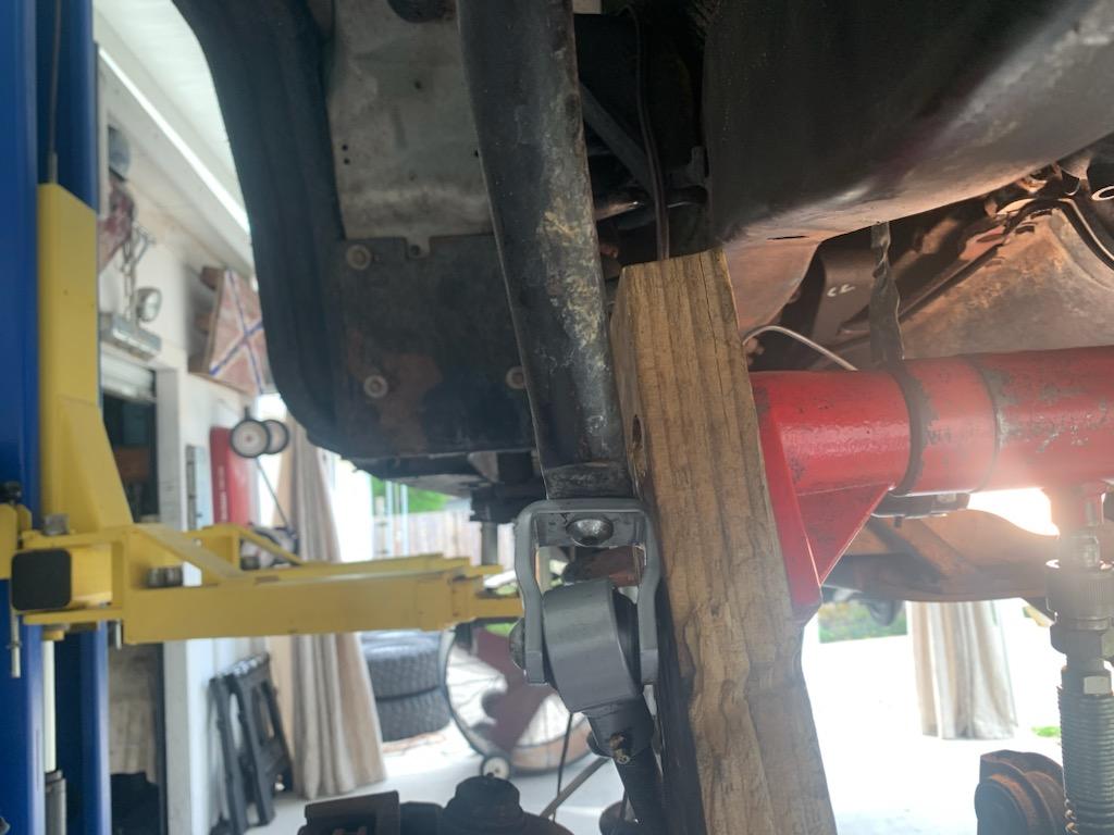

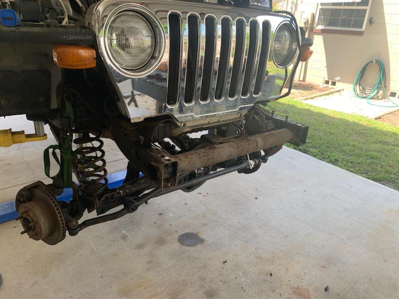

My mechanic with way more skills and equipment is doing some cutting and grinding on the custom bumper assembly to make room for the new upgrade.
